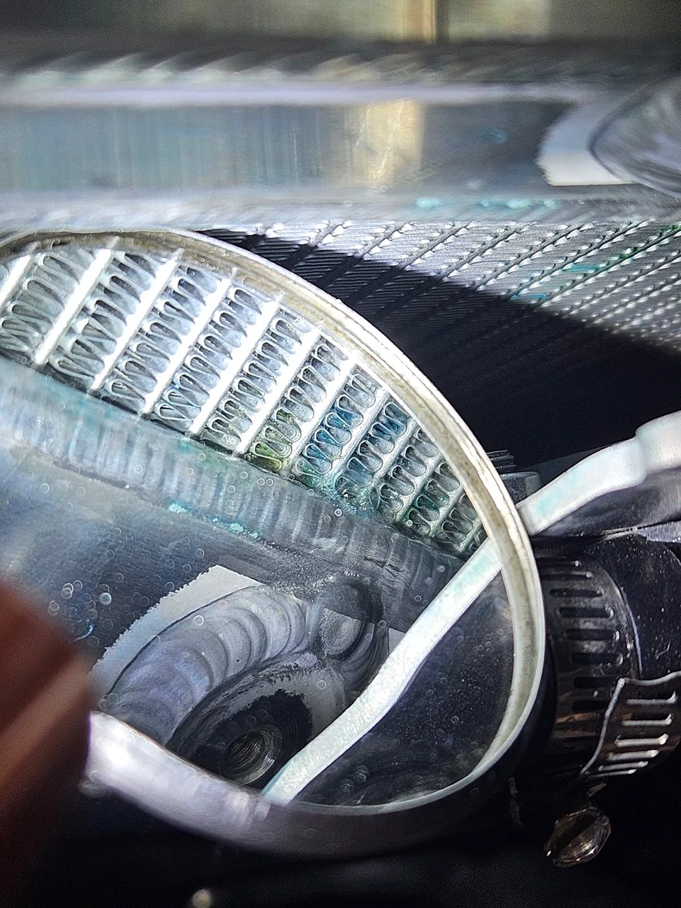

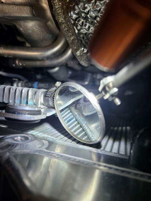

When I installed the PWR track spec radiator last year I immediately had a high pressure, high heat coolant leak. It turned out to be a hose. Replacing all the hoses resolved it.
Today with the PWR WOT radiator the same problem has occurred again. I’m getting a coolant spray in the engine compartment but only on track and under full load. It’s not enough to affect temperatures and coolant levels are fine. I’ll have to replace all hoses again. I should have replaced them when swapping radiators but was in a hurry and forgot to order in time.

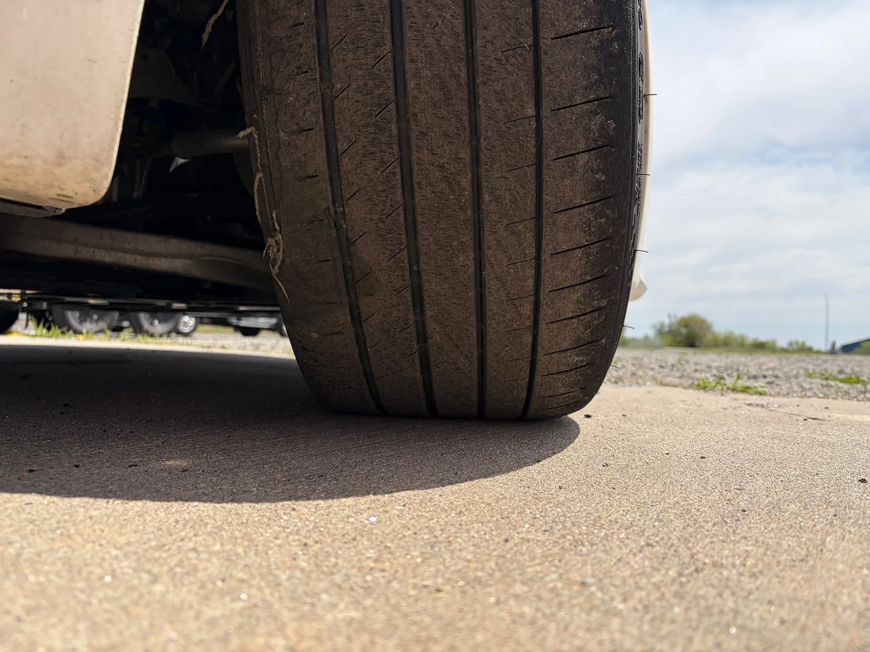

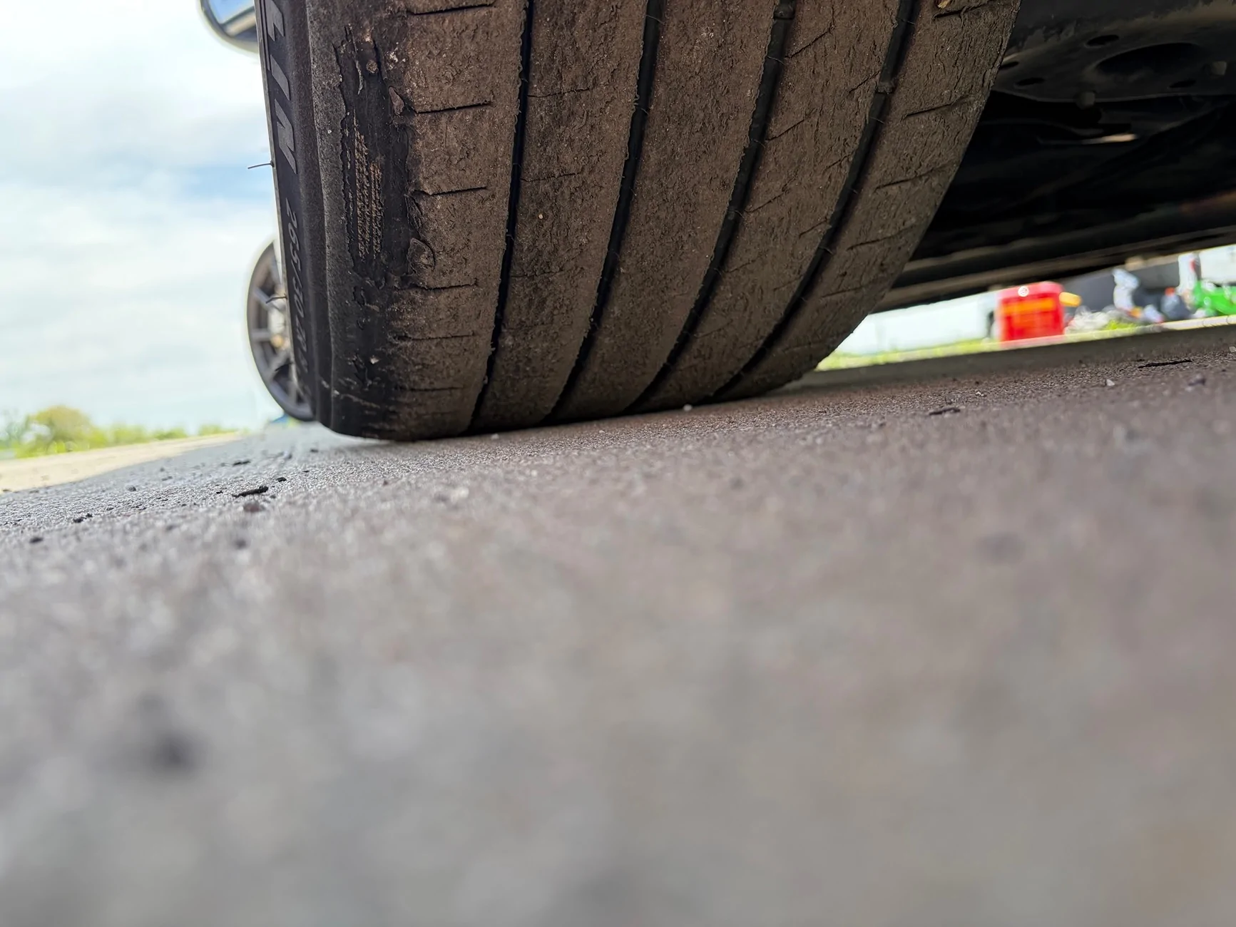

Question for those who track the FL5 regularly: See photos below for the tire wear I’m seeing with PS4S tires. I have around -3.2 camber in the front and 0 toe. Rear is at -1.8.
I am running 36-38 psi hot on the front to avoid rolling over sidewalls and about 34 hot on the rear.
My regular track is mostly right turns so it’s hard on outside driver and inside passenger edges of tires.
I am wearing out the outside driver front and inside passenger front with all the hard right hand turns. Rotating front to rear slows this down but I’ve not been rotating often enough side to side. Other than rotating more often from side to side, rather than just front to rear, what other setup adjustments can I do to avoid this?
Driver side first (see tread on outside), passenger side second (see tread on inside).

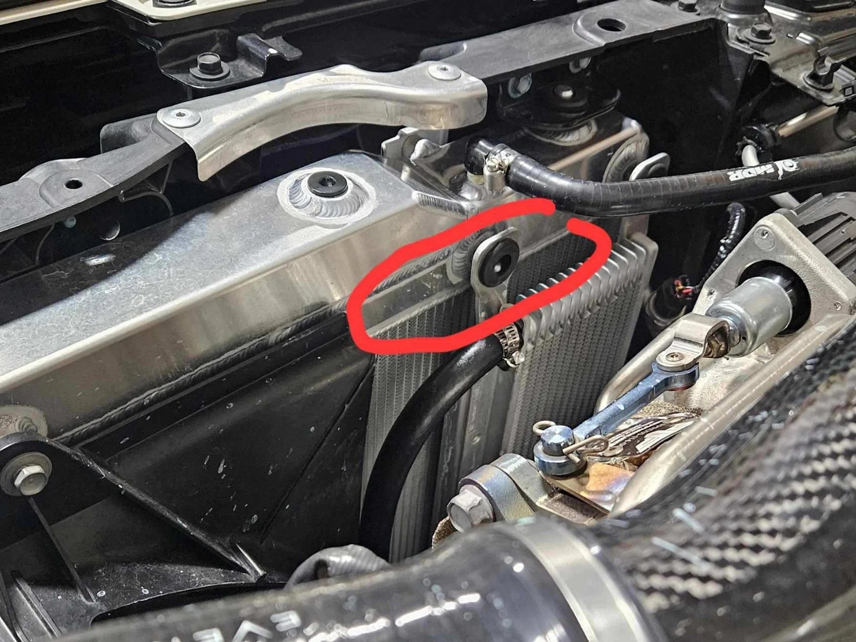

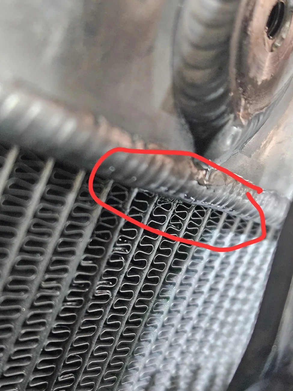

Update on the coolant leak. It’s not a hose issue. Under pressure it is showing a leak in the core (or possibly top tank weld) behind the transmission cooler mounting bracket. This is on the backside of the radiator where there is nothing to come into contact with the surface. Bubbles can be seen in the attached photo with it under pressure.
Unfortunately PWR is requiring I send it back to them at my cost before they’ll either repair it or send a replacement. I have just over 1,000 miles (including three track days) with this radiator. Huge disappointment and will cost me a lot of money in shipping, down time, and cost to have the radiator swapped in and out. I’ll have to swap in my single pass PWR while I wait (weeks?) for PWR to decide what to do. That swap will cost me more money as well.

06/14/26 Update
My PWR WOT triple pass radiator and transmission cooler were shipped back to PWR (at my expense) due to what appears to be a leaking core.
PWR track spec radiator re-installed in the car (again at my expense). RV6 rear sway bar and billet end links were installed. I ended up installing another set of PS4S because the dealer price can’t be beat. They leave a lot to be desired but they’re durable and it’s fun to work with their limitations.

PWR WOT Triple Pass Radiator
I shipped the radiator back to PWR and they confirmed it was a failed core. Jason at WOT has been great throughout the situation, working with me and PWR to set up the return. He also refunded me the cost of shipping back to PWR.
Once the failed radiator was confirmed, Jason and PWR worked together to send me a brand new unit, which I have not yet installed. PWR will send Jason a replacement unit for his stock.
All in I'm not happy the radiator failed and that I had to have downtime and labor cost to swap it out but things happen and I am pleased with both WOT and PWR quickly getting me a new unit.
