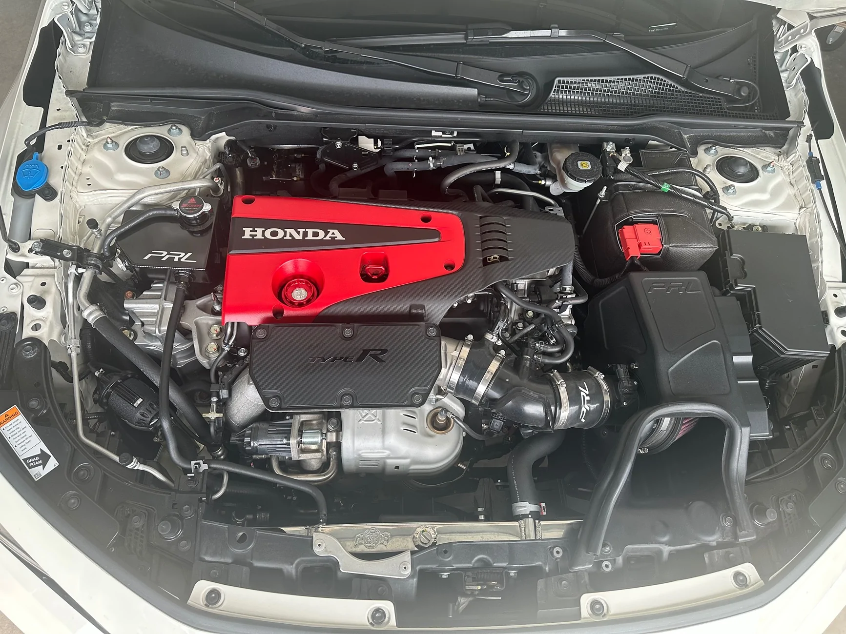

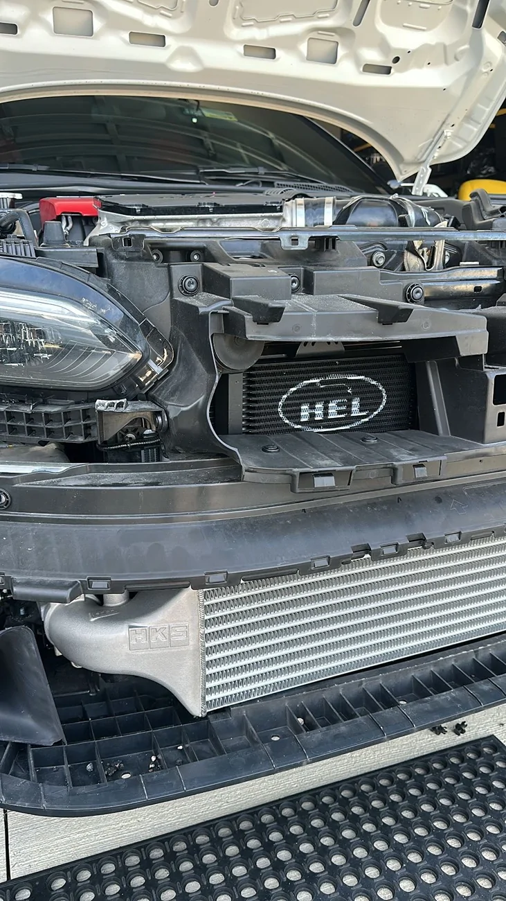

That’s exactly what I was wanting to hear. I thought the CTR ADS might be to bouncy. I will definitely do a sway bar now!
I’ve already done a bunch of cooling.
-CSF radiator
-HEL oil cooler
-WOT cooling plate
-HKS tube and fin intercooler
-PRL intake
-PRL coolant tank
-Remove hood rain guard
-TSP downpipe
-PTP hardlagged downpipe blanket
I don’t run into cooling issues. And am about to do a full brake overhaul (shims, SRF fluid, stainless steel lines, racing brake pads)
