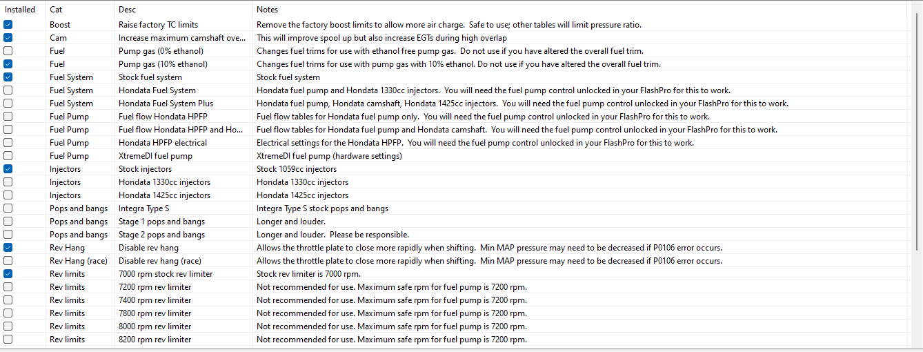

Ok everything looks good, switch rev hang to race, and take off the launch control and enable pops. Make sure to save the map and then upload. If it still gives you trouble send me a DM and I will send you a base map.
abracadaniel_
abracadaniel_
Daniel
Feb 18, 2019
85
Palmdale

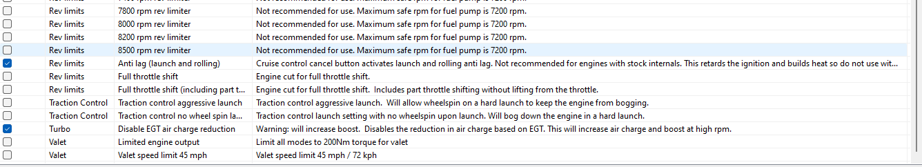

By launch control, do you mean the anti lag launch?
I am not seeing something that says launch control
Jester04
1,331
1,481
Yeah sorry the anti lag. Was on a call and messed that up.
If the problem persists just DM and I will get you taken care of.
