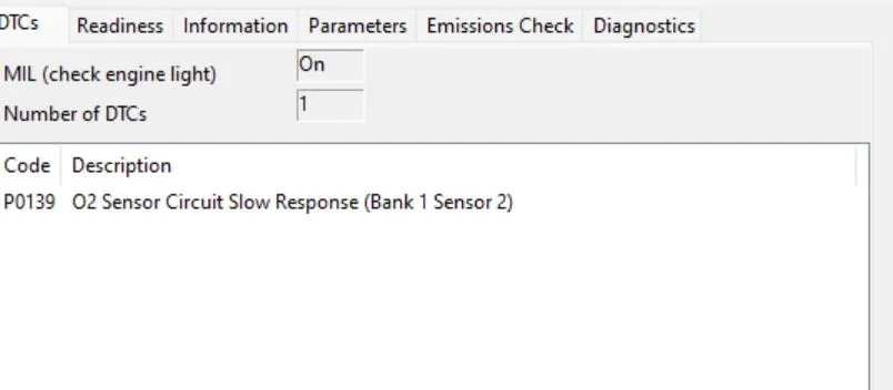

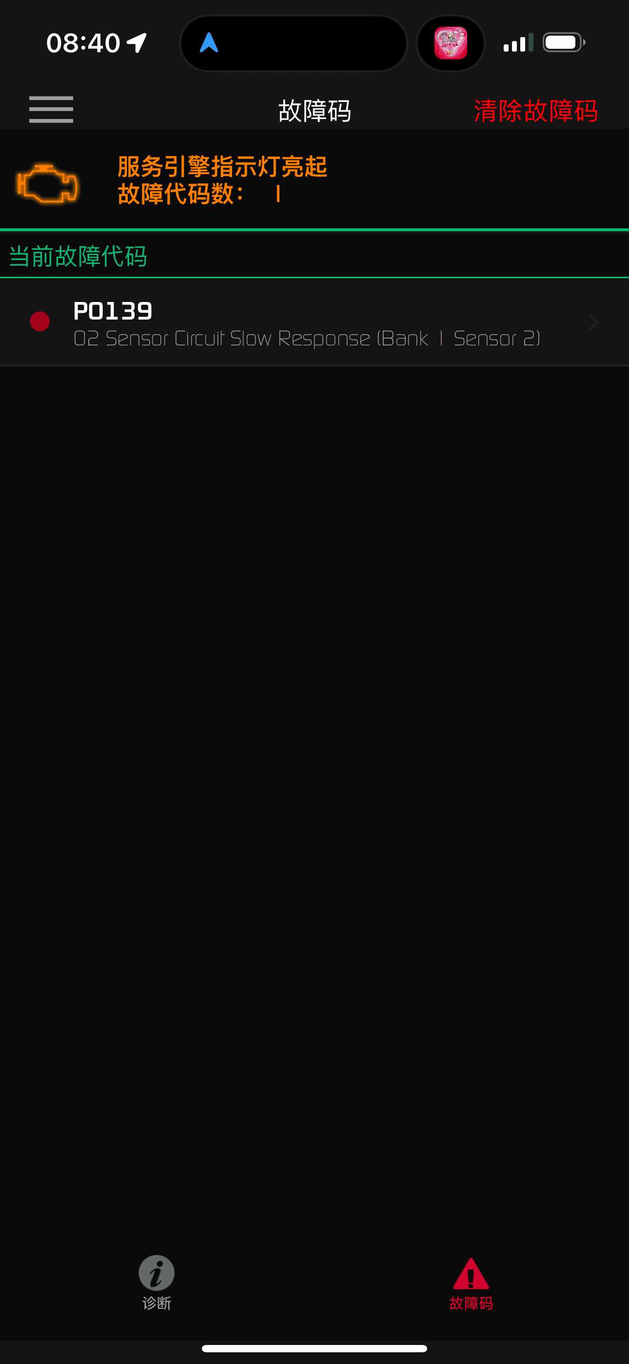

But yes, as I opened up Flash pro, I'm seeing multiple P0139 sensor options...no idea why he said there's only primary??? I literally see the code to disable that I keep getting lol...maybe there is some miscommunication on my part to the tuner. (code I get attached)
This is what he said:
Hondata doesnt have that code listed to be disabled. For primary, yes. But not secondary.
