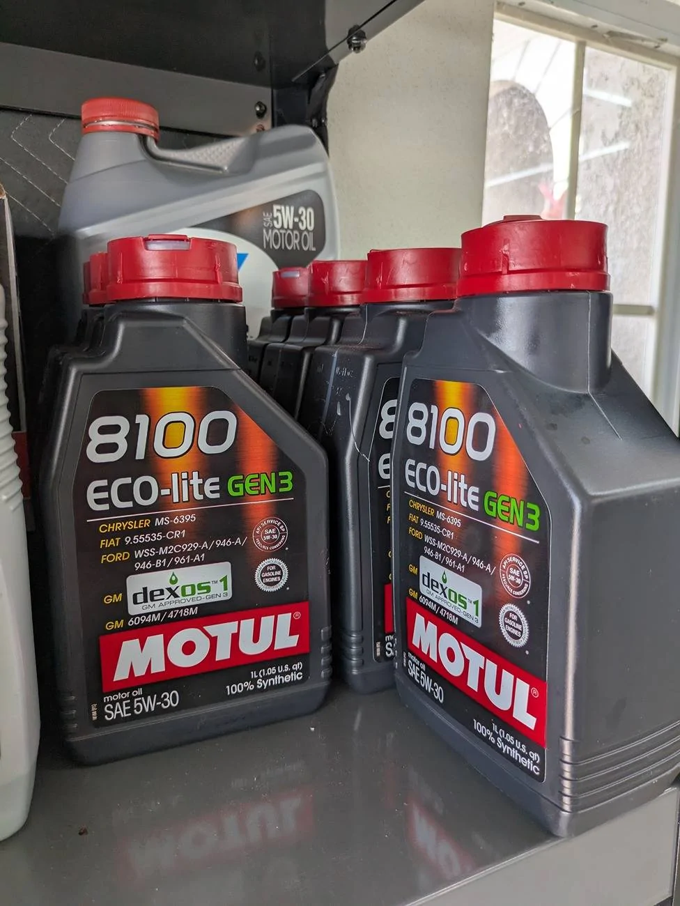

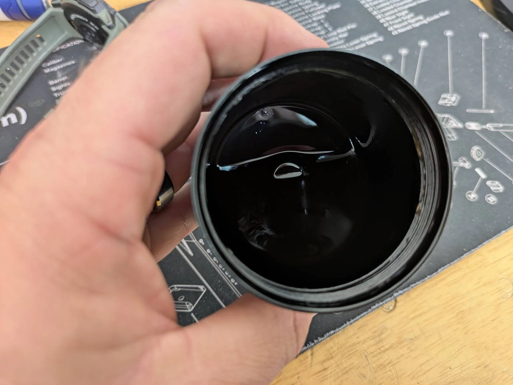

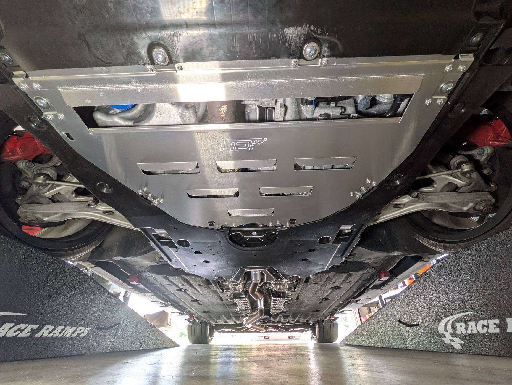

Fresh oil change and got around to installing the WOT cooling plate, which looks and fits awesome! My Mishimoto catch can putting in work. Only around 2k miles on the oil. Getting real hot here in FL so wanted to change over to 5w30.
Btw love that aluminum cover and the cooling fins .

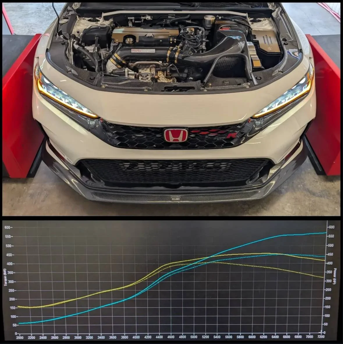

A few days ago, I finally made a trip up to Carlisle PA, and spun the DynaPack with Drob at IMW for a Custom tune. Despite high humidity and temperatures, we were able to hit some nice numbers! higher than I was initially expecting.
It was a very cool experience, but at the same time, it was nerve-racking for me since I installed every single modification myself. If something were to go wrong (e.g. boost leaks, fuel leaks, mechanical issues), I would have no one but myself to blame ? Yes, I did my due diligence and prepped the car before hand (new spark plugs, fresh oil/coolant, double check hose clamps etc.). Thankfully, Drob didn’t see or experience any irregularities. I’m by no means a professional mechanic, just your typical DIYer, but it’s definitely a huge satisfying feeling knowing that you installed everything correctly and that the car runs smoothly pushing this kinda power.
Stock Internal K20C1
450 HP / 406 TQ on 93 octane â›˝
571 HP / 454 TQ on E45 blend ?
Seems a bit low for the Rv6. Could have made the same power with kuro+ and be more responsive.
Did DRob stop due to wanting to be conservative or you just didn't want to push it?

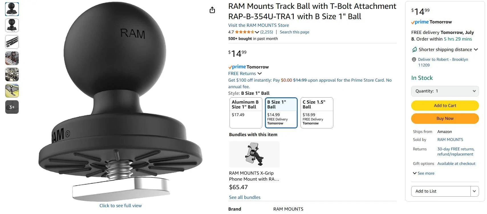

I wanted a real cellphone mount so I ripped my dash off and installed a RAM cellphone mount. Here's a step by step if anybody wants to do the same. Please excuse the dust, it's my daily for my daily HAHAHA :) The RAM Mount parts were bought off Amazon.

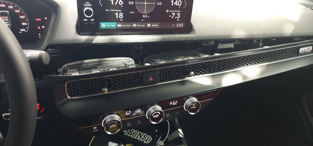

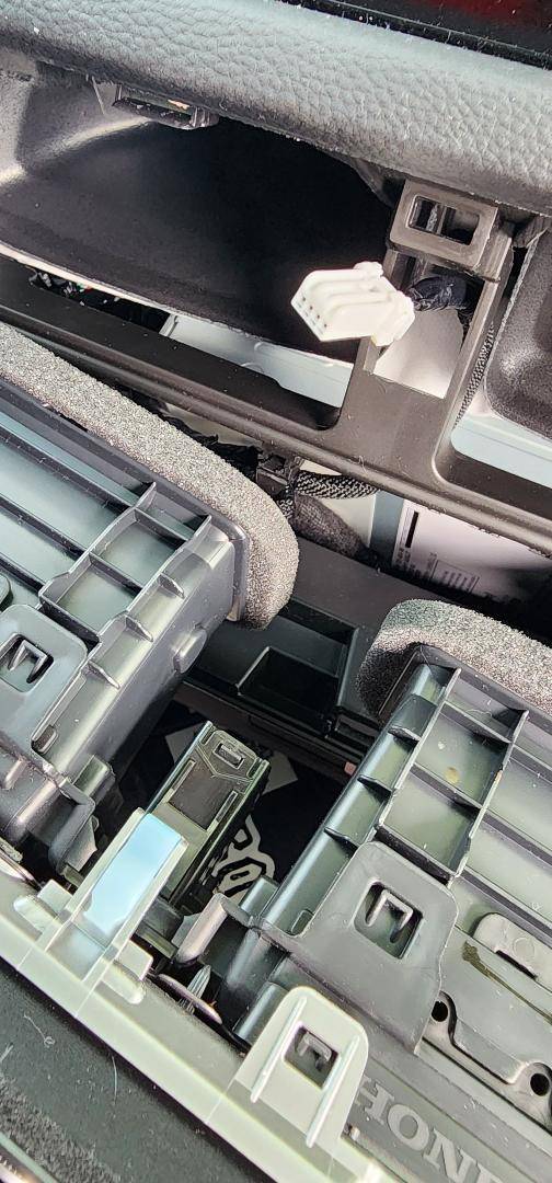

1. Go around the dash with a slim plastic pry tool to pop out the dash console. I left the push button plugged in because I didn't need to remove the dash off completely. The right side of the dash was left on because I don't have 3 hands :) , plus it makes it easier to pop the dash back in because of the reference points.
11th Gen Honda Civic What did you do to your FL5 today? sdf
2. Disconnect the hazard button wire.
11th Gen Honda Civic What did you do to your FL5 today? ewfd

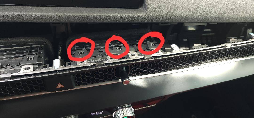

3. Gently pry up on the vent mount clips, there's clips on the bottom of the vent too.
11th Gen Honda Civic What did you do to your FL5 today? 6435tr

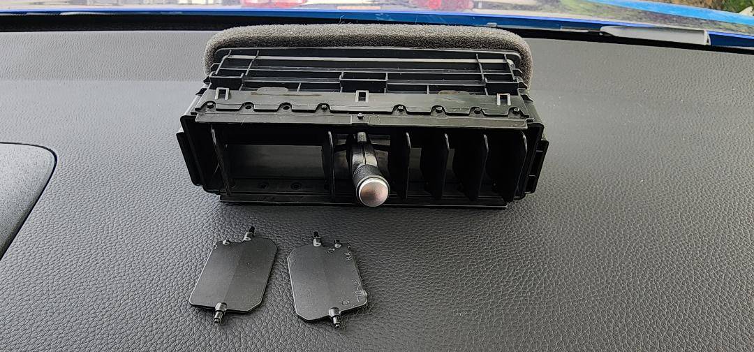

4. Pop off the vent and remove two vent blades to allow the flat RAM track ball T-Bolt to seat properly. If you don't remove the blades, you will not be able to control which way to direct the air blow, it'll also obstruct the T-Bolt from fitting, preventing the entire dash to go back properly... I tried so that you wouldn't have to hahaha.

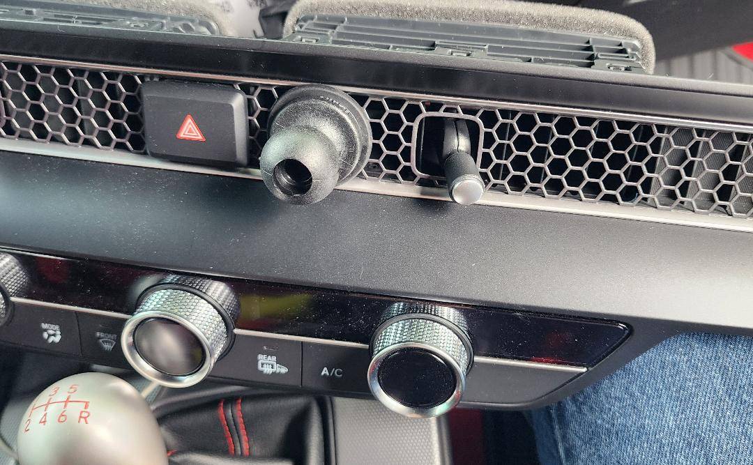

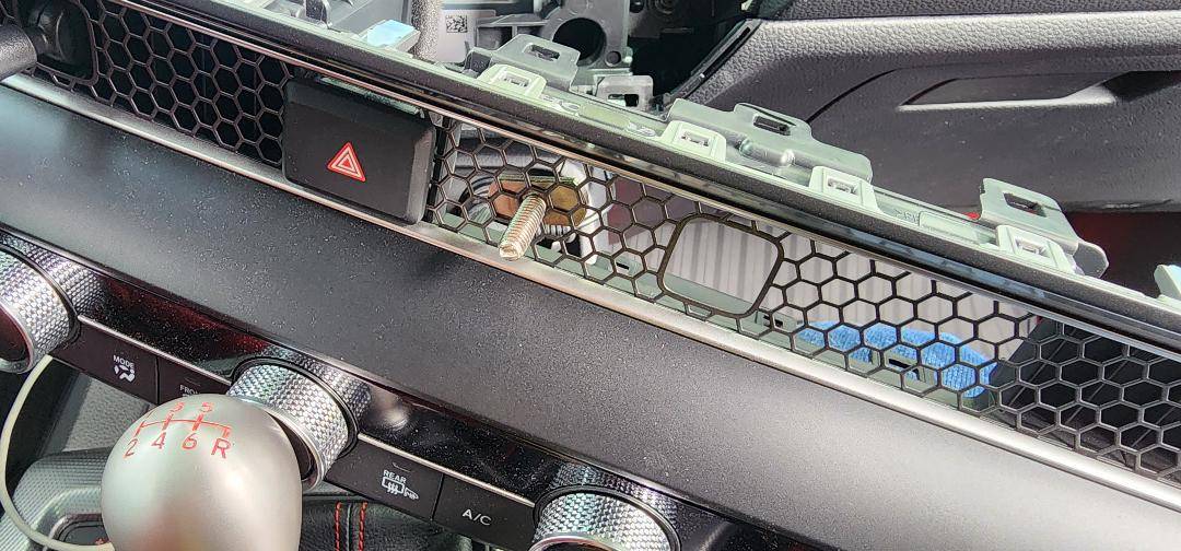

5. Insert RAM T-Bolt screw through the honeycomb.
11th Gen Honda Civic What did you do to your FL5 today? eswgf
6. Screw on the T-Bolt track ball finger tight to prevent the T-Bolt screw from falling into the vent. Insert the vent back from the bottom first then top to snap it back into the clips.

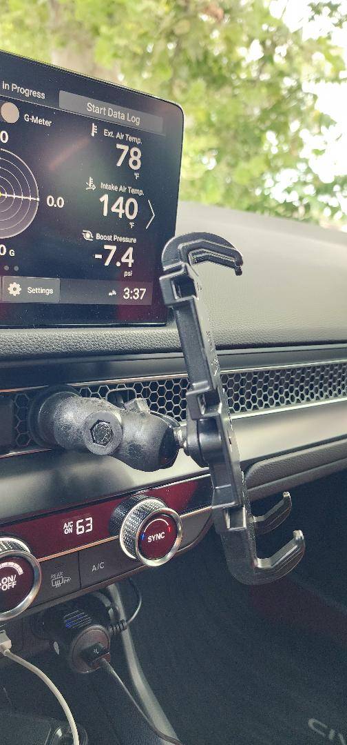

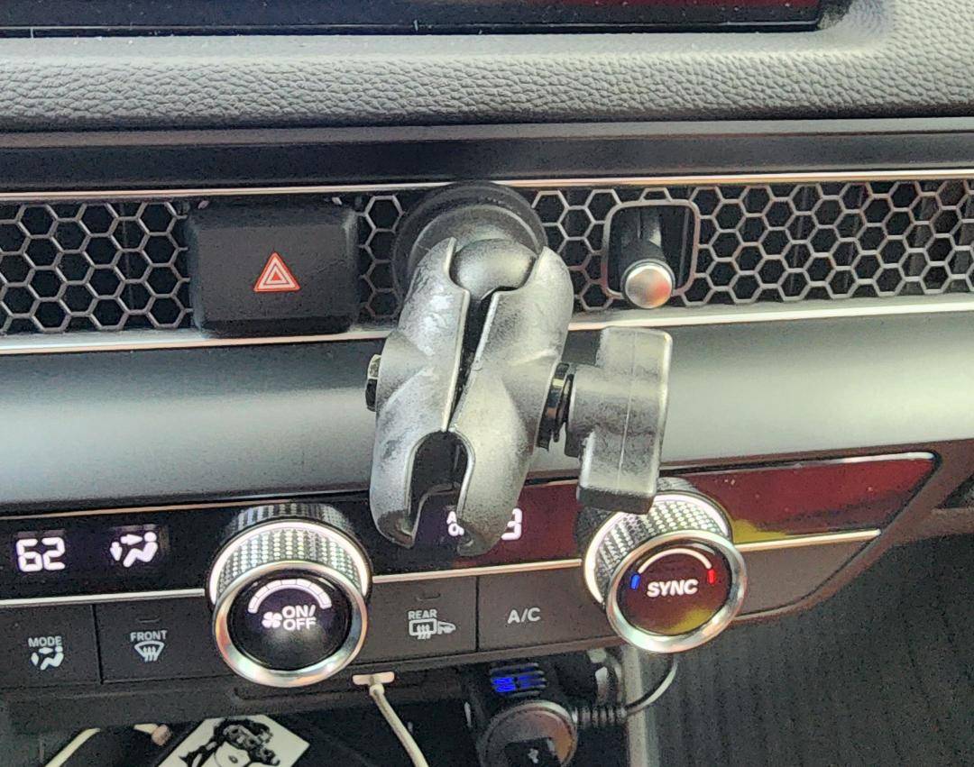

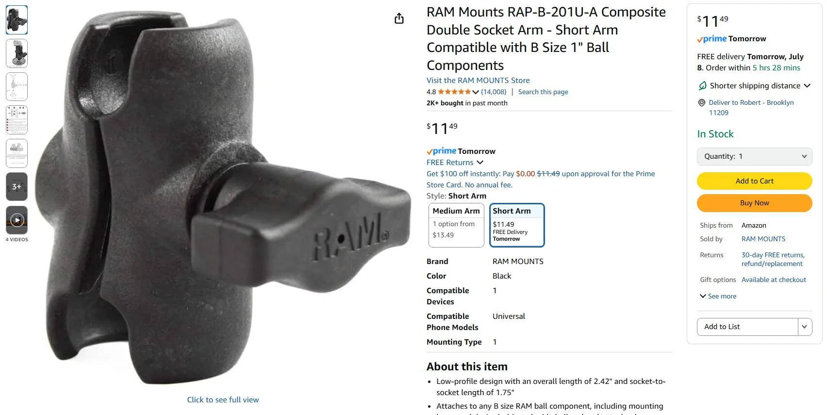

7. Once finger tightened, put the dash back and mount the RAM short double socket arm.
11th Gen Honda Civic What did you do to your FL5 today? q3ratwf
11th Gen Honda Civic What did you do to your FL5 today? scrnli_11ORG84TpOFf7E

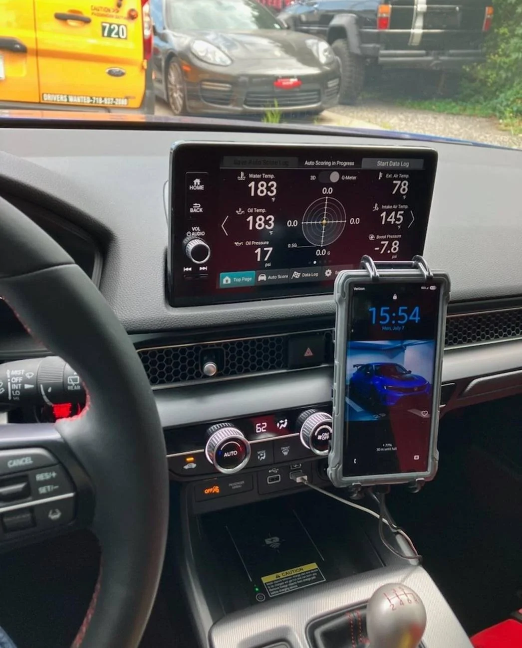

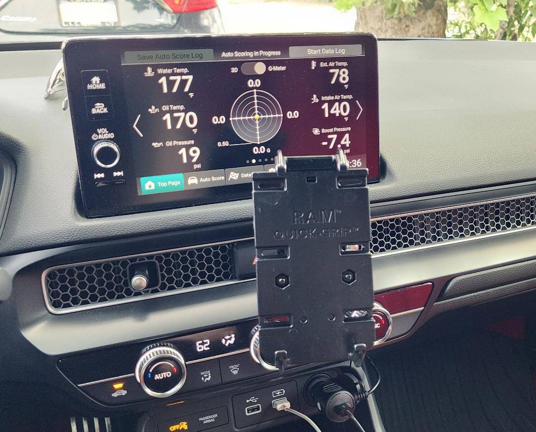

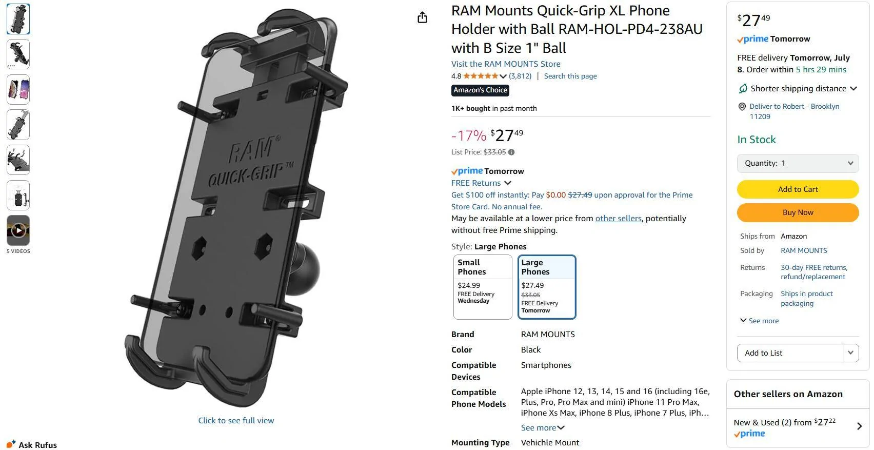

8. Double check the dash fitment to make sure that its seated properly. After inspecting the dash panel, mount the RAM Quick Grip cellphone holder. Please don't forget to screw the trackball onto the T-Bolt securely. I screwed it on really tight and nothing cracked luckily. I have an older Samsung and went with the XL size for the RAM Quick Grip cellphone holder. The top of the cellphone grip slides up to put your phone into it. I attached a video of it below. It has great pressure to grip onto your phone especially if you have a rubber cellphone case.
11th Gen Honda Civic What did you do to your FL5 today? ewsgtdf
11th Gen Honda Civic What did you do to your FL5 today? rqfa
11th Gen Honda Civic What did you do to your FL5 today? scrnli_zU8offilkODFUG
9. Sit back and angle the mount to your liking :)
11th Gen Honda Civic What did you do to your FL5 today? thumbnail
Easy install, hardest part was removing the dash.
Feel free to message me with any questions or concerns.
Now go have fun in your "SHITBOX" !!! :)

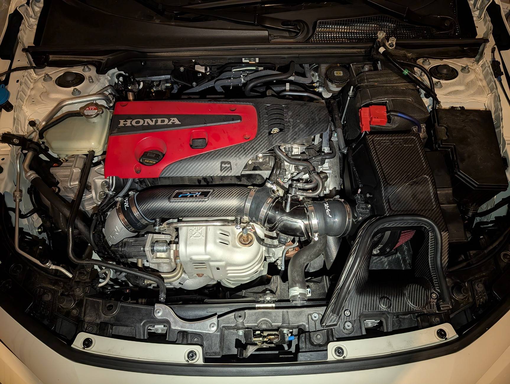

Installed my PRL carbon HVI and the carbon turbo inlet pipe kit.
Took her for a test drive and opened her up a little after the system relearned and oh my she sounds better when letting off of the turbo. Downpipe from PRL will be next then Turbo then fuel system.

According to DRob, over 600whp on the RV6 will potentially cause catastrophic failure. So he stops it around the 570whp mark. My car has almost the same build and he did the same thing for me.

Any plans to get the tsp coupler for the inlet and HVI?
I only have the HVI installed but the coupler cleans things up nice

Didn't know I needed it. Surprised it wasn't offered as an option?

You don't need it but it just makes it one whole piece instead of coupler into coupler. Less points of failure and looks a bit cleaner
