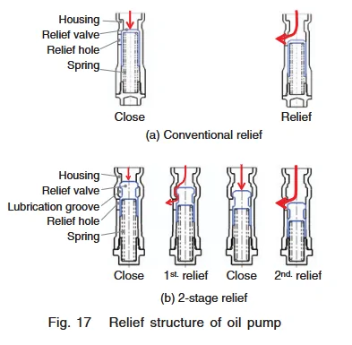

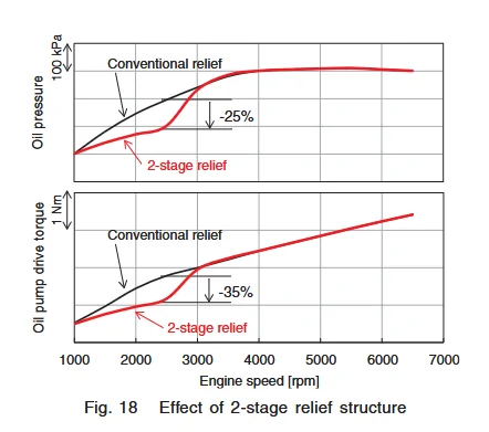

This is from the SAE paper for the J35, but I assume its the same pump style.
Next, the 2-stage relief structure of the oil pump is described. This structure is intended to reduce the oil pump drive torque by optimizing the hydraulic pressure characteristics at slow and mid-engine speed. The conventional relief structure (1-stage relief) has a structure where the relief valve strokes and oil is discharged from a relief hole in the housing when hydraulic pressure of the set valve pressure or more is applied [Fig. 17(a)]. In contrast, the 2-stage relief structure enables 2-stage relief by adding a lubrication groove in the upper part of the relief valve and the housing upstream from the relief hole. Two-stage relief operates as follows. First, the relief valve begins its stroke when hydraulic pressure of the set valve pressure or more is applied. Oil passes through the lubrication groove formed by the valve and housing upstream from the relief hole, and is discharged from the relief hole. As the hydraulic pressure rises and the valve stroke progresses, the lubrication groove is blocked and the 1st-stage relief stops. When the hydraulic pressure rises further to the 2nd-stage valve pressure or more, oil is discharged from the 2nd-stage relief hole [Fig. 17(b)]. Figure 18 shows the hydraulic pressure characteristics at slow and mid-engine speed and the effect due to adoption of the 2-stage relief oil pump relief structure. As a result of optimizing the hydraulic pressure characteristics, hydraulic pressure reduction effects of 25% and oil pump drive torque reduction effects of 35% could be obtained. Other friction reduction technology included thorough measures to reduce mechanical friction such as application of a molybdenum pattern coat to the piston skirts, reduction of piston ring tension, use of low-torque oil seals and low- viscosity engine oil, and reduction of auxiliary belt tension. These measures achieved BSFC enhancement effects of 4% at 1500 rpm.
