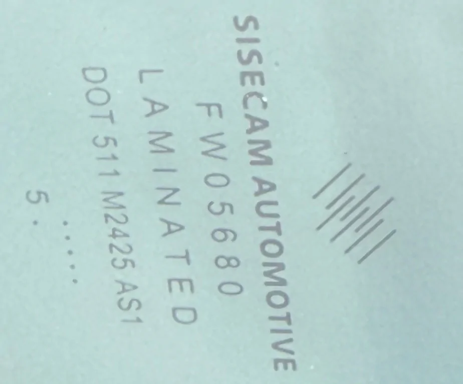

Update as the new windshield was installed today. Took a long time to sort through the options and align with the shop on best path forward (given my circumstances). I didn't go through insurance and wanted something else than the same exact spec as the stock windshield is too brittle. Didn't want to spend $3K+ and have the same issue 3 months down the road. Type R is my daily so having more resistant glass is a plus.
The stock glass is made by Fuyao and I wanted to get Pilkington replacement. Was told Pilkington is a good choice. The installer said Pilkington in their database was also supplied by Fuyao brand so I suppose Pilkington doesn't manufacture their own glass for Civic. Instead, I opted for SCM glass (Sisecam Automotive; Turkey); NAGS FW05681 GTY. Installed under 2 hours with full ADAS calibration. The installer mentioned the calibration took longer than normal Civic but it was done well and so far everything works as expected. All-in, ~$850 in the Bay Area, which is a steal.
Did I make the right choice? I don't know... time will tell.

Beautiful. Can you read the label engraving, does it say anything like acoustic or ir on it?
Edit: specs say Windshield (Solar)(Acoustic Infrared Interlayer).
Have you noticed any lower noise on the highway?
