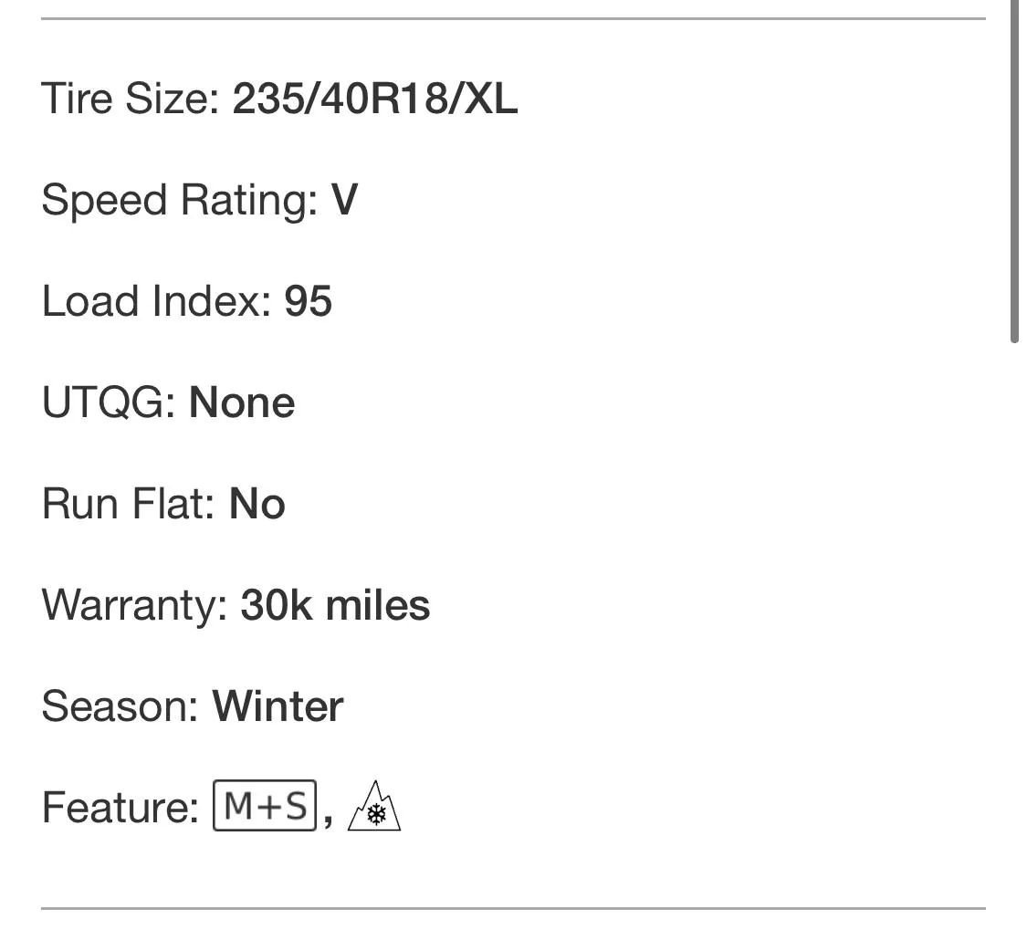

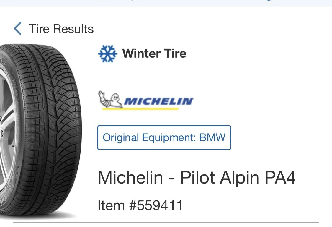

I want to run this tire for my winter set up. Anyone have any experience with them?
However, I am still on the fence about a winter tire setup because I don’t drive much anymore, let alone in the winter…

Always heard good things from folks we sold Blizzaks and the Alpin series Michelin tires, not familiar with the Pilot series you have there but seems they are a sport oriented evolution of the original Alpin series. Warranty indicates a 300 or so treadwear rating from past experience, which seems right for a winter compound. Tread pattern looks like a mix of a true winter tire and a performance all season. Curious what BMW they are OE equipment on as winter tires tho, that seems fishy unless they were an option?

Pilot Alpin are always pretty performance oriented winters and they cost noticeably more than their "normal" winter tires like X-Ice or something, but has closer handling characteristics to their performance tires in winter. If you expect to see more snow than wet/dry road, then you might want to get X-ice or other brands more dedicated winter tires. But TBH I don't even like X-ice because they are pretty awful to drive on most of the time and not even good in wet condition. When I eventually replace the X-ice I might lean towards Cross Climate 2 or whatever replaces those. More of a winter focused A/S(All weather) but better road manner from the reviews than X-ice and only slightly less capable in true winter condition.

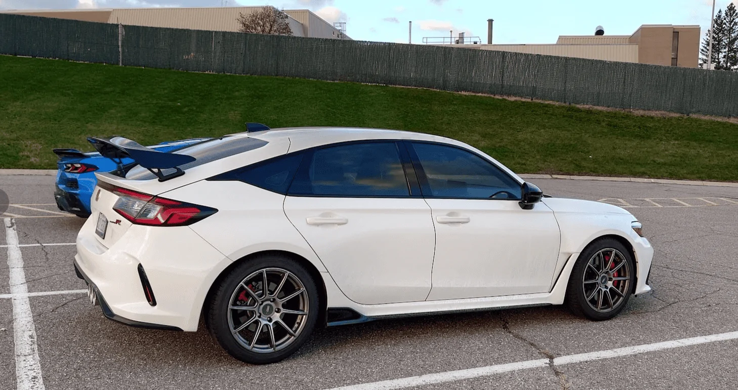

Threw the snow wheels and tires on yesterday as the Michigan weather took a dip, was hoping to get another week of not using snows but it started to flurry at work yesterday that I just decided to swap. These are my old snow wheels and tires from FK8 and they are as mentioned,Michelin X-Ice XI3 in 235/45/18(slightly bigger than FK8 tire size so bigger still to FL5's, 4% taller), on some Flow one wheels 18x8.5 ET40

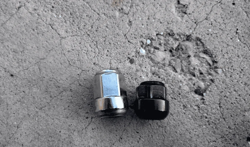

Also first time took the wheels off so interesting to see different lug nut size to the FK8's

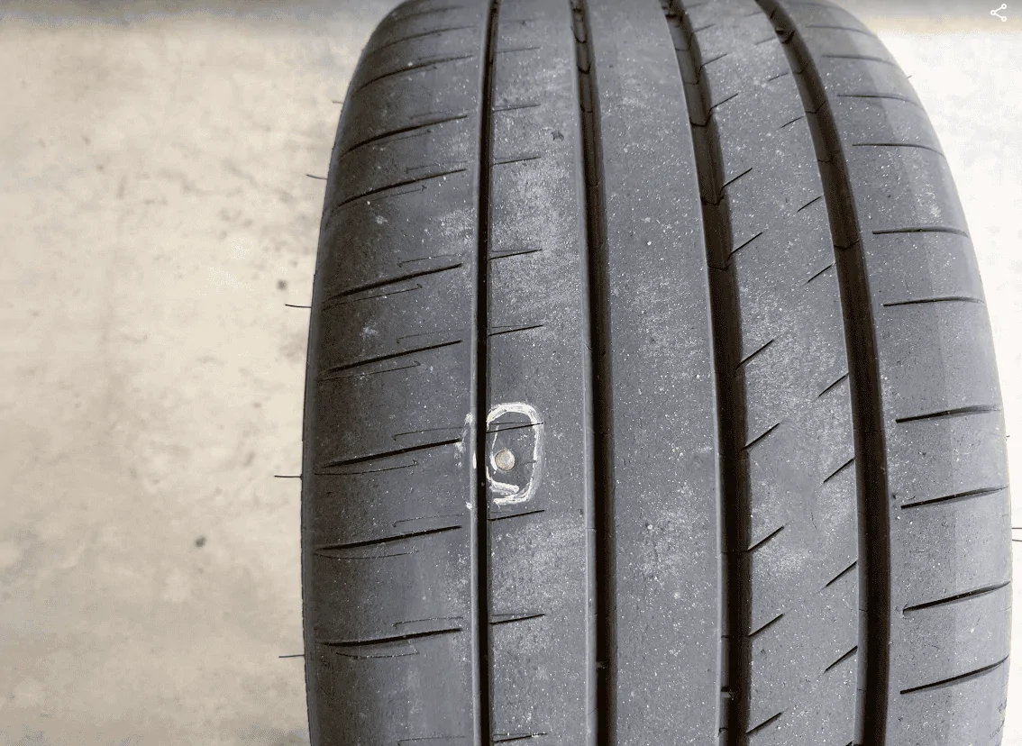

And found a nail in one of the PS4Ss....
