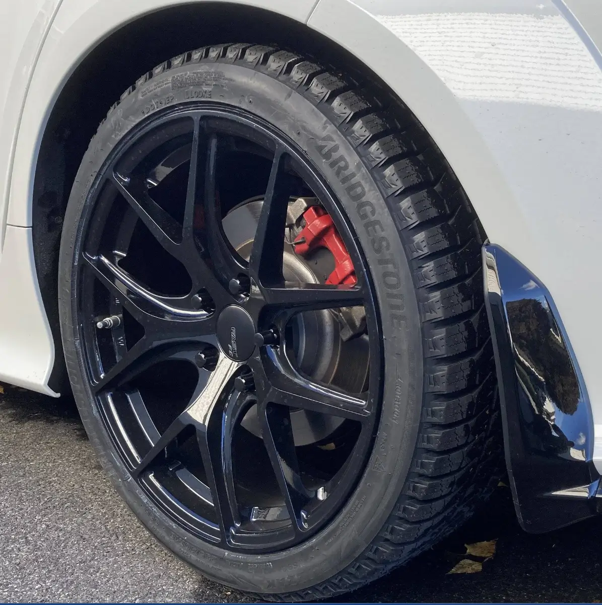

That fitment against the spokes is exactly what my BBS SR 18x8 +44 wheels looked like, so I bought these 2mm spacers from AU in order to get proper clearance to the caliper and also allow the hub centric ring to still be able to get a good grip on the hub: https://www.ebay.com/itm/325379197935

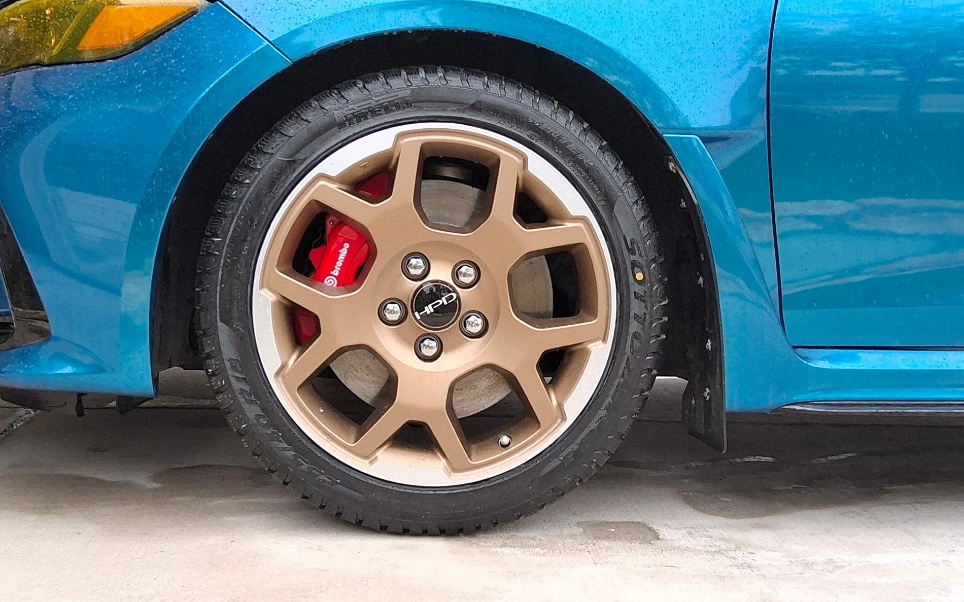

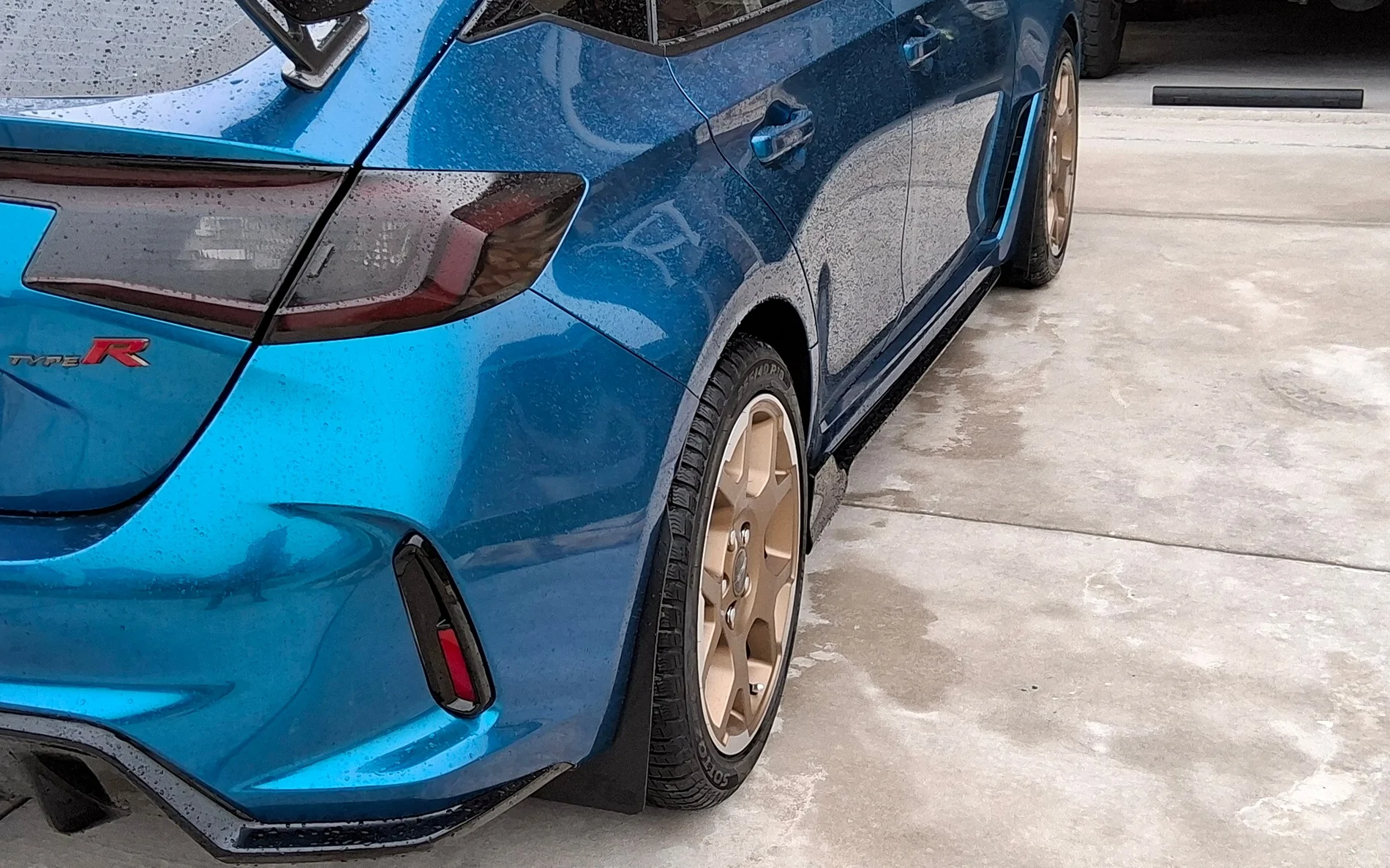

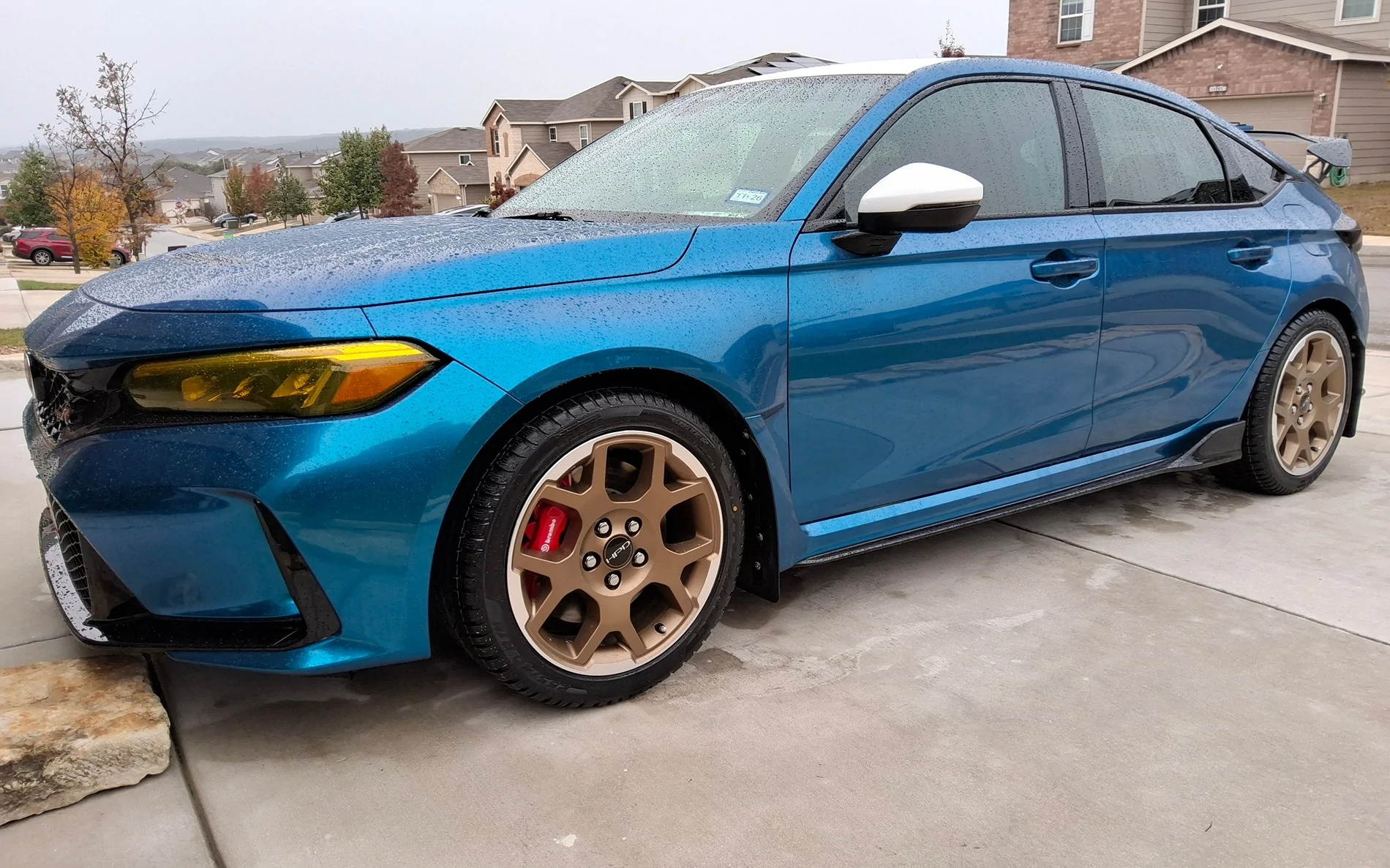

Got my new "Texas Winter" (🤔 ... 🤣!!!) wheel and tire setup installed.
Hey, don't laugh.
We did have The Freeze of '21 in February 2021,
where it got all the way down to 9 degrees Fahrenheit in San Antonio!
Dude, that's Bone Marrow Hibernation for Texans!
Suspension: Stock FL5 .
Wheels: Enkei made Honda Pilot Matte Bronze HPD wheels. 18X8.0 , ET +50 .
Tires: Pirelli Winter Sottozero 3. 255/40 R18 . (Got em for "cheap" on clearance at TireRack).
Spacers: Eibach 20mm spacers .
NOTE: At LEAST 20mm spacers are required for these Honda Pilot wheels to fit around the FL5 front Brembo calipers.
This combination basically makes for a 18X8.0 ET +30 wheel size.
See my build thread for more.

Fitment.

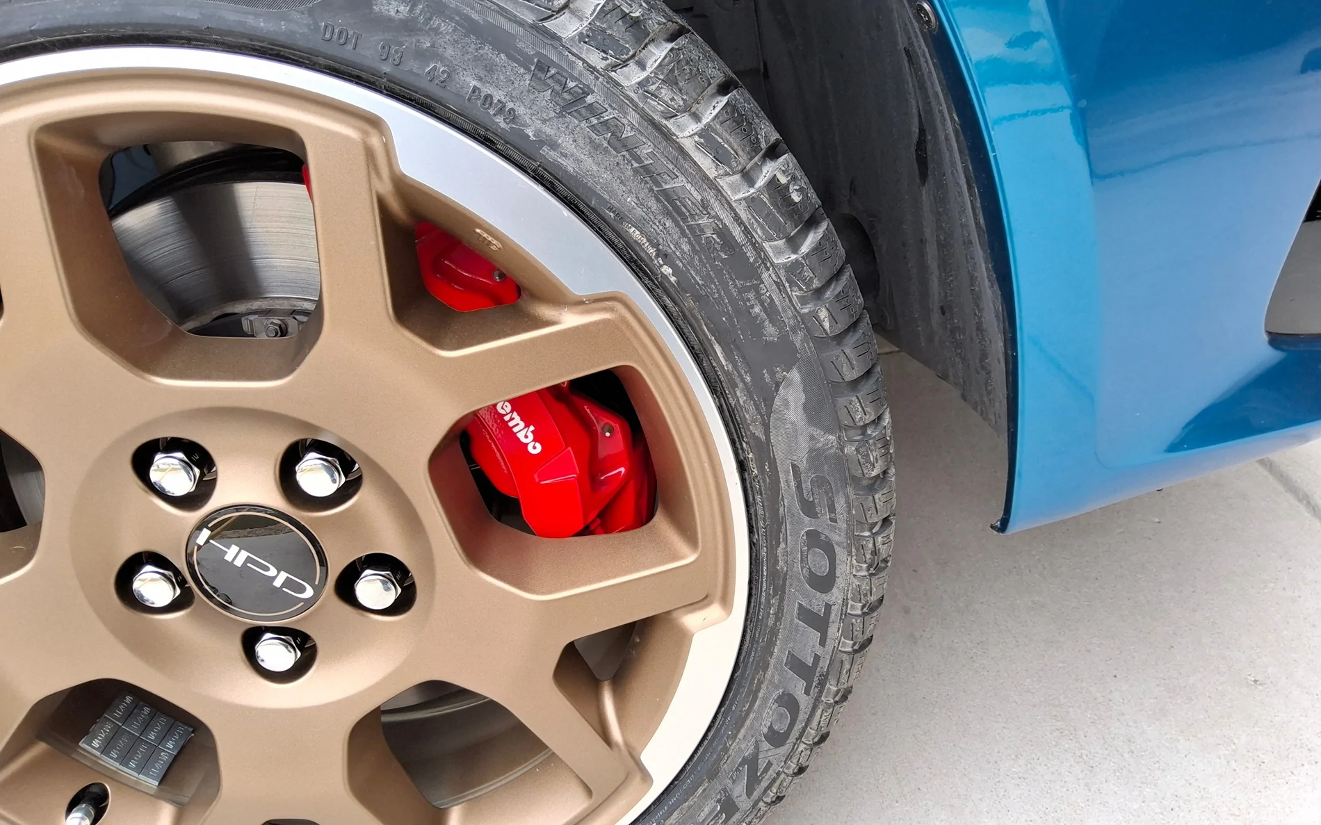

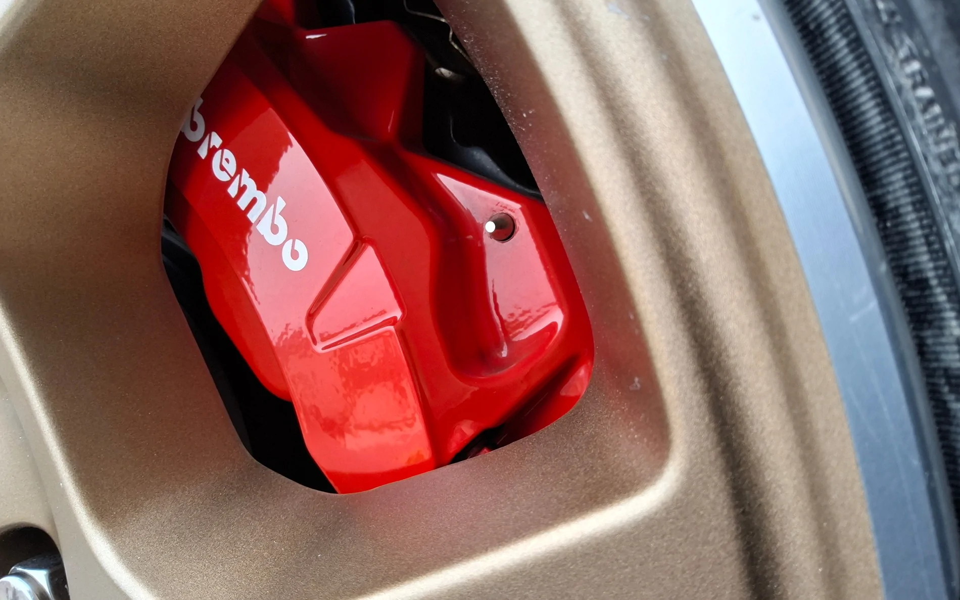

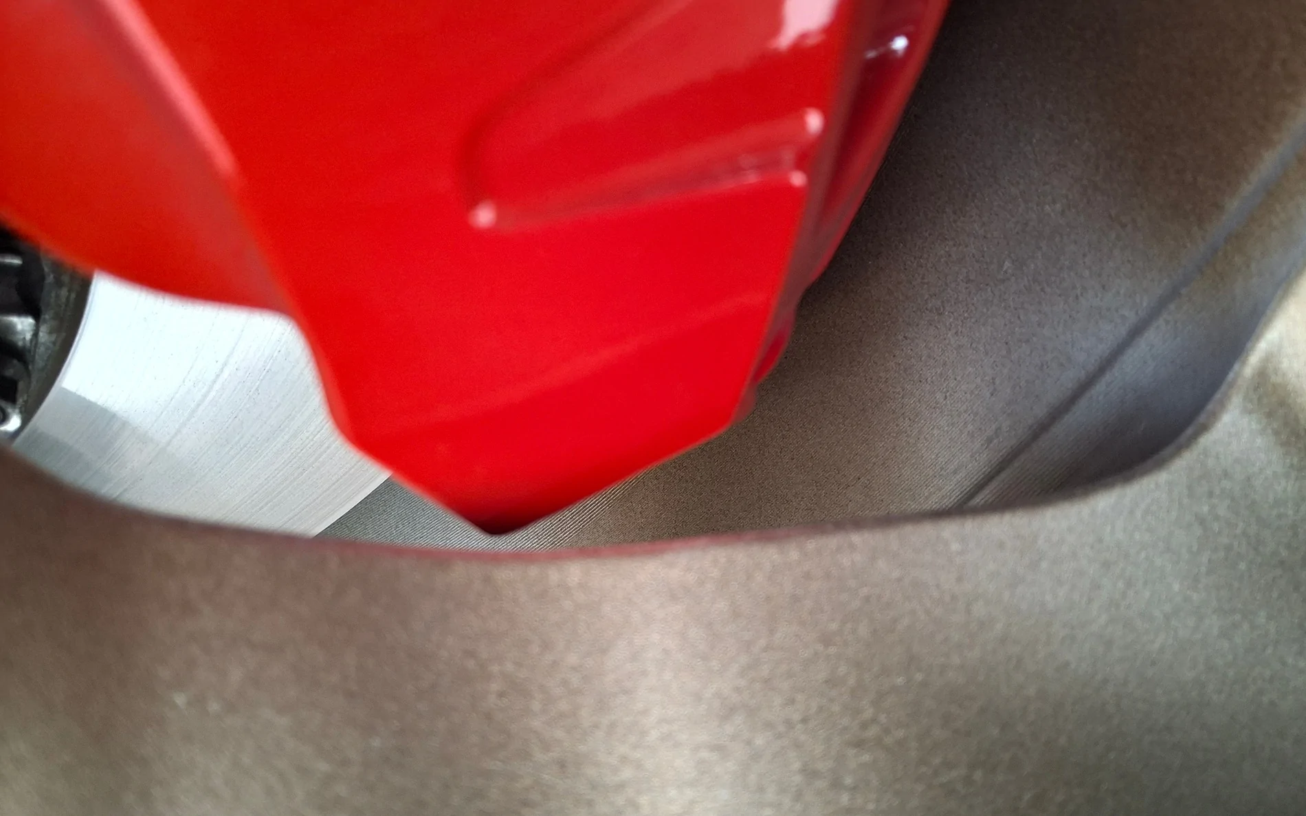

ET +50 Wheel + 20mm spacer to Brembo front caliper clearance.
11th Gen Honda Civic Winter Tire Setups 20251216_123120
11th Gen Honda Civic Winter Tire Setups 20251216_123155
11th Gen Honda Civic Winter Tire Setups 20251216_123140
20mm spacers give me about 5 to 6mm caliper clearance.
If you want tons of clearance and also want a more flush fitment, 25mm spacers are probably good.

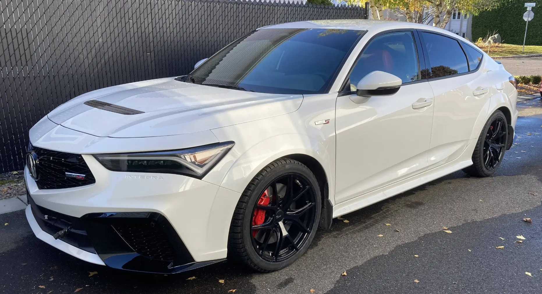

I posted my setup with the BBS SR 18x8 ET44 wheels here: https://www.integraforums.com/forum/threads/winter-wheels-bbs-sr-18x8-44.58346/
My fitment isn't flush and that's actually what I was going for, the more of your car the tire can see the more salt spray and junk is going to be coating side of the car instead of staying confined to the wheel wheel. Winter setups aren't supposed to look pretty IMO. 😆

Nothing to do with how flush the wheel sits, it's a limitation of the hub centering ring on the BBS wheels and the rather shallow amount of hub poking out from the OEM rotor hat.
Having mounted these wheels with the 2mm spacers, I do think that 3mm would have lost hub centricity completely on the front end of this particular car. The wheels just barely grab the hub. Really, you either want a spacer that doesn't interfere with the hub doing it's thing and centering the wheel, or you want a spacer thick enough to have it's OWN hub integrated.
There is a third option in that with aftermarket wheels, you can sometimes get thin spacers that have a larger, integral hub for the hub bore of the wheel (say 73.1mm) inside of which is a smaller hub bore that's made for the hub of the car (64.1mm in our case.)
But failing that, with the in-between sizes of spacers you set yourself up for vibrations due to the wheel not being centered on the hub. I speak from unfortunate experience and wasted money on this topic.

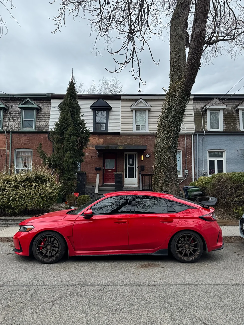

Put Alpin 5 in oem sizing on the oem wheels for winter. Car drives really well for winter tires....fun is maintained.
Got oem forged ones for summer and put the PS4s on those....
My opinion only - the ET60 is key to minimization of torque steer. Very key. So I chose to go OEM. It was not about dollars but about engineering.

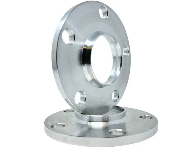

So on the 15mm and 20mm sets, there's enough meat there that they can do matched inner and outer bores. But not so on thinner spacers, which is why you typically see those machined without any lip at all and you just have to hope the hub on your car protrudes far enough to grab the wheel.
What makes these mismatched hub spacers possible is most aftermarket wheels have a fairly large machined center bore, usually 7x.x mm. Our center bore is 64.1mm and ordinarily, you'd use a hub centric ring snapped into the 7x.x mm wheel bore in order to make it work with 64.1mm. But that difference in size gives you some meat to work with in order to have the car's hub protrude into the area of a hub machined into the spacer. They're harder to find, but definitely worth it if you need a spacer that's in that weird size area and you have aftermarket wheels.
Here's an example in 10mm:
11th Gen Honda Civic Winter Tire Setups 1766067529055-na
From this site, not an endorsement as I haven't dealt with them specifically: https://wheeladaptersusa.com/produc...c-fix-clearance-issues?variant=49856342393121
Here's another example in 5mm:
11th Gen Honda Civic Winter Tire Setups 1766067700359-g5
From the same place I got my 2mm spacers from, and I would recommend these guys: https://caold.com.au/products/wheel-slip-on-spacer-5mm-5x120-66-9-69-5-mm-73-1-mm-hub-centric-lip
Note that this listing is the wrong hub bore on the inside, but it's the same concept. Caold does custom work, you just have to contact them and explain what you need. But shipping from Oz takes a while, so keep that in mind. Custom + international shipping could be a month or more waiting.
