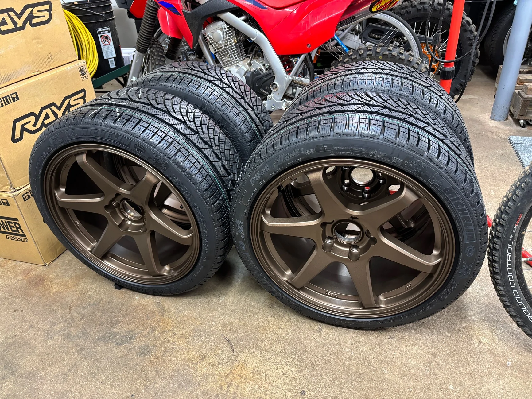

2fast916
Jon
Feb 13, 2025
89
41
2025 Honda Civic Type R
I echo coolnick...
Very similar set up except I decided to try 255/35R18 Michelin Alpin PA4's

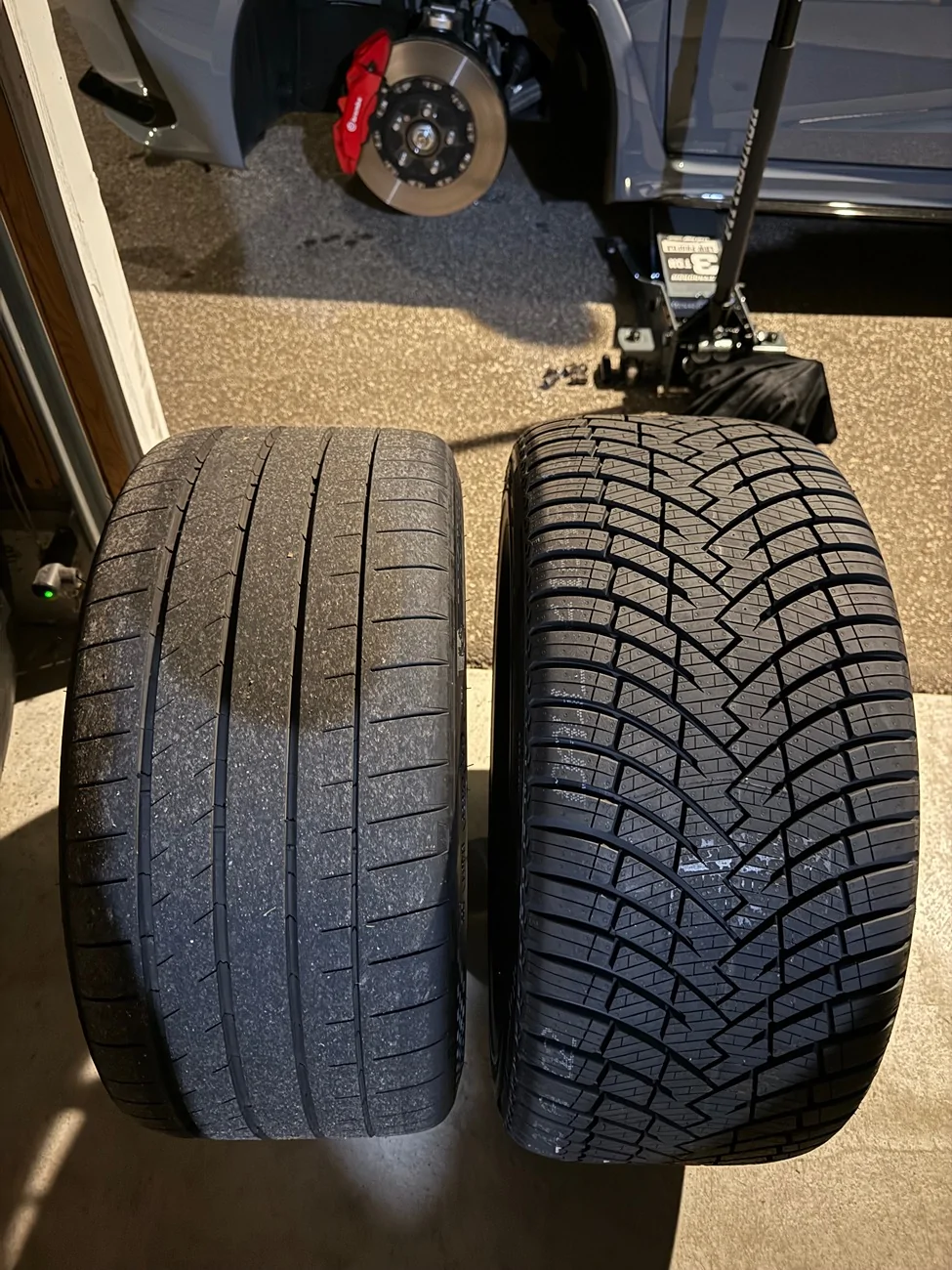

I run 255/35/19 Pirelli Cinturato WeatherActive. No issues with fitment on stock wheels lowered on H&R springs.
11th Gen Honda Civic OEM Rims Winter Tires IMG_4208

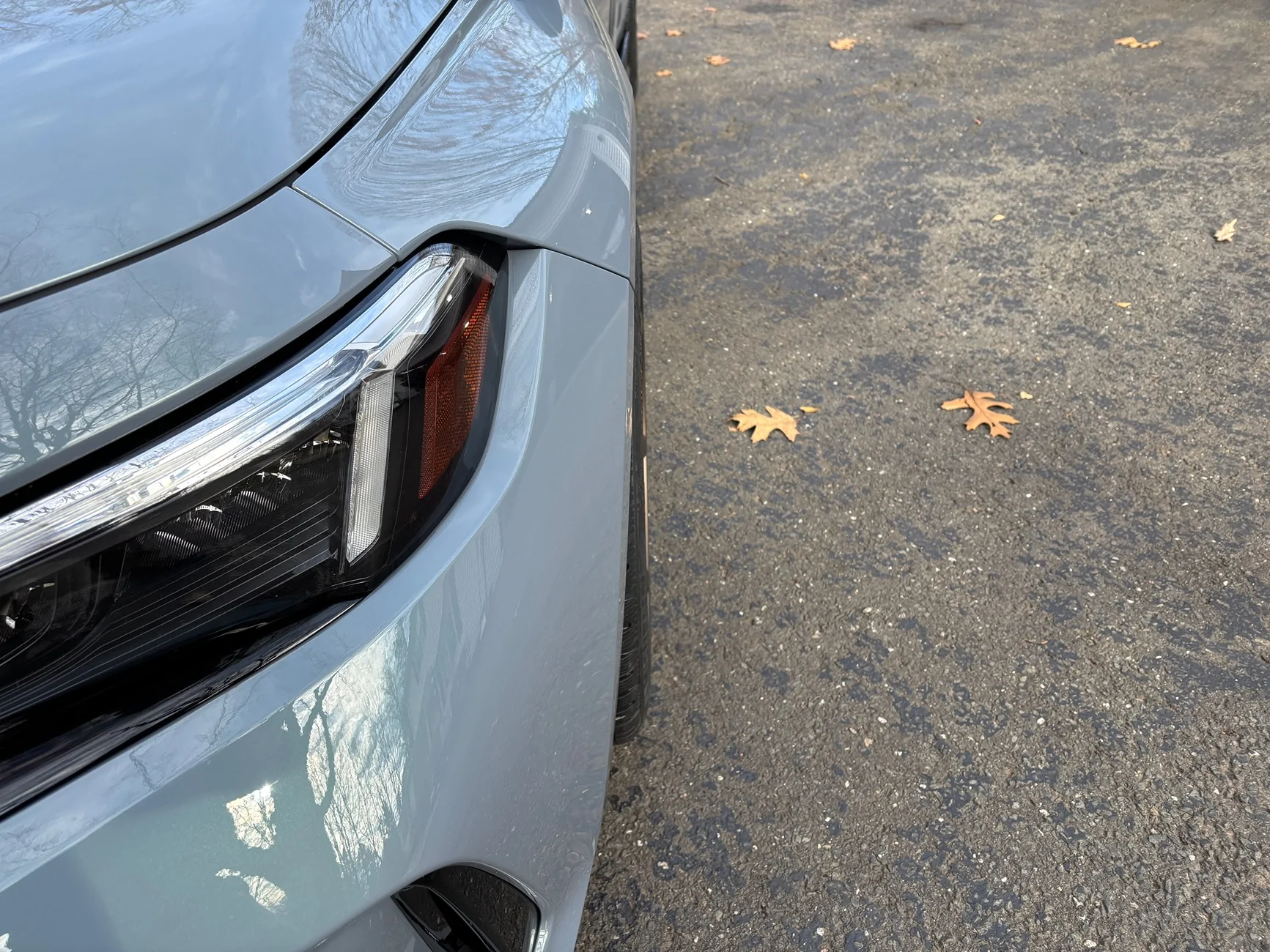

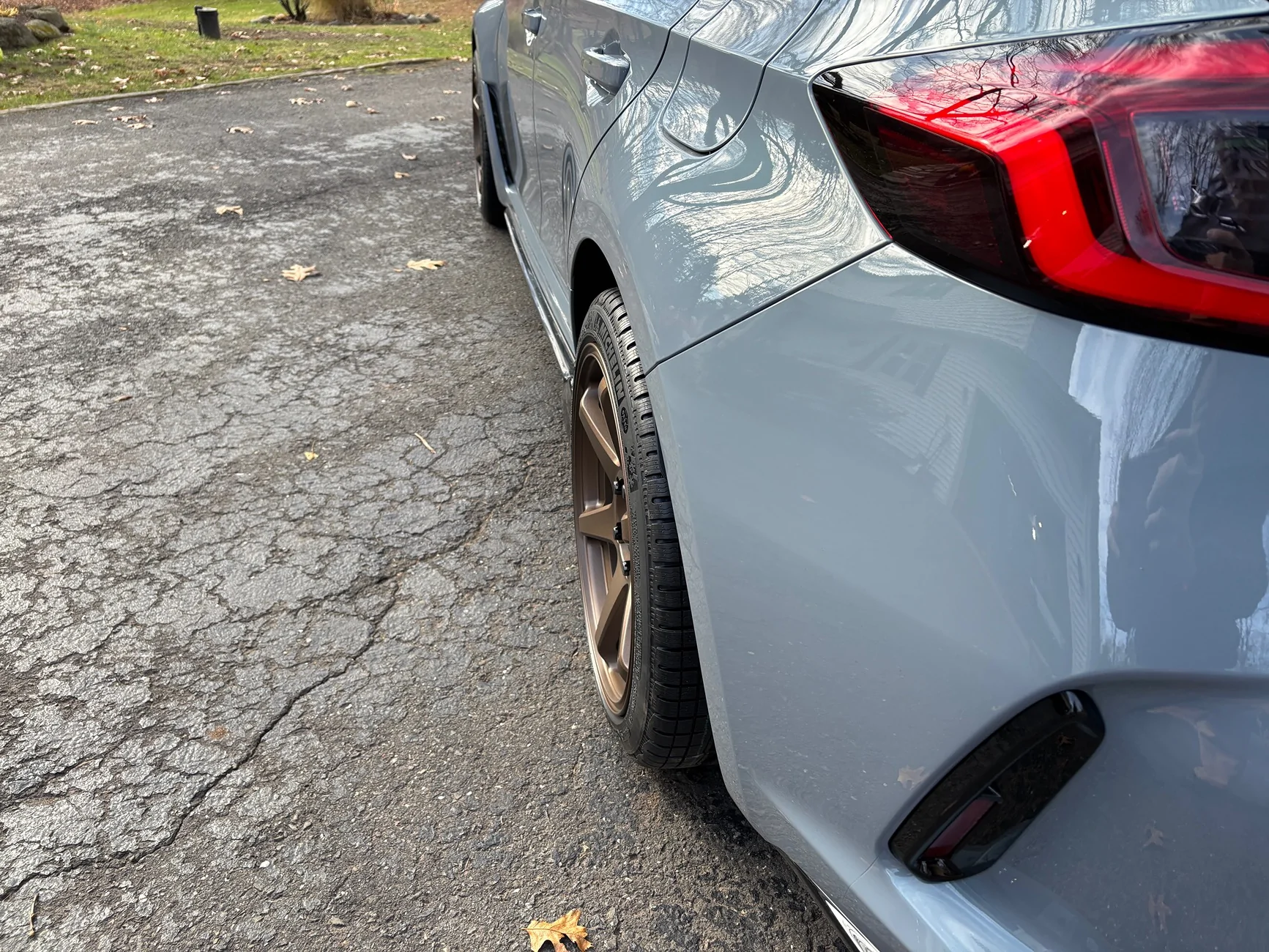

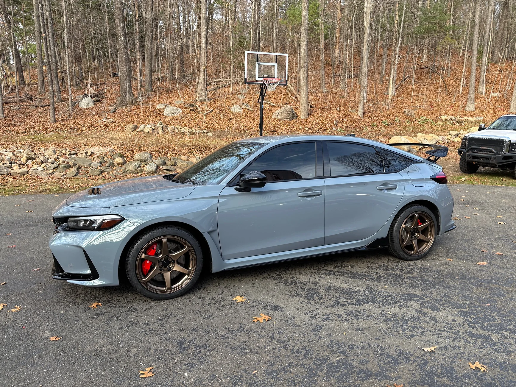

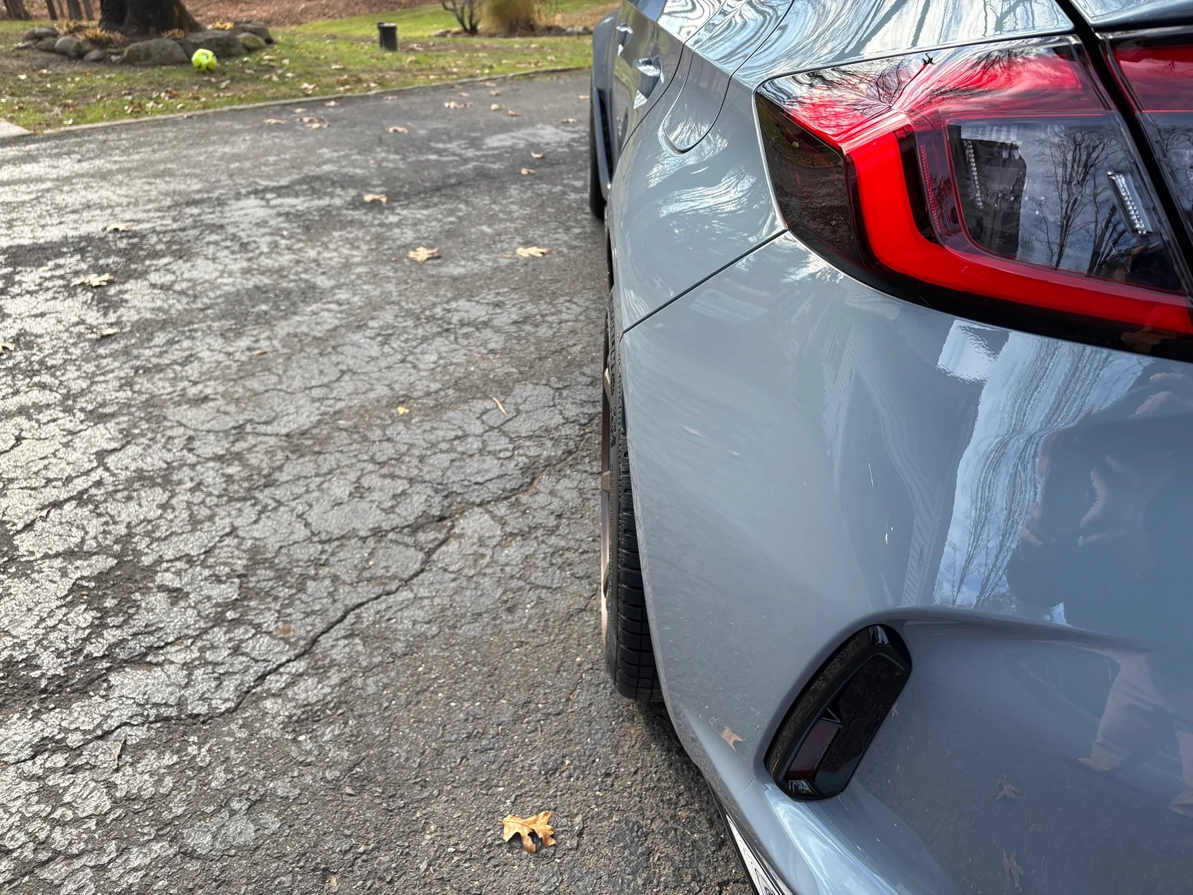

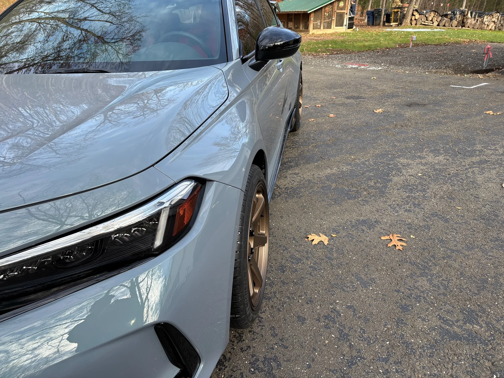

Today was the day I decided winter may actually be in the air…
11th Gen Honda Civic OEM Rims Winter Tires IMG_4024
11th Gen Honda Civic OEM Rims Winter Tires IMG_4025
11th Gen Honda Civic OEM Rims Winter Tires IMG_4027
11th Gen Honda Civic OEM Rims Winter Tires IMG_4029
11th Gen Honda Civic OEM Rims Winter Tires IMG_4030
