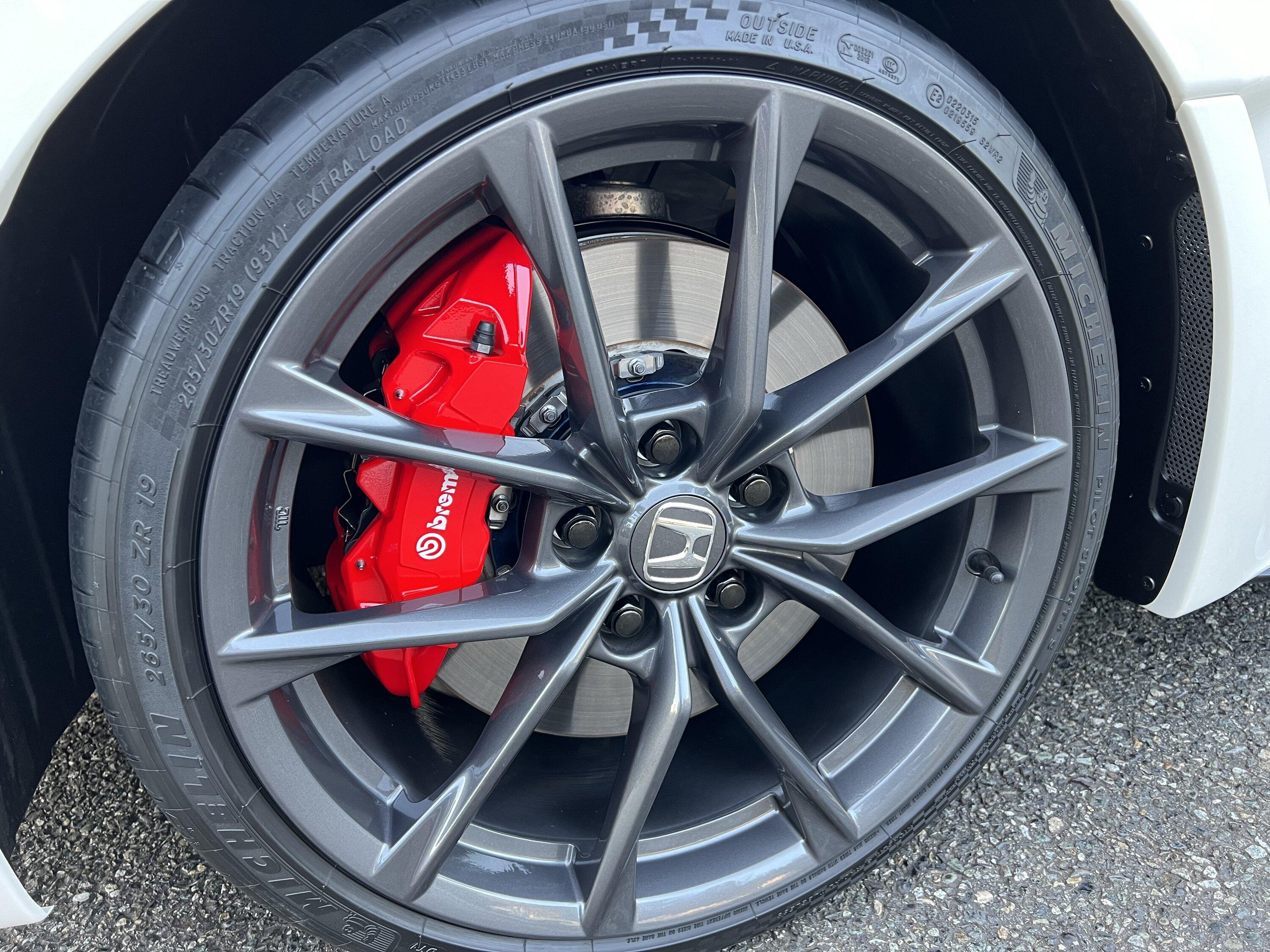

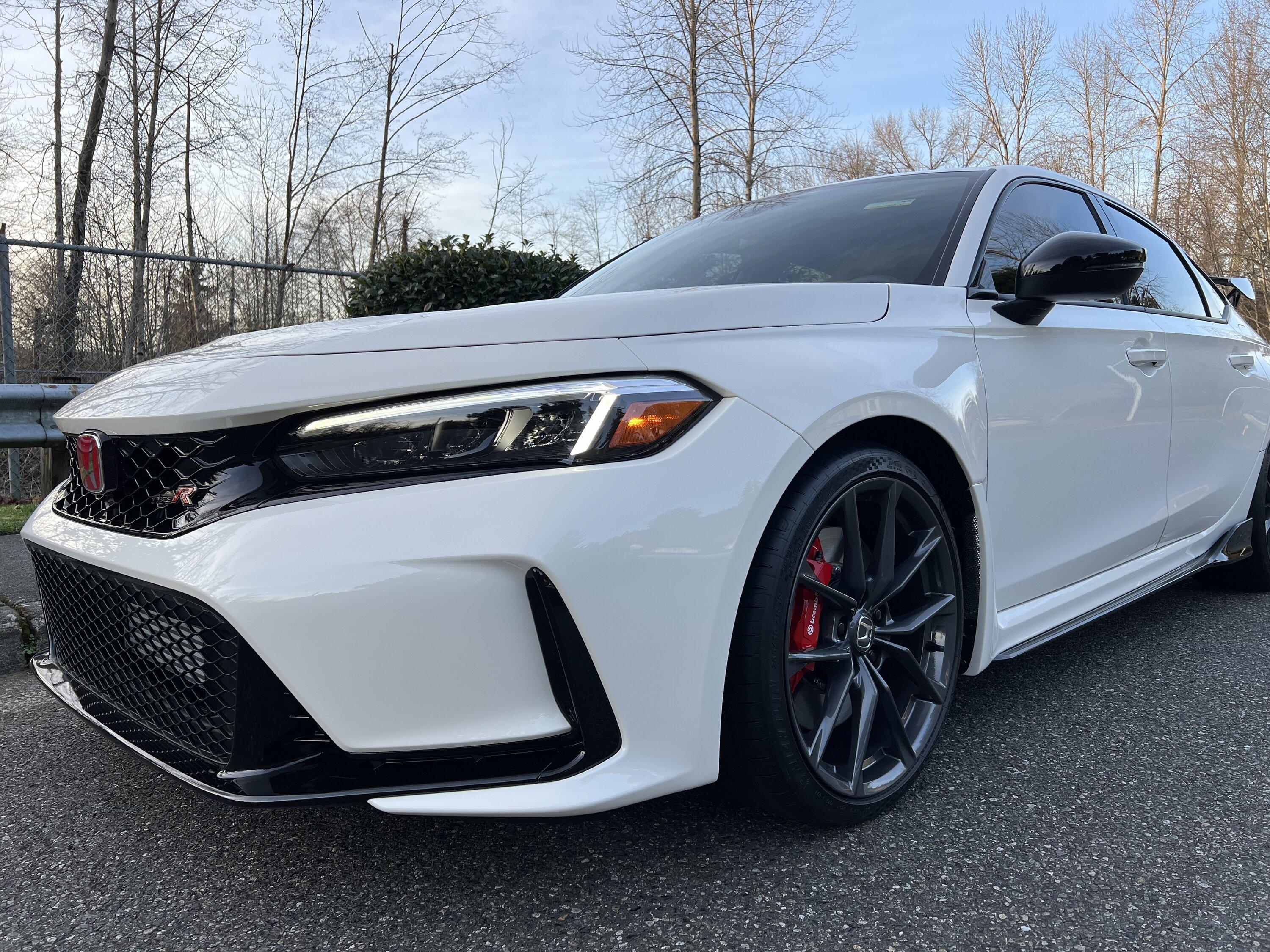

Stock Type S wheels and tires.
I might change tires to a 255/35 A/S I still haven’t decided what to do.

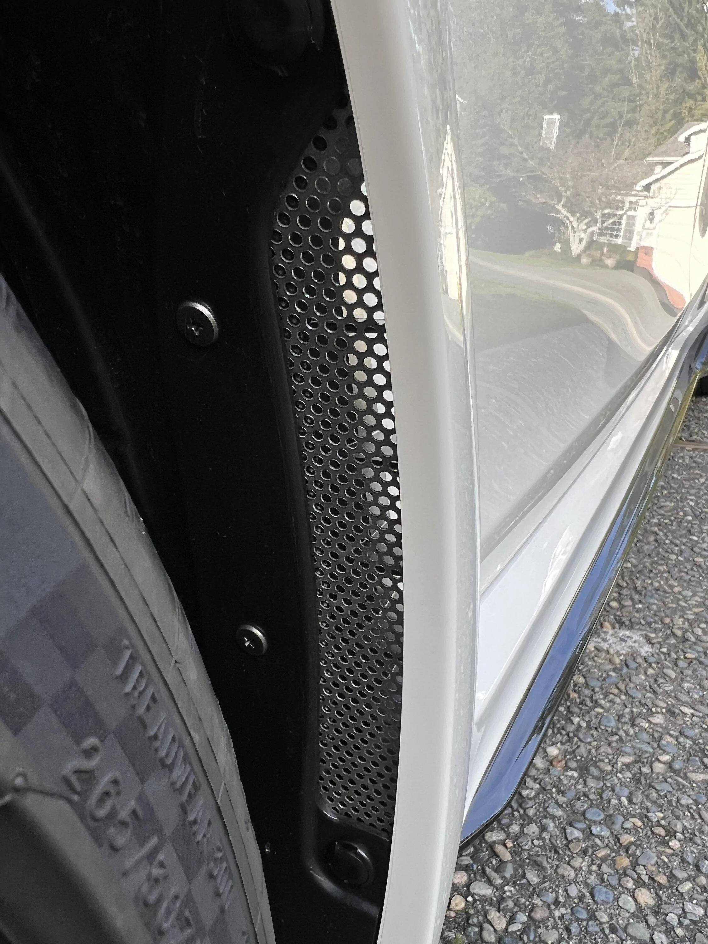

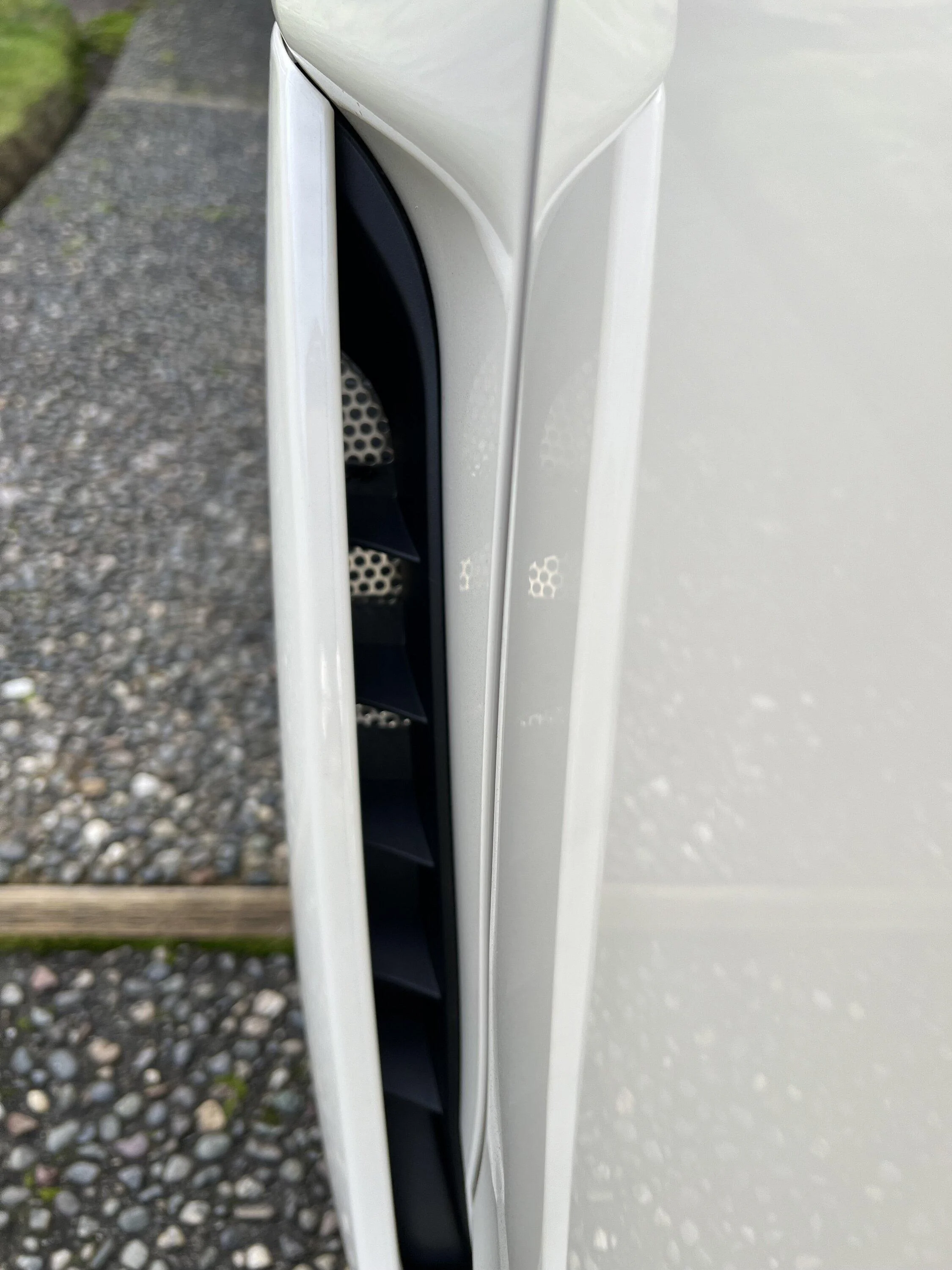

I also made some vents out of stainless from some old snowmobile vents I had. I may paint them black but should do the job for the time being.
