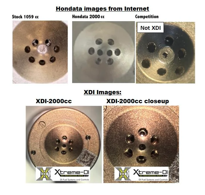

There has been a lot of talk about our XDI-2000cc injectors for the Type R, including cold start issues and rough idle.
A competitor has published pictures of injector tips and corresponding spray videos that show a bad competitor injector.
People have been assuming that "the competitor injector" is ours and that the idle issues come from the "bad spray pattern".
We don't know what injector they found and called "competitor injector", but it's for sure not ours. Please check out the pictures below.
Top row: images from our competitor
Bottom row: XDI-2000cc tip and spray holes​
Our XDI spray pattern is very different, and even the tip shape and surface finish are different. The "competitor injector" has a machined surface, ours is sintered material. The "competitor injector” looks like the “Keihin” Injector from the Honda Si 1.5T.
Keihin 1.5L injector and spray holes, we at XDI don't use those
Now Regarding the Actual Spray Pattern Design​
For the spray pattern geeks: counter bores reduce the L/D ratio (length over diameter), which leads to wider and shorter sprays (less chamber penetration).
That is not necessarily "better vaporization" or a “better spray”. It's great for emissions and fuel-air mixture with low air speed (low boost) and a ring of spray holes. When you add two spray holes in the center with small L/D, you add short, wide spray plumes in the center. There is no extra air in the center of all these spray holes. The sprays collide instead of mixing with air.
We studied a "dual center spray hole" design years ago. It poses the risk of a blown-off tip at high temperatures and fuel pressures, since it reduces the wall thickness between the spray holes in the injector tip below the required minimum, especially with deep counter bores.
At XDI we designed the outside holes with counter bores (small L/D) to fill the outside area of the combustion chamber without touching the cylinder walls.
We added a small-diameter single center hole with a bigger L/D and higher penetration, to reach the bottom-side corner of the combustion chamber.
That's where a lot of air ends up at higher boost, i.e. higher air speed. That extra air can create a local lean spot if you don't bring any fuel there.
