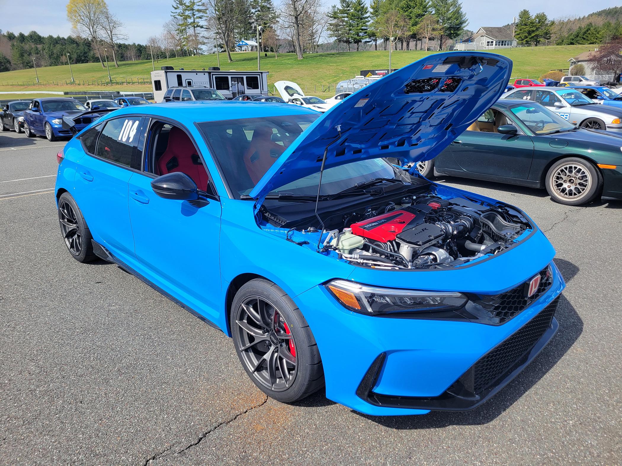

Love my VS-5RSs for my track set up...
Apex VS-5RS 18x10.5" ET47 Wheels - 5x120mm / 64.1mm - Anthracite (ApexWheels.com)
Nitto NT01 275/35R18 tires (DiscountTireDirect.com)
Superspeed Cold Forged Tuner Lug Nuts | 16 - 22+ Civic, 23+ Integra × 1 (UnityPerformance.com)
Stock suspension, no spacers
Looks good, do you have pictures from other angles?

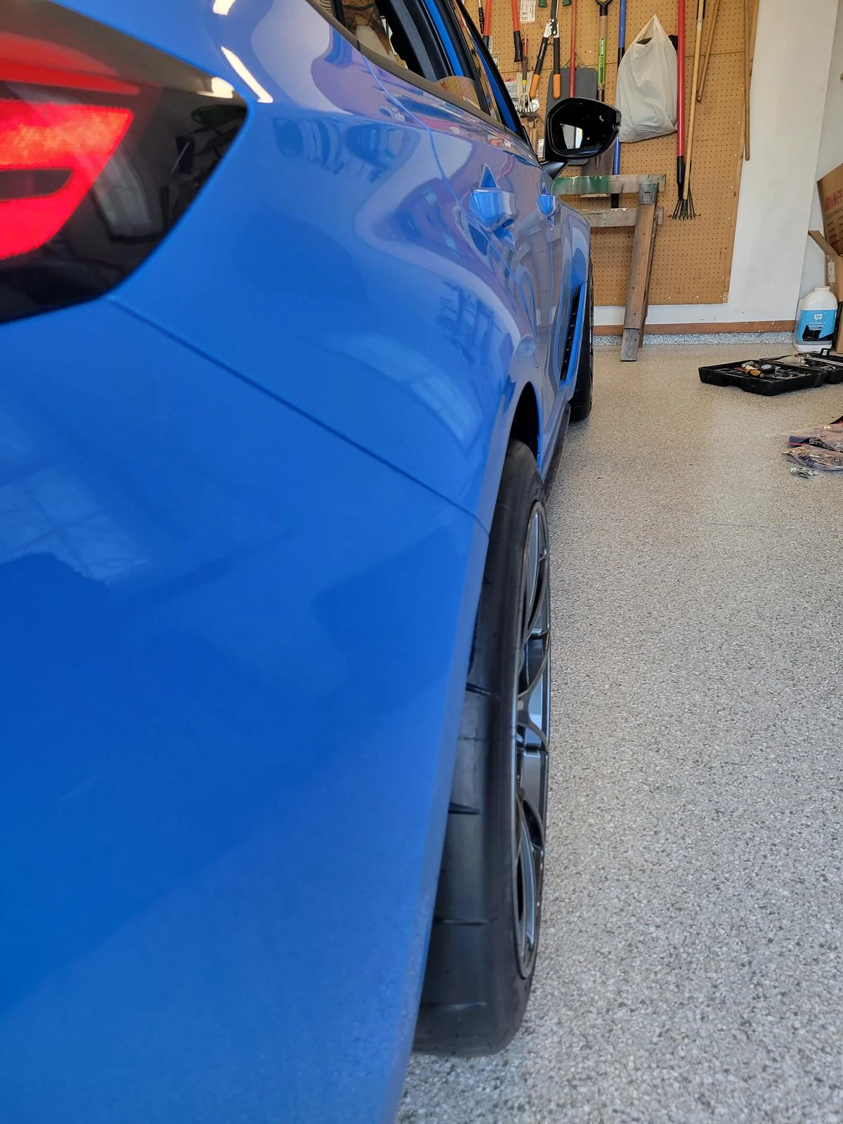

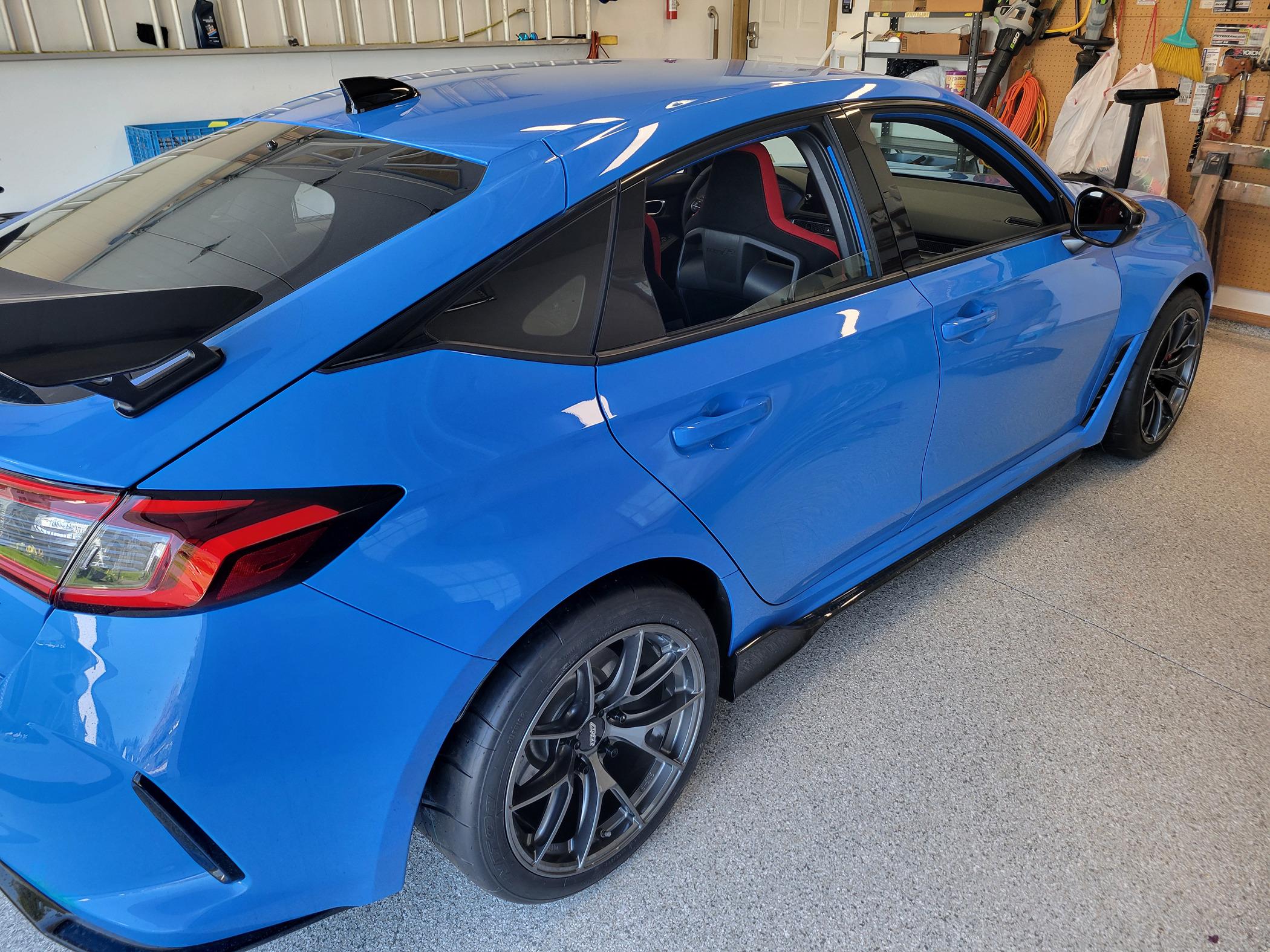

Thanks for sharing these pictures! It looks like a little poke with this setup is that correct?
No spacers needed, that's for sure! I like it - gives it an aggressive look with no fitment issue.

Any camber adjustment? I think this is the route I'm going.

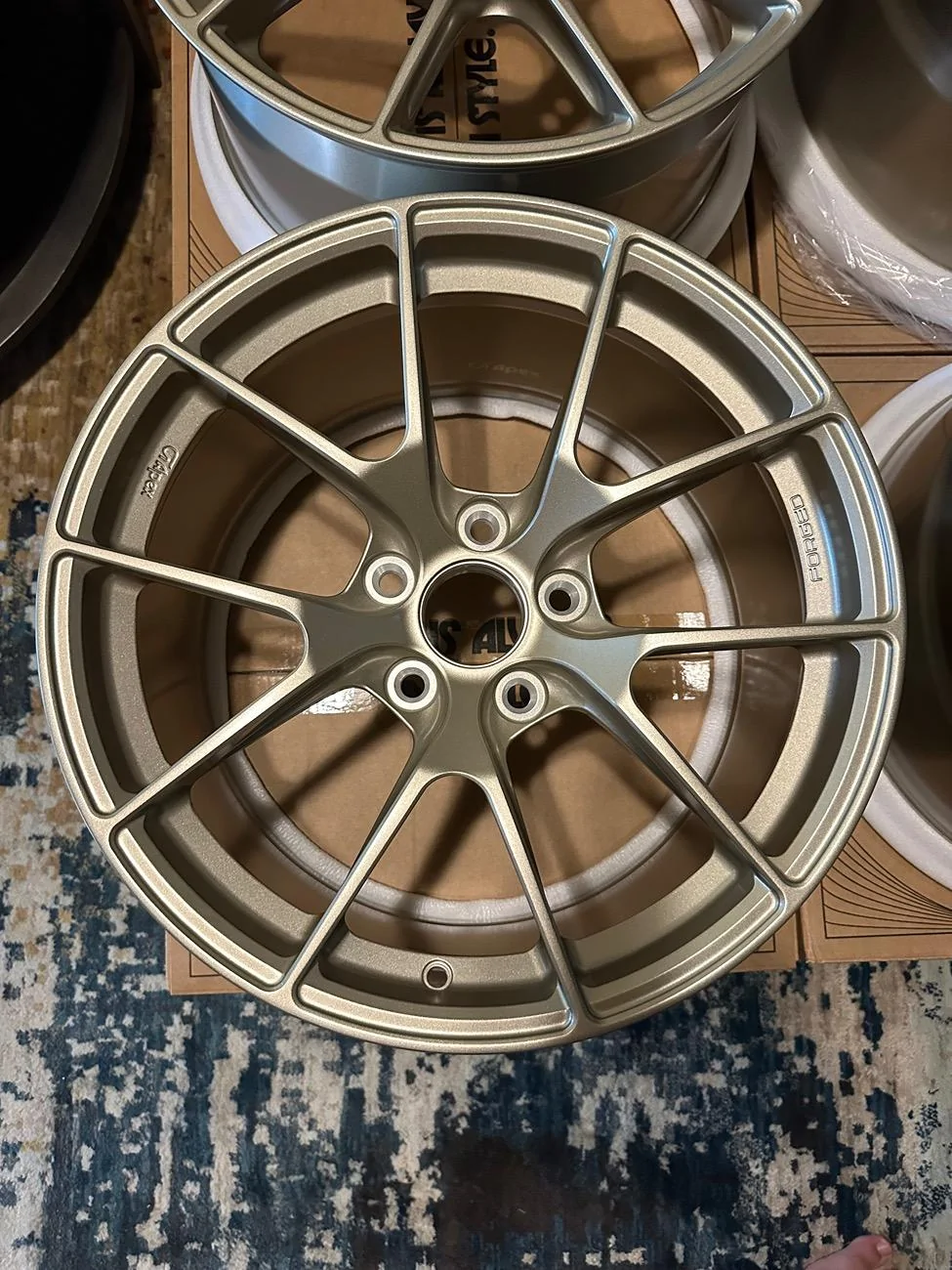

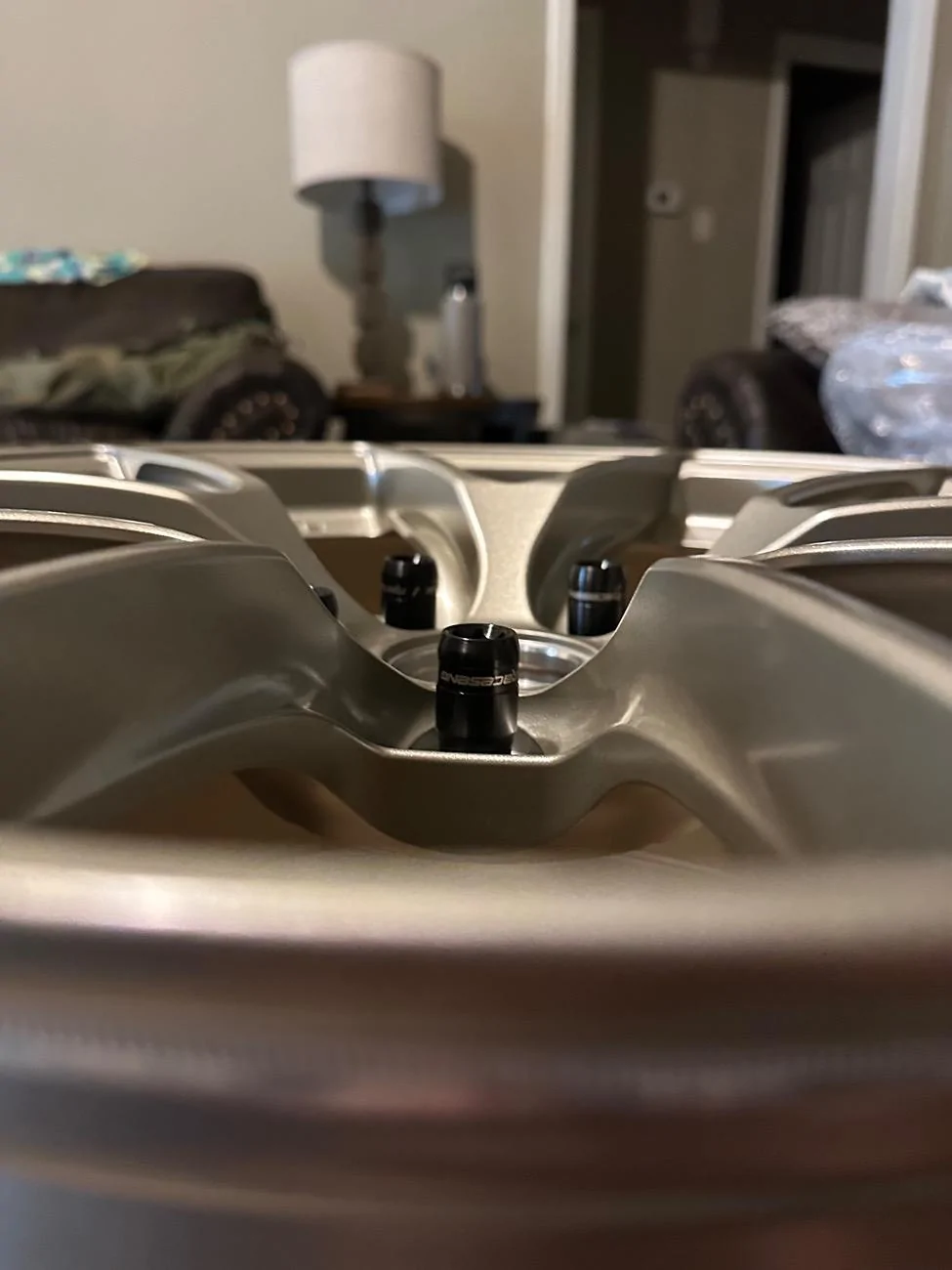

Finally got my 18x9.5 +45 VS-5RS in Motorsport Gold in from UPS losing them, somehow. And snagged some Raceseng titanium lug nuts during their July 4th sale.
I’m torn between DWS06+ in 265 or 275. My Type R is my daily, and I drive in all the seasons, so I feel like the DWS06+ is a good fit for me. I just can’t decide on the size.
I love a good meaty fitment and like the idea of the 275 being more flush with the fender, and even possibly a 275/40. I have no intentions of lowering my car either, but are there any negatives to a 275?
From what I have read a 40 profile tire wheel throw off the speedo, as well.
Looking for advice any advice/opinions.

Typically we would recommend going with a 275/35-18 with these wheels, but aside from the speedo being slightly thrown off there shouldn't be any major issues with a taller tire.

That is actually what I ended up deciding to go with. Continental DWS06+, getting them mounted next Friday. Can’t wait!
