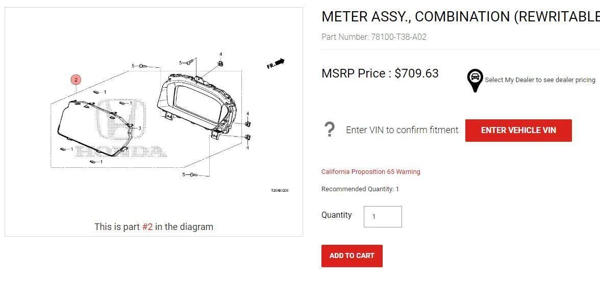

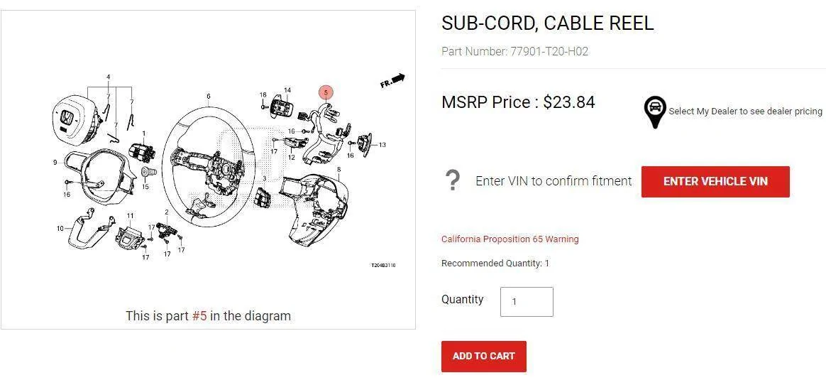

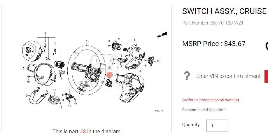

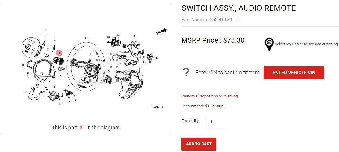

I started a thread a little over a year ago to see if any of the digital clusters would work on the Si, but none of them would work without errors as every other model has options that the US Si does not. Well I became the guinea pig today to do the first test of whether the 25 Si cluster would work, now that we have a full digital option for the US Si. I'm here to tell you the swap works!
It took ordering 4 parts from the 25 Si, a trip to my local Honda service department, and 3 hours of labor, but it is fully functional AND you get a few new extras with the cluster. Below are the 4 parts you will need to order to make the swap work. I was told to beware that, once you do this swap, your OEM cluster will no longer work, and you will have to order a new OEM cluster and have it programmed back, if you decide to put it back to stock.
