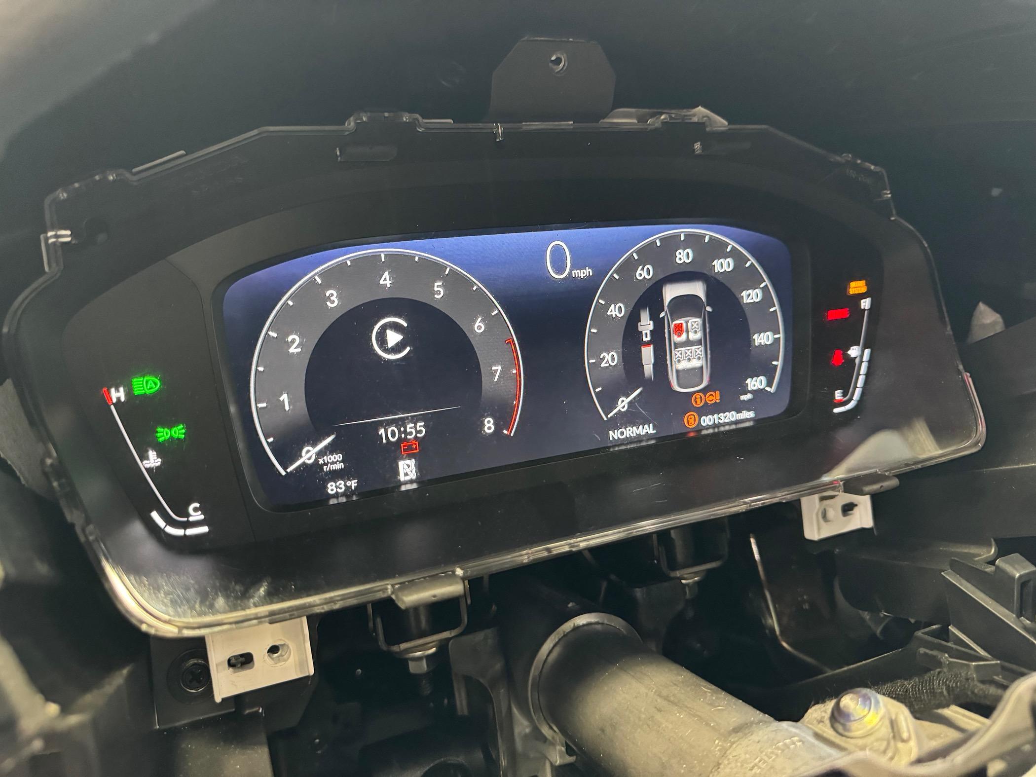

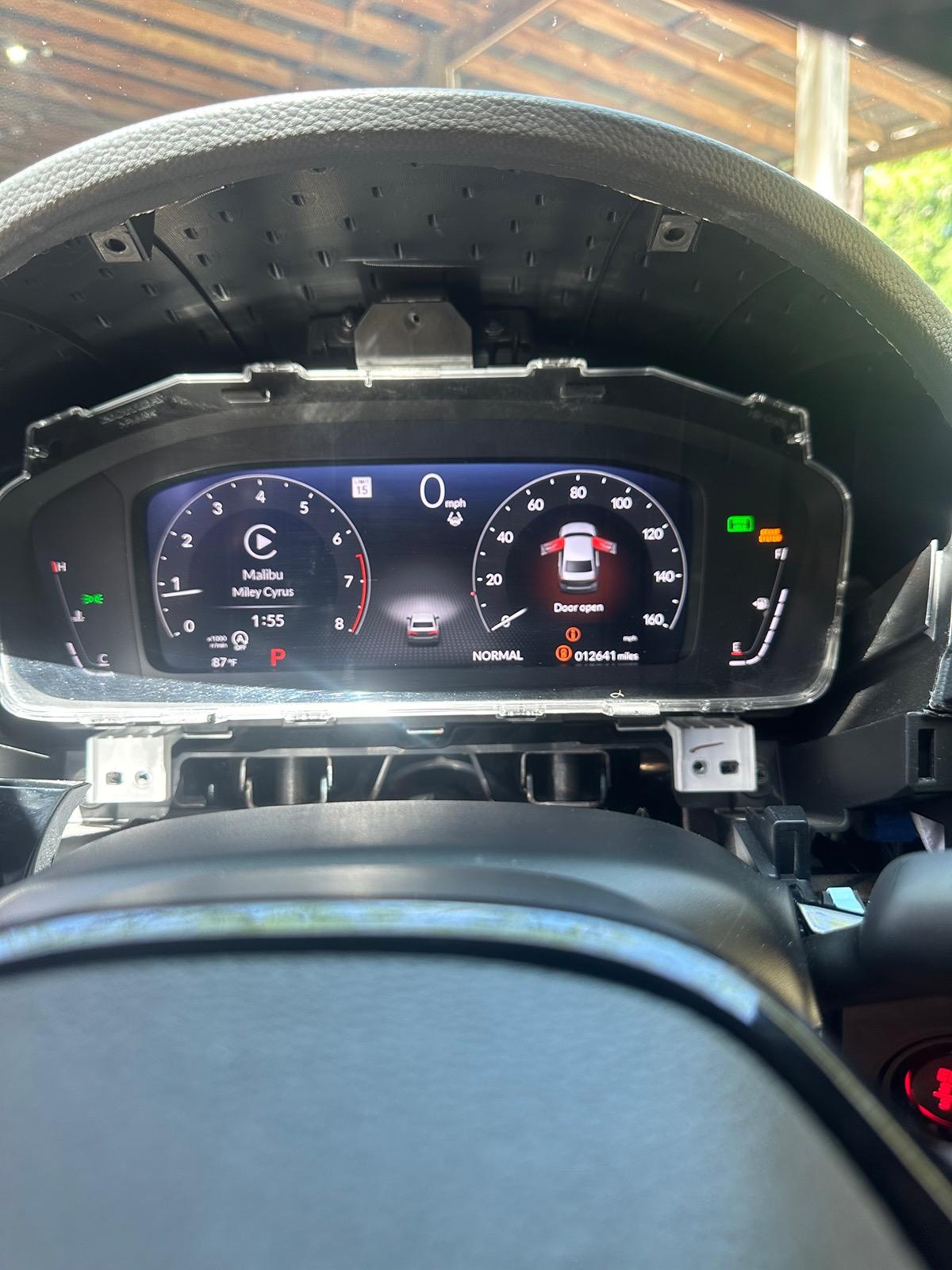

I know this is a Si thread but its the only Thread in the whole internet World that goes over Cluster Swapping. So here i am lol. I ordered a Touring Cluster and Steering Wheel for my 2.Slow Sport. I absolutely hate the fact that i cant see Coolant Temp and Music information and decided that has to change! I will also report back once everything comes in.
Nic
Jan 12, 2024
2022 Civic Sport
So, the Cluster and Steering wheel came in and i can only say wow! Everything works as it should!! Coolant Temp works! Music information works! However you will get warning messages for Blind Spot fault, Low speed braking fault, Parking Sensor fault since the US Sport model is not equipped with these features! Those faults can easily be scrolled away and won’t pop up again for the rest of the drive! A touring Steering wheel (or controls) is required to control the Cluster! And yes i listen to Miley Cyrus, leave me alone Lol

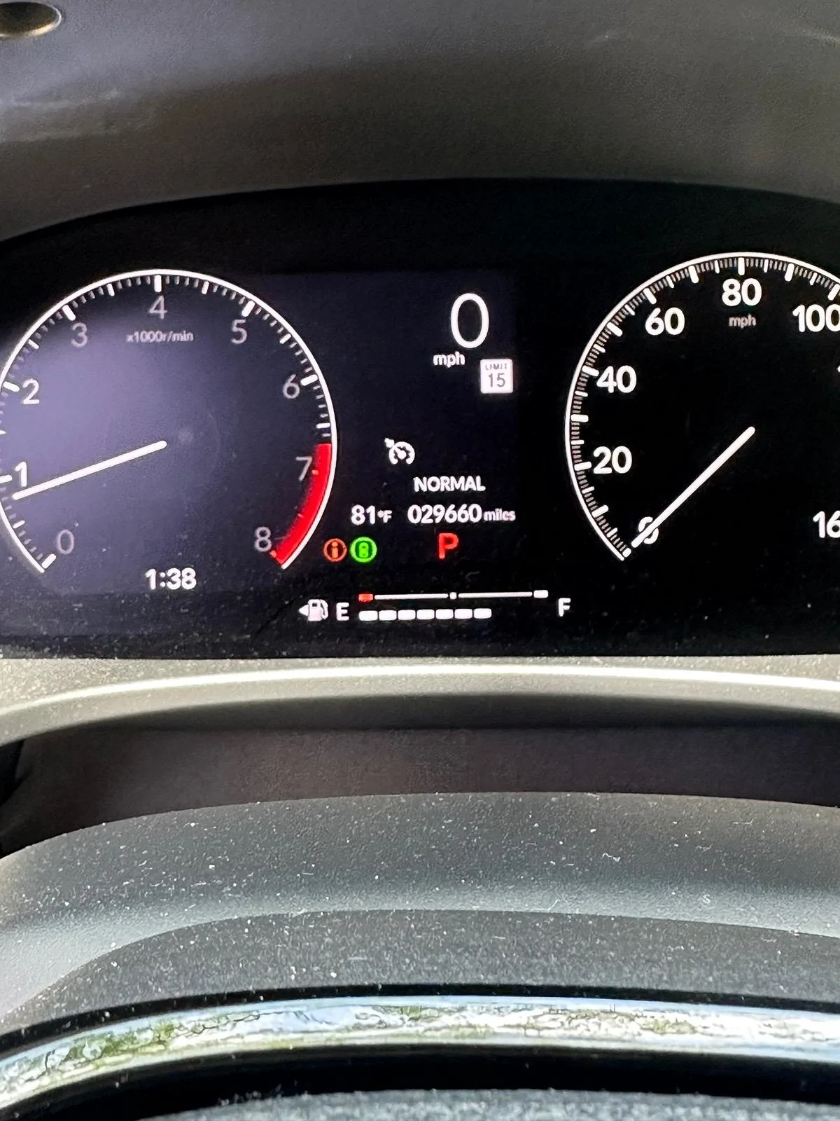

Anyone interested in buying my cluster project off of me? Haven’t found someone to reprogram and don’t want to purchase another set of steering wheel buttons. Mine came out of the 24 Sport Touring.
Forgot to mention it is off an Automatic model so I don't know if it can be flashed to take away the "PRNDL" light that will remain on.

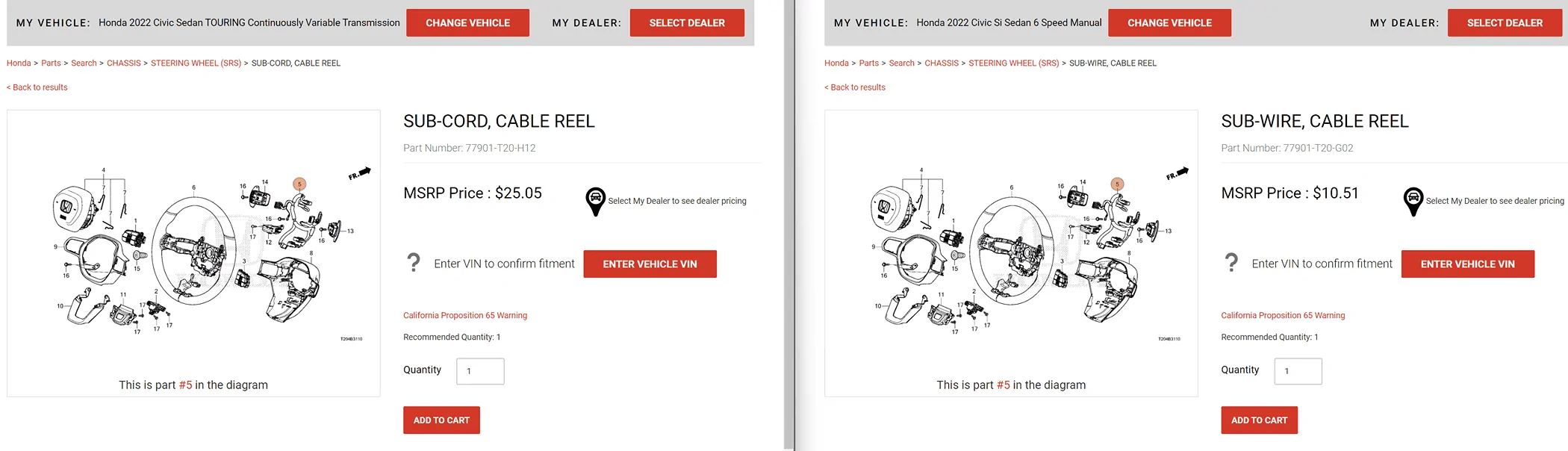

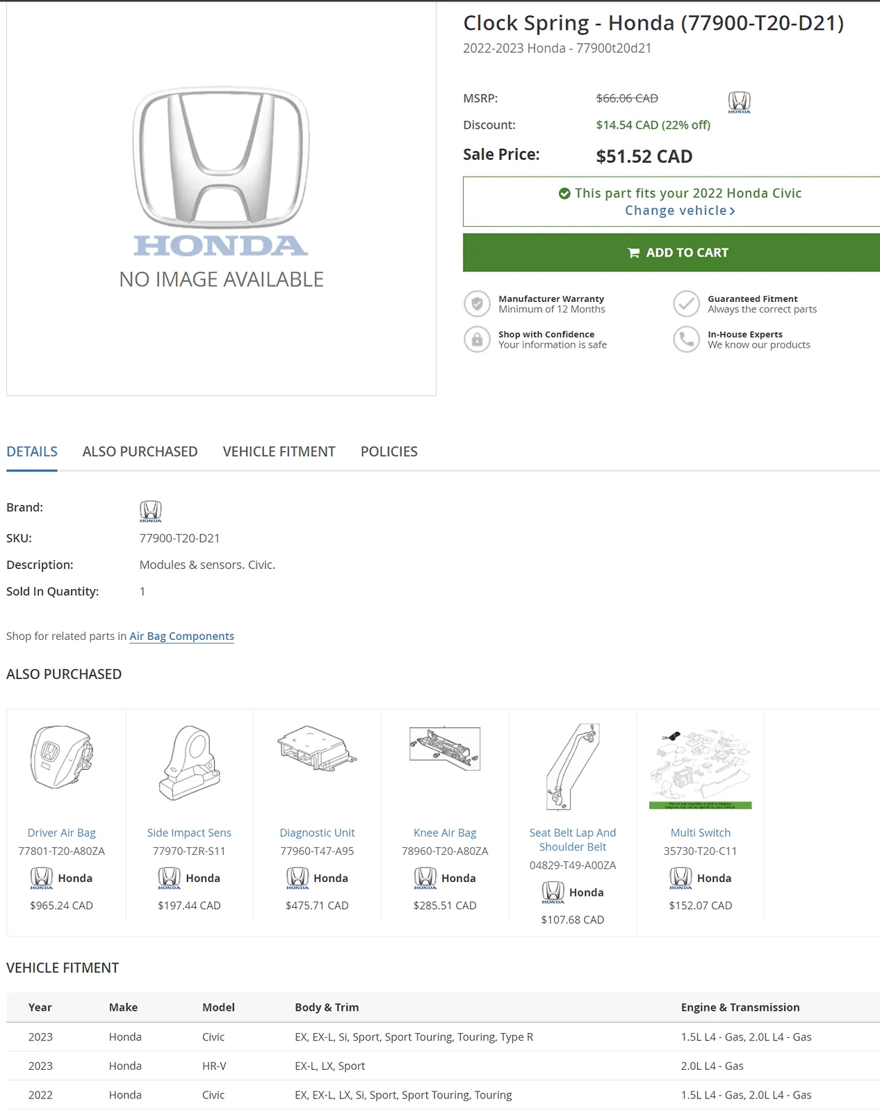

I am in the process with the Canadian si guage with along with the steering controls from a 2024 accord because the seemed similar. So far, with the gauge in, I’m getting errors for parking sensor. The media controls from the Accord work fine but the cruise control side seems to be having issues. Looking at the back, the part numbers are the same on the cruise control side for accord and civic so I believe I just got a defective unit. I have parking sensors on order from mik store.
chowda
Arif
Mar 21, 2024
Virginia US
2022 Civic Si
I am having trouble getting the right side controls to work even with a replacement from a civic sport touring( again same part number but i tried it just in case i got a defective one from a 2024 accord). I am looking at parts diagram and the clockspring is the same part number for the two trims so i have two conclusions right now.
1) the wiring harness for the steering wheel controls are different
or
2) I have to clear the parking sensor issues before i can use the right scroll wheel (on order from mik store)
For now, I am going to wait for the sensors to arrive before trying. If anyone else has solved/encountered, lemme know

The steering wheel harness is differe
did you have to change the wiring harness or the cruise control side scroll wheel functions okay? that and the parking sensors are my two remaining issues.
side note: the shift lights may be a novelty but look pretty
The wheel harness is different, but the clockspring is the same
