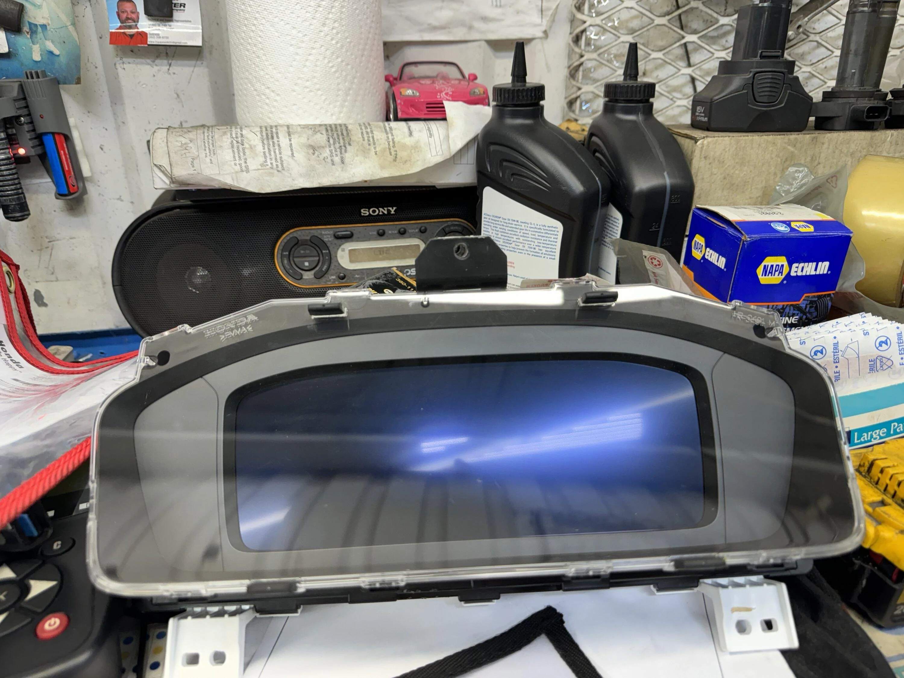

I found a used Canadian Si gauge cluster and it's on the way. I reached out to odo-pro.com and they said they should be able to reprogram the mileage. Updates to come.
If they can actually reprogram a used cluster that will be a game changer for us in this thread and the other one.

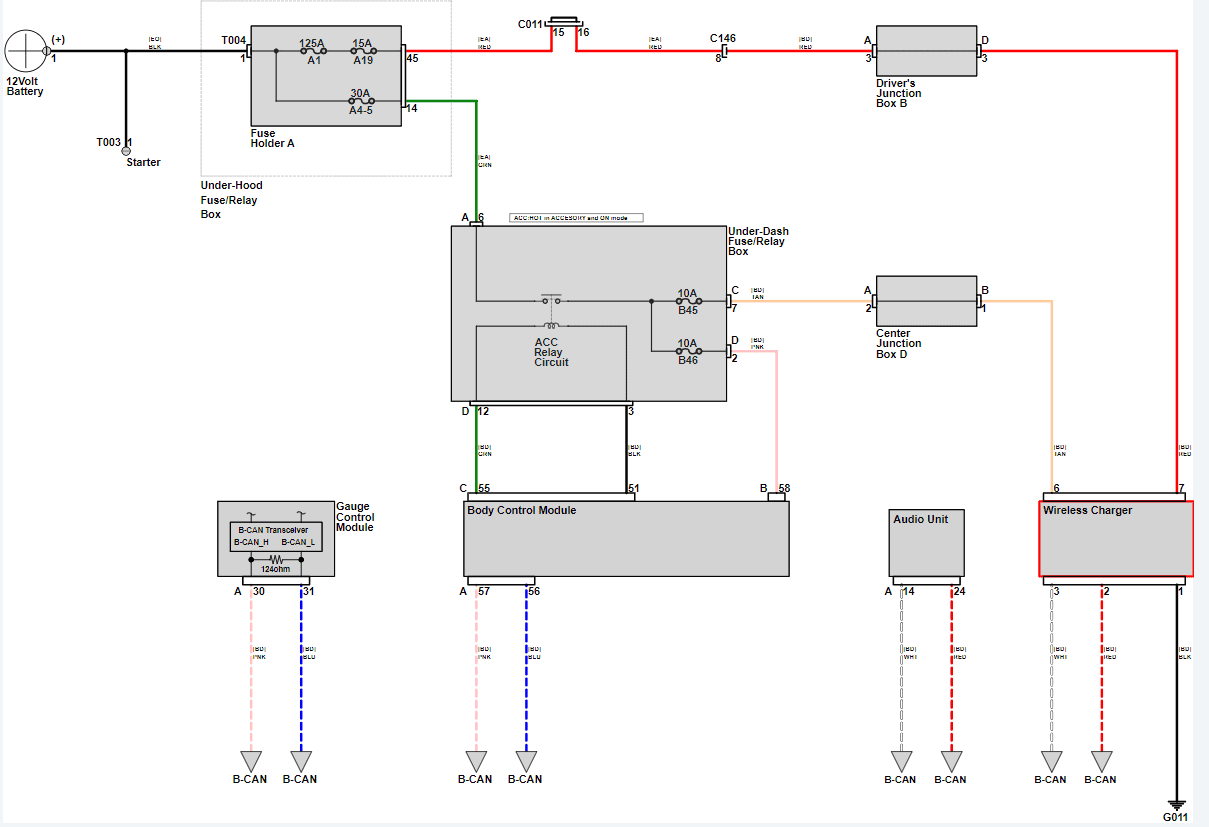

Rob any chance you have the wireless charger Diagram from a 2023 Type-R? I do not want to pay again for that 1 diagram on Honda's wiring site. Any chance you could snag that if you have access
Does this help?

Does this help?
That is 100% of what I need! Thank you!!!!
I installed a FL5 on my '24 Si. I got the MiKStoreShop plug-n-play harness though. I am installing one on a customers car this weekend and no plug-n-play harness so I want to ensure I wire it per the factory requirements, circuit amperage etc.
I must have accidently not grabbed that diagram.. I have almost everything else for the '23 type-r and '24 Si..

I need to get pictures for everyone. I wanted to let everyone know how it is going so far with the cluster. Besides loving it so much, it works perfectly. The alert for ADS is so simple to just scroll and bam it is gone. I can't tell you how much I dislike the OEM Si cluster, the pixels, the lack of full screen just ruin it for me. When I take calls while driving into and from work, it even displays the Outlook meeting name on the cluster. I love the small details. The yellow needles are nice too...
Anyhow I paid 400.00 on ebay for a used cluster with 674 miles I would never go back tot eh SI cluster. I may throw the cluster online for sale or just keep it.
