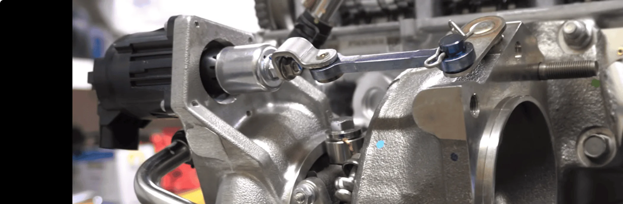

Interesting thread. While it may not be much help, since some have mentioned wastegate noises as a byproduct of turbocharged engines, I can confidently say it’s not common. I’ve had zero wastegate noises in my GRY and my M2C. None. This coming from someone who is meticulous about nvh and highly attuned to any sounds. Such noises would definitely drive me nuts.

I have this exact noise and it drives me nuts. I wish there was a fix. The dumbass dealership said it was a part of my aftermarket exhaust lmao.

Normal my fk8 did it
now my fl5 does it
Makes car sound cheap ass he’ll but it’s the wastegate

I'd describe this more as a scraping noise vs. a squeal (if its the same thing I'm experiencing). At first I thought it was something stuck in the brakes but then I noticed it was every single time I'm off throttle. Sounds like crap. ?

i recognize that sound. that's the wastegate actuator and it's normal to sound like that. I hit the rev limiter pretty hard around 8k miles and it disappeared until i did the CRC IVD Turbo/Intake Valve Cleaner service at 14k miles.

yes exactly, it worried me because I thought it was somethign in the transmission or lsd, so this high pitched metal on metal squealing sound is somehow related to the wastegate actuator? Why does the sound go away when you're not engine braking, or decellerating in gear off throttle.

The Subaru I had prior to the FL5 made the same wastegate rattle. It's normal

I just got a 2025 FL5 and it is making this exact sound. I can live with it if normal, which sounds like it may just be the nature of the beast.
