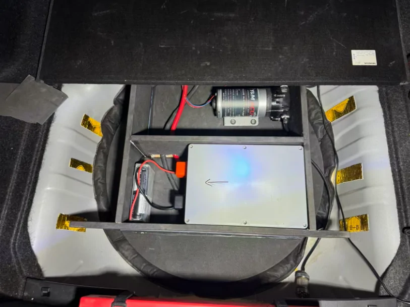

11th Gen Honda Civic 30lb weight saving with LiFePO4 battery - is it worth it? 1782661329734-d9
I assembled a starter battery using lithium cells myself, installed it together with the water injection system’s water pump in the trunk. I removed the spare tire with a DIY partition and offset weight toward the rear via this rear-mounted battery setup to lighten the front end of the vehicle
