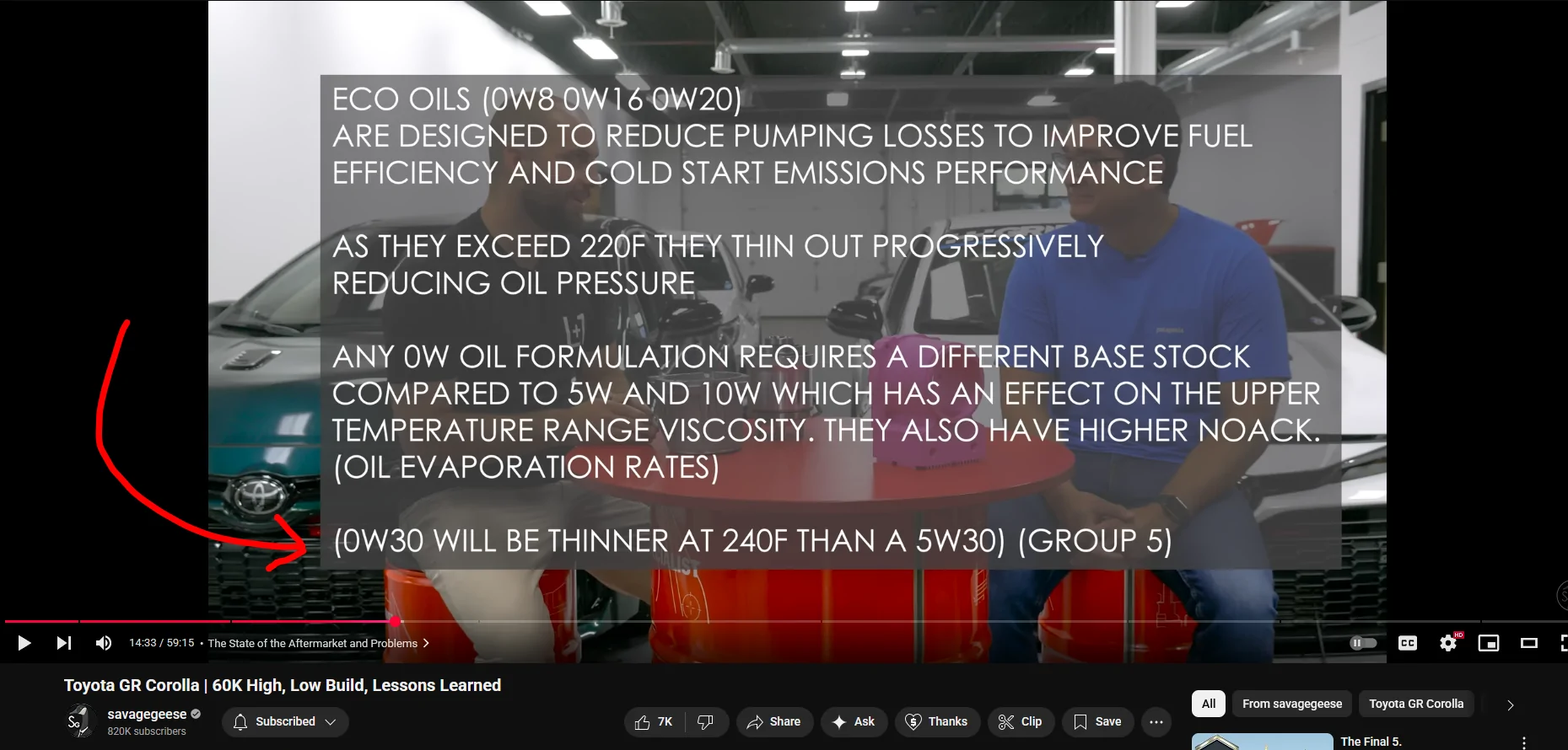

BTW, per Savage Geese and Limit+1 & Engineering Explained, 0W30 will be thinner at high temps than 5W30 because the friction modifiers needed to get to 0W will sheer at higher temps. Just food for thought.
I think you mean Viscosity Index Improvers (VIIs) not friction modifiers.
But yes the point stands, 0W-anything will have a hard time holding up to a good 5W-30.
I run 0W-40 primarily because where I live, temps can and do get down to the -30°F range before the wind chill. The worst thing you can say about a 0W-40 is that it will sheer down to a very thick 0W-30 after a few thousand miles. Not a bad thing if you're aware of it and the situation is right!
If I lived somewhere a bit warmer, I would run a 5W-30 or 5W-40. There are some pretty good 5W-40 oils out there that give you some nice high temp performance without sacrificing all that much cold start protection.
When I had a Shelby GT350, it called for 5W-50 oil. That oil would sheer down to the very top of the 40 range based on the used oil analysis reports, but it also never felt like the engine was having a hard time turning over when I would start it every three weeks or so throughout the winter. Essentially the same engine in the Mustang GT called for 5W-20, but the GT350 came with a gas guzzler tax and the GT did not. Food for thought!
