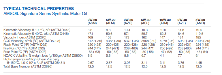

I've done 2 HPDEs and oil temps have reached temporarily 275F which is quite high but not sustained. I live in a very hot tropical climate with 90+F ambient temperature on track days. I've been researching into which oil viscosity to use but there's so much conflicting information out there that I don't know which way is up. I'm currently using AMSOIL signature series oil 0W-20.
For example, some of the technical data is counterintuitive on this AMSOIL data sheet, such as:
  • Some lower weight oils having higher viscosity indexes than heavier weights (0W-20 higher than 5W-20), although my understanding is that 5W-20 is actually somewhat better in high temps than 0W-20 (although same high temperature 20 rating).
  • Same issue with NOACK volatility % weight loss (5W-20 having less volatility than 0W-30)
I would assume Hight-Temperature/High-Shear Viscosity is one of the most important data points but then again, I'm not entirely sure, this data point follows what one would expect in terms of having higher value in direct proportion to higher weight.
According to these data in the table, which would you chose? Which property is more significant or important for our K20C1 for occasional heavy track use and high temps?

Given your climate, and how high you run your oil temps to, I would run a higher viscosity, Mobil 1 0w40 supercar would be a great choice. It's more like a 0w30 viscosity wise and is a med-low SAPS oil, which helps with build up on DI engines. It's also got HTHS of around 3.5.

I am currently running 0W30 Motul 8100 and have done lab tests on this against Honda LEO 0W20 with no discernable differences in engine wear (used both oils on track). I would say either is fine, the Honda LEO oil has a better additive package than the Motul.

You can use a 40 weight no problem. But it you want to keep it closer to spec. Just do 5w-30 which is what I’m doing and tracking the car also.

I think you can't go wrong with a 30 or 40w, what's more important is to monitor your oil levels and make sure to change your oil more frequently.
