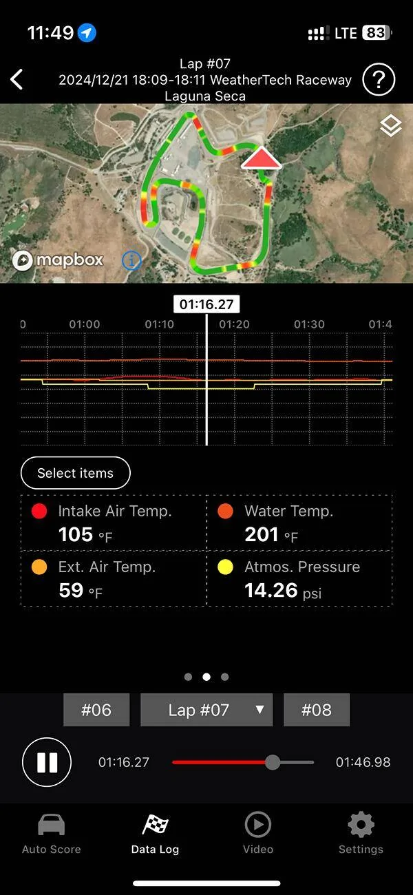

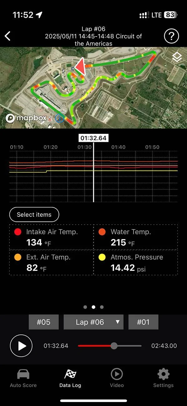

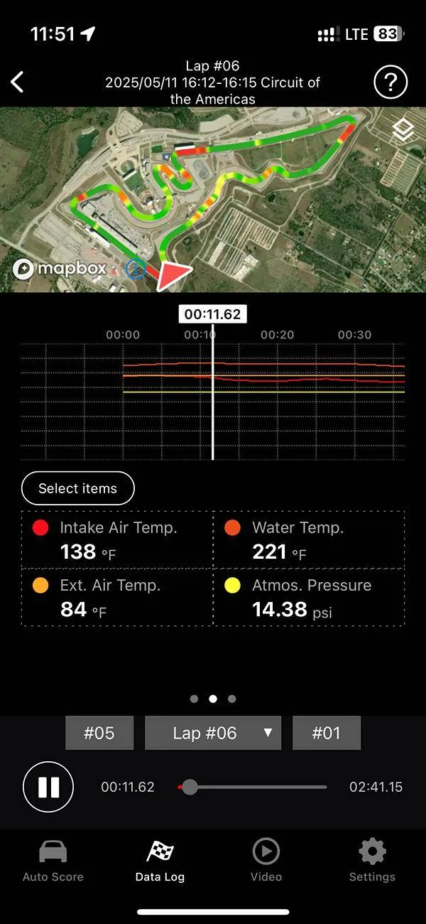

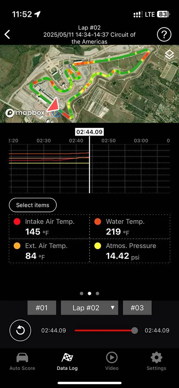

I showed him my water temps, he said the car is running very cool, and no issues with overheating on both COTA and Laguna.
Regarding engine oil, he said, the same, follow the data.
He would not mess with it, if I'm getting those results, and engine is running cool.
I will probably try 5w-30 Motul 300V or Pennzoil Ultra Platinum just to prove the oil temp and engine water temp theory. Will moving up to a 5w-30 increase engine temps on a stock car. The experts say yes it will run hotter, the community says it's better protection.
Regarding, the oil cooler - HEL Performance Thermostatic Oil Cooler - He had the same results as my friend who realized the oil cooler didn't help much if any, due to the location is in front of the radiator. Both moved to side mount dual oil coolers. Jason's at about 450hp.
I'm only seeing a max temp of 221F on my hottest day at COTA.

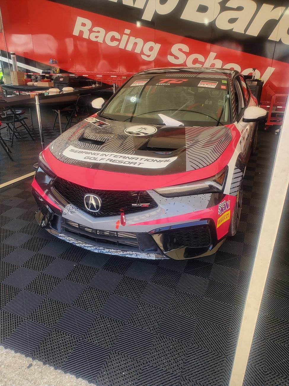

Great photo! You look so thrilled to be sitting in this car. The proverbial "kid in a candy store".
Haha yes. When I finally found it I was super excited. He actually had a DNF because he hit the wall and popped his tire early in the race. I actually was looking to see it but never saw it on the track, and didn't know what happened
I think the driver could tell I was excited so thats why he let me climbed in and showed me how everything works inside.
Very cool and fun experience. They were the only Race Team out there with the Integra Type S. Everything else was a GRC or the Elantra N
