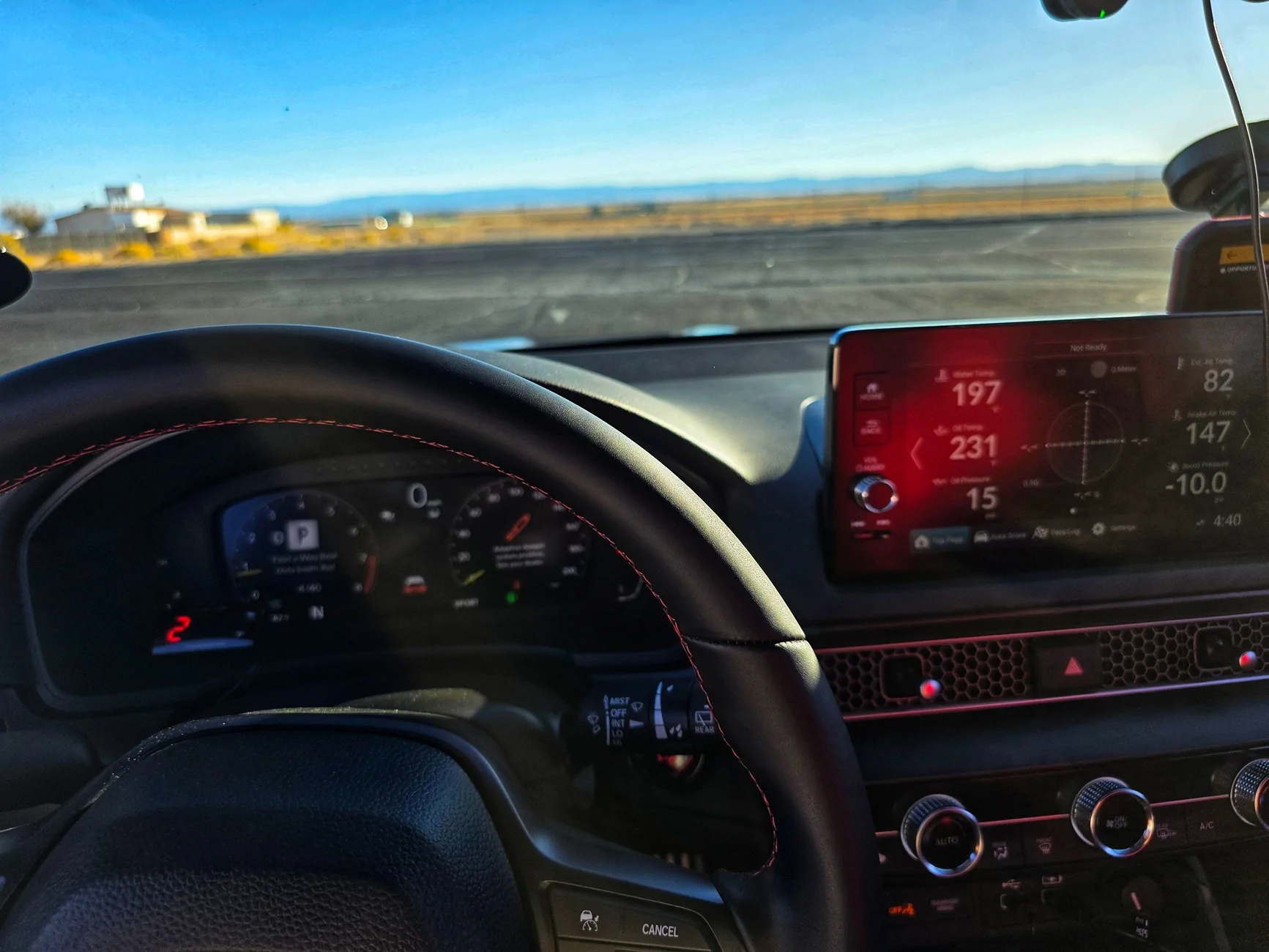

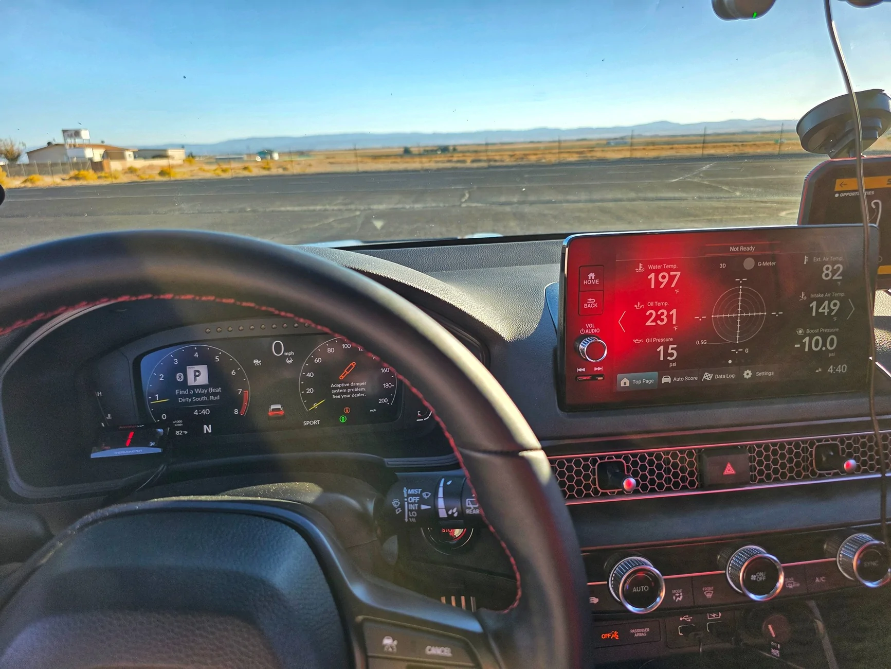

You’re running 10W-30 and 10W-40 on track without overheating to 240F+ water temps?
What are your maximum coolant (water) temps and oil temps? What’s the ambient temperature? Are these 20–25 minute sessions? Is the engine/cooling stock or modified?
Please share data—ideally LogR screenshots showing max coolant temp with ambient temperature noted. Many thanks!
This was recorded today after 14 laps. The LOG R shows 82 F ambient temperature, 197 F water temp, and 231 F oil temp. Pay attention to the left-side gauge, it’s blinking, but it actually indicates 212 F. That’s the true temperature of the engine oil circulating through the oil cooler. I also have a WOT PWR triple pass radiator and a transmission oil cooler installed.
There was another guy at the track running a E85 tune but without as many cooling mods as I have. He said his oil temps were hitting the high 260s F

Thanks, that's great data and information. You have serious cooling. Confirms if you go to thicker oil, move up the cooling to complement. I'll test 0W-20 vs 5w-30 at COTA next week on completely stock car and record temps.
