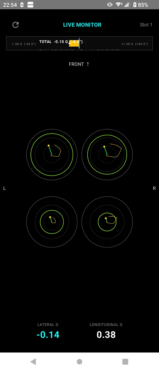

I'm an FK8 owner and I’ve been developing a smartphone app that calculates and displays individual friction circles (G‑G diagrams) and G‑vectors for all four wheels, instead of a single combined one.
This screenshot shows the moment when the vehicle goes from a left turn to a right turn in an S-curve. The vehicle's weight is shifted to the left, and the friction circle appears to be larger on the left side.
11th Gen Honda Civic 4-wheel friction circle and Tire vector visualizer Screenshot_20260121-225449

How does the app connect to the vehicle and receive information?
Thanks message.
It does not connect to the vehicle in any way.
The app uses only the smartphone’s built-in sensors and does not communicate with the vehicle.
I infer vehicle behavior from the phone’s accelerometer data using filtering and condition-based logic, with the gyroscope used to confirm certain states.
I avoid relying on OBD vehicle data because its latency and slow update rate often mean that what you see on-screen lags behind what you feel in real time.

Sounds good. Ill try to remember to bring this other device with me next time i drive to get you some data. I changed the weight, tread, wheelbase and everything in there to the proper numbers. I am not sure what you are wanting for "accel traction split". Also are you wanting something to be put in for the tire & grip saturation area?
hirotaka_k
Hirotaka
Jan 27, 2026
Japan
FK8
Thanks for trying t app and feedback!
Accel traction split
From the measured acceleration, the app cannot determine whether the driving force is from the front, rear, or all wheels.
This setting lets you specify that.
Far left = FWD mode.
Tire μ
A typical value is around 1.0–1.3.
Grip saturation
This is roughly the G level where the tires start to slip (for example during braking).
Try around 1.0 g.
Drop rate
After the tire starts to slide, try about a 30% drop in grip.
These are just starting values, so feel free to adjust and see what matches your car best.
