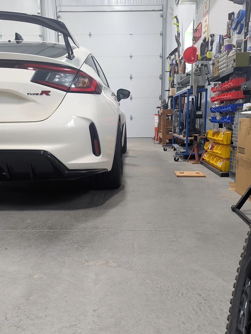

I'm running Titan7 18x10.7 +55 ("stig spec" lol) with 275/35 V730. The 295/30r18 v730 is what I'll get next, they weren't out yet when I bought these. I agree with others that the v730 is the best bang for the buck track tire and it deals well if you're camber limited like me (stock with pins pulled).
