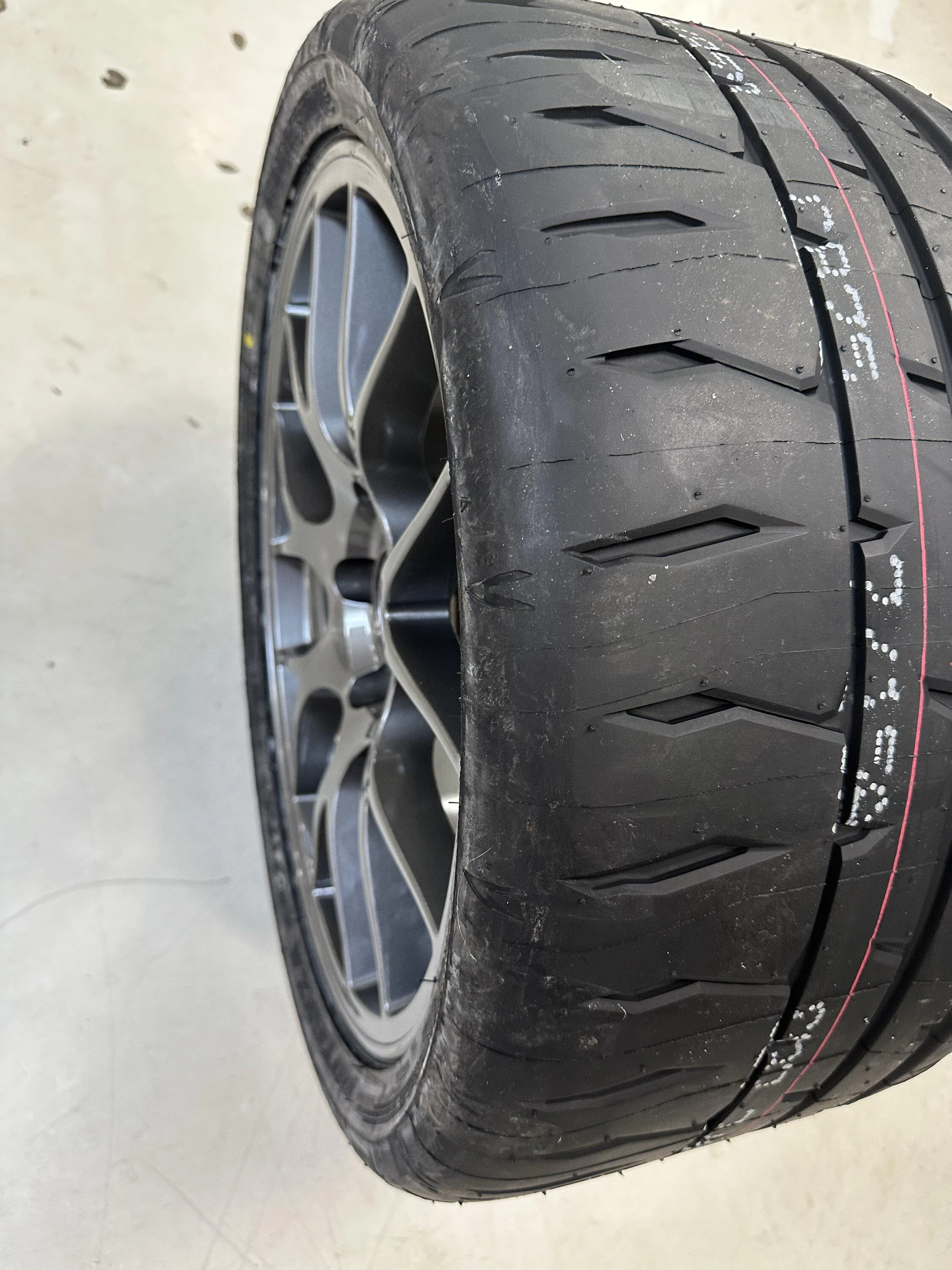

That's insane. So who will be the first with driving around on 305s?
Bridgestone doesnt make one sadly, but... falken makes a 315...... lol

How would that influence the driving dynamics if you were to drive it on a track? Aren't bigger tires better because you get more grip?
yes and no. you go too large the sidewall becomes floppy and you gone get a good feel for the tire. at the same time it can be harder to get heat into them.

I guess at some point, you reach a point of diminishing returns and you're just adding more unsprung weight. Probably hurt acceleration in the straights too.

So what's the optimal size then? Im guessing just OEM?
Also is doing a staggered stance better?

It seems 275 or maybe 285 is max for a 9.5" wheel.

Looks wise i think a 285, but for autocross we are fighting short gearing. this 285/35 would help extend second by a bit.

You weigh that setup? 295s on a stock Civic what a time to be alive ?
I knew someone would ask that and I didn't check lol

Mine tramline a little on the stock setup. I can’t imagine wider. 911 territory ?.

11th Gen Honda Civic 295/35/18 tires fit C9A0B23A-FA3D-4B44-9DA4-9D2113A1E3A9
Took a lot of lube and about 80psi to pop the bead but 295/30/18 re71rs will be the size I’m starting with this season :)
