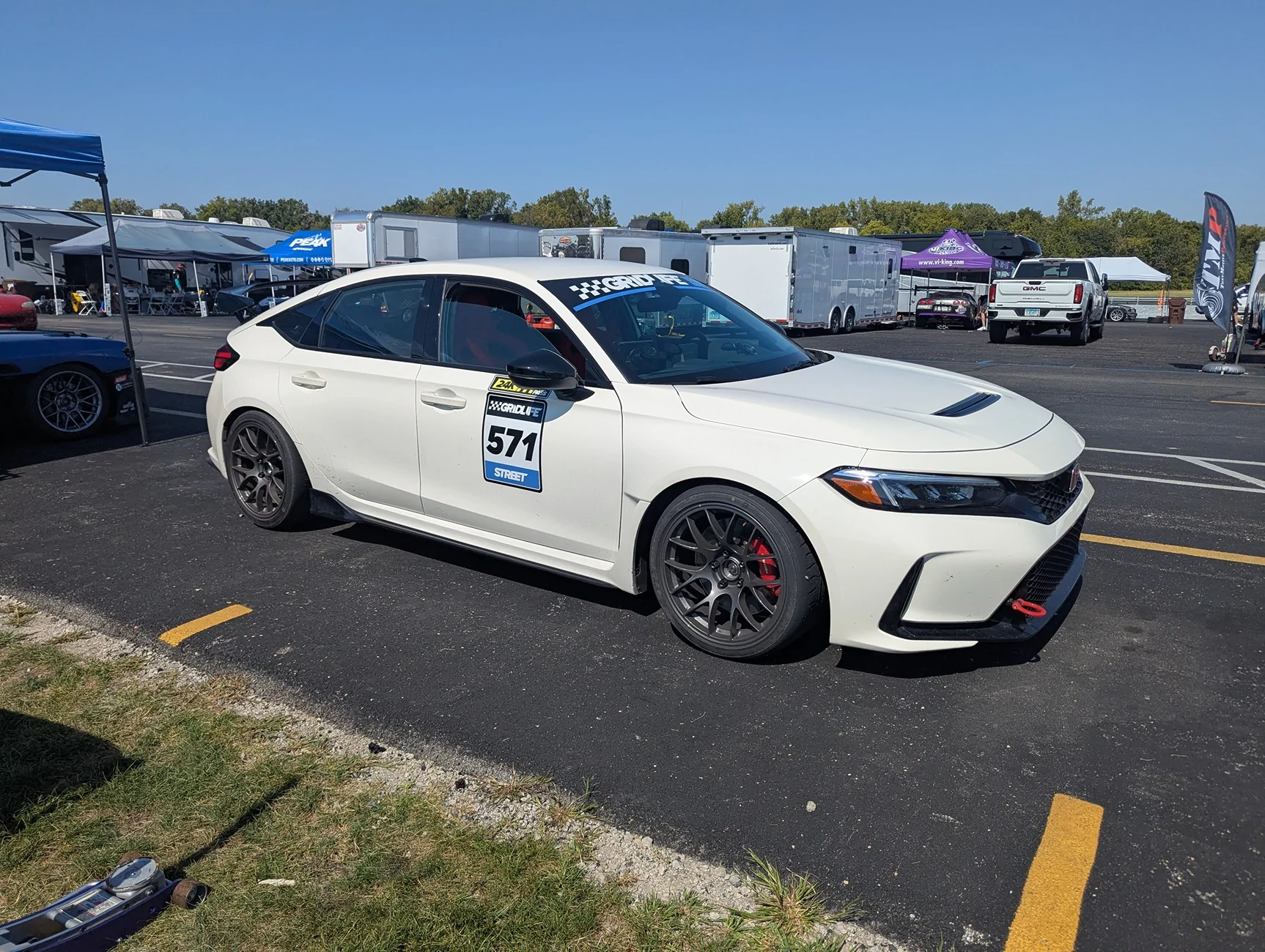

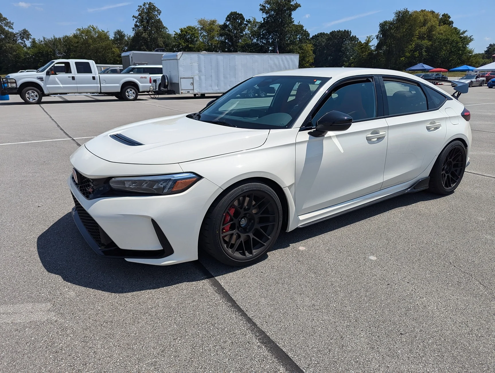

I ran 285/30R18 square on 18x11 ET44 stock w/pins pulled, with lowering springs/camber plates, and on coilovers (I only ran ~-2.75° front camber also). I had no issues with rubbing on either stock shock configuration, and on coilovers the only potential issue is slight interference with the strut ears against the inside wheel barrel ID only at full lock as the wheel articulates in (strut-design specific), so you can get slight rubbing (or just don't go full lock and/or install steering limiters) - really only an issue maneuvering the car at low speeds (ie, parking).
Lowering springs:
11th Gen Honda Civic 285–295 Tire Setup – Wheel Specs & Fitment? PXL_20240825_172216605
Coilovers / reverse stagger:
11th Gen Honda Civic 285–295 Tire Setup – Wheel Specs & Fitment? PXL_20250914_185255290
https://apexwheels.com/wheels/flow-...0mm-or-7256mm&frontQty=1&frontSize=18x11-et44
The car performed better with 255/35R18 on 18x9.5 ET35 in the back (reverse stagger), but it still worked well square.
