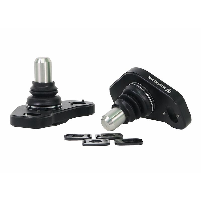

Sorry if I am bringing this back but just re-read this thread
So why has hardrace switched their design on the ball joints? As I understand this was the old design
11th Gen Honda Civic Stock Front Camber and tire wear on track 1731071691084-8a
and now their design is the same as the same as whiteline and I guess EVS which has the pins and the little plates sit on top
11th Gen Honda Civic Stock Front Camber and tire wear on track 1731071782853-
I guess no one has issues with the new version? (I remember seeing a thread about someone having an issue with the pins or plates deforming or racking). The other version just seems so much better

Hard race doesn't use those pins any longer. I have read about the EVS ball joints on other platforms wearing out fast, so that's why I chose the hard race ones
thank you BigBird!
I was confused, some sites still show the hardraces as the pin design but right before you posted I checked their site and shows the updated design (I am not an engineer by any means and this just looks to be such a much better design, I did not like that pin design at all, I guess maybe it makes for changing camber easier but that does not matter for most)
