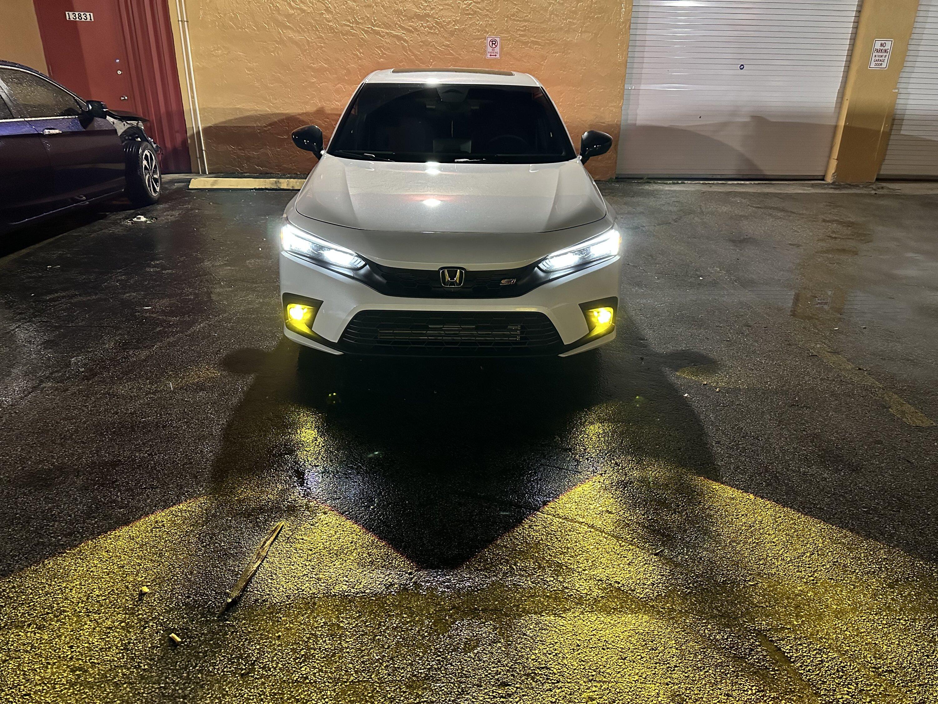

I just installed these a couple days ago. Works great. I skipped installing the switch and left the lights on Auto.
Hey man which ones from that site did you buy and did it come with the switch??

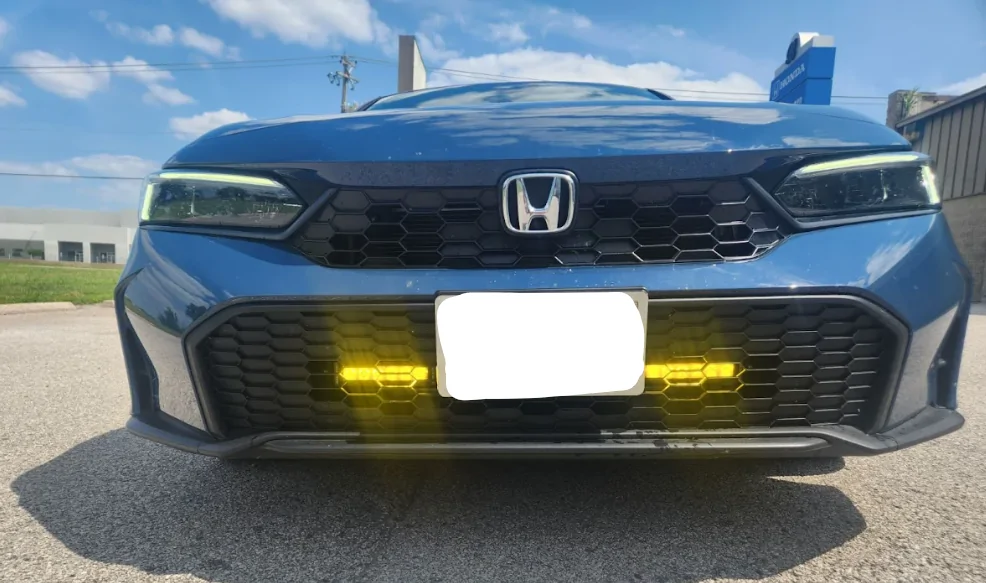

I asked Diode Dynamics for recommendation:
I myself had a '22 Sport Sedan (Not nearly the same in terms of performance, but identical for the front crash bar!) and mounted some of our SS6 lightbars directly to the bottom of the crash bar. (The front crash bar has a thin sort of 'shelf' along the back edge that you can drill right through, and mount lights directly to!) I also did this same install on a '25 Sport Sedan, and it worked the same way:
11th Gen Honda Civic Anyone add the Canadian fogs to the US version? Diode Dynamics on 2025 Civic Sport
For that install, I used the lights we offer, plus their standard harness, and this Honda-style switch from Amazon​
