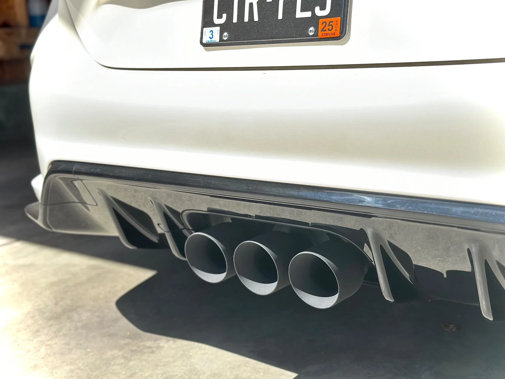

Hope it’s helpful! I spent a year going back-and-forth on getting an exhaust or not and this $200 stock mod is fantastic. One huge thing I realized too … I was going to go with the AWE touring - but - having the valve still in place is amazing so I don’t have to listen to louder all the time and can choose. I also recommend painting everything matte black underneath so you don’t have silver guts behind the black tips.
One thing I wish somebody made is 4.5” OD tips with 2.5” inlet only 5 inches long (instead of 7-9” which would stick out huge, it’s cramped down there). Would be cooler to get a little bit bigger OD, but the biggest outer tips I could find short enough with 2.5” inlet was 4” OD tips. Car is dirty but here’s a pic.
I quite like the silver tips because black tips can sometimes get lost in the diffuser depending on lighting and distance. But looks great regardless.
