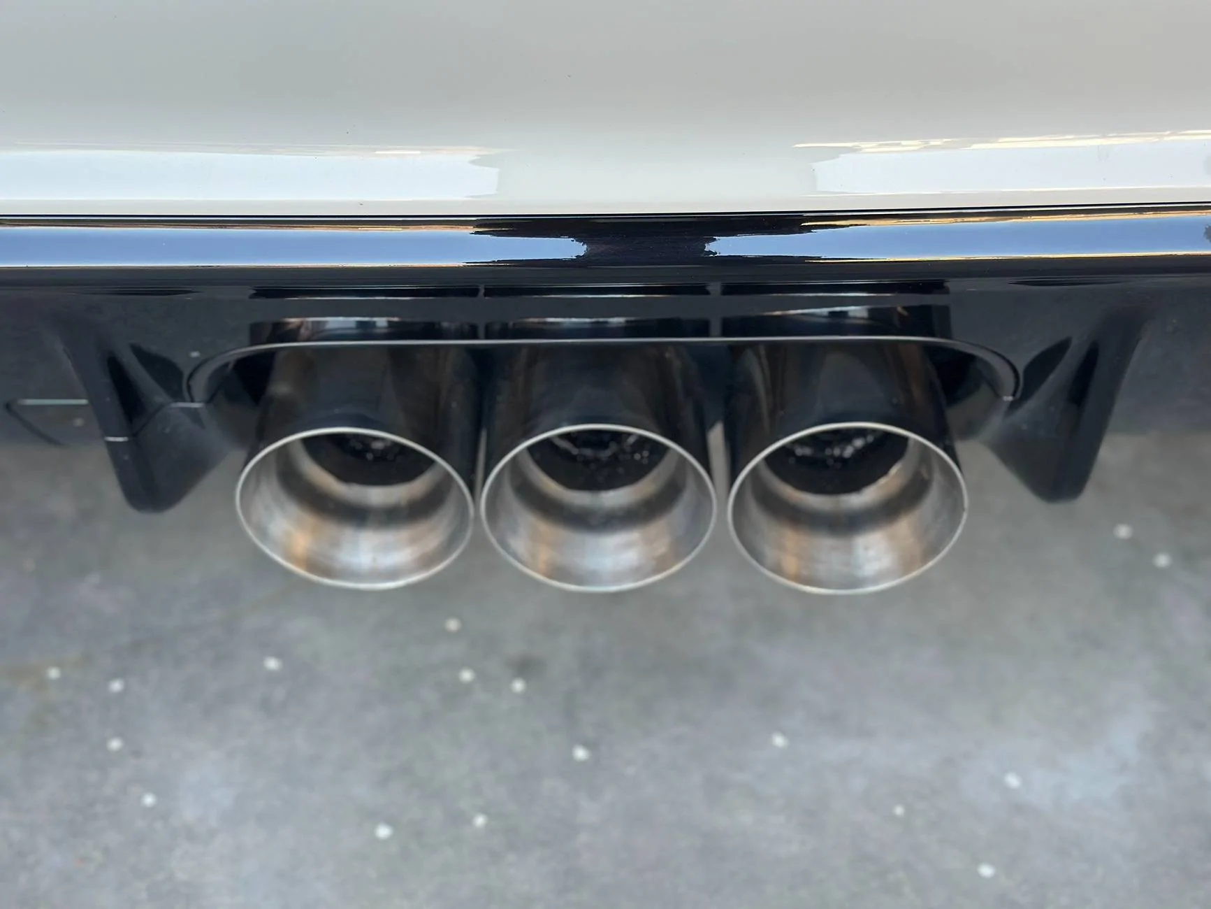

Hope it’s helpful! I spent a year going back-and-forth on getting an exhaust or not and this $200 stock mod is fantastic. One huge thing I realized too … I was going to go with the AWE touring - but - having the valve still in place is amazing so I don’t have to listen to louder all the time and can choose. I also recommend painting everything matte black underneath so you don’t have silver guts behind the black tips.
One thing I wish somebody made is 4.5” OD tips with 2.5” inlet only 5 inches long (instead of 7-9” which would stick out huge, it’s cramped down there). Would be cooler to get a little bit bigger OD, but the biggest outer tips I could find short enough with 2.5” inlet was 4” OD tips. Car is dirty but here’s a pic.

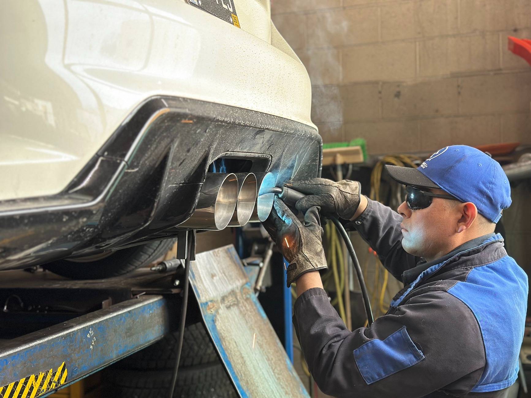

Had mine done this week at a local shop. Dual delete and bought the polished versions of the tips from Amazon. Happy with how it turned out. Comfort mode its just a little louder overall and when switching to Sport or R+ it is noticeably louder even in the lower rev ranges. Haven't done to much highway yet but I'll probably keep it in comfort during those cases.
Couple of notes on the exhaust tips that the shop talked me through. Since the middle muffler is longer then the sides, to get all 3 to match up evenly they had to extend out the tips just a bit with couplers, probably about an inch. They don't stick out past the bumper so no risk of accidentally touching if you are near the trunk but you can tell they are a little further out.

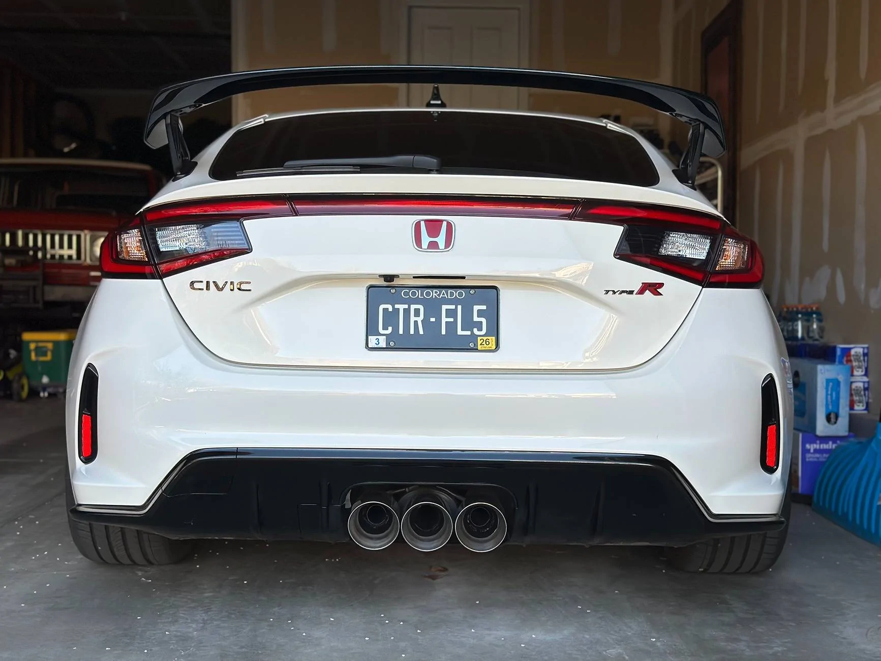

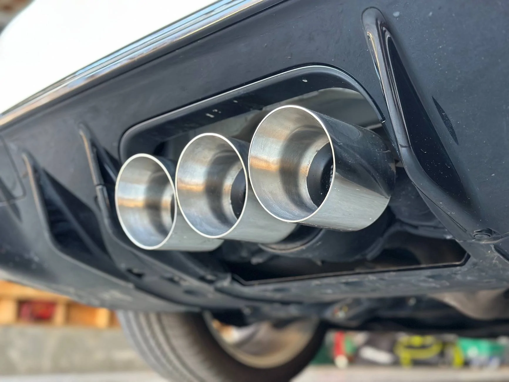

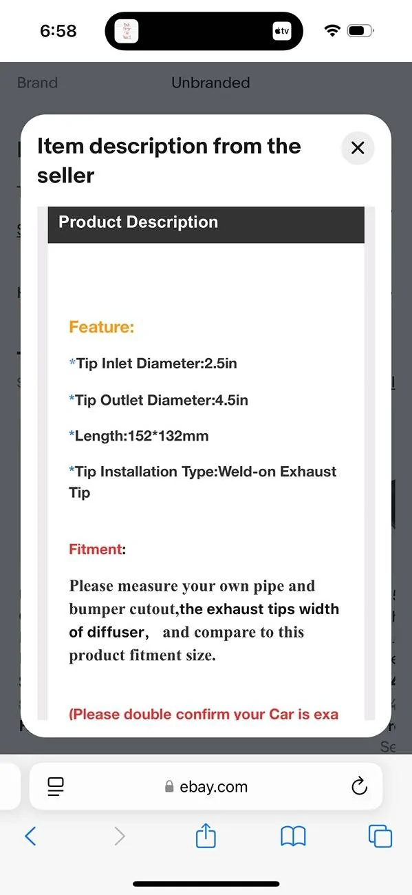

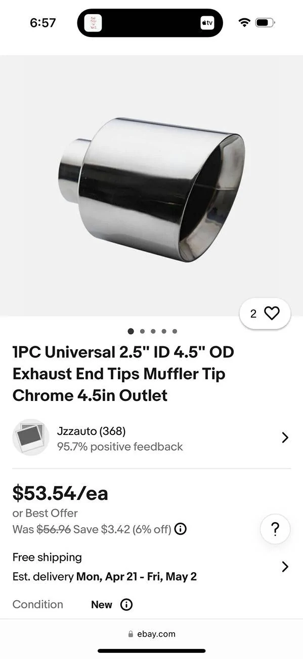

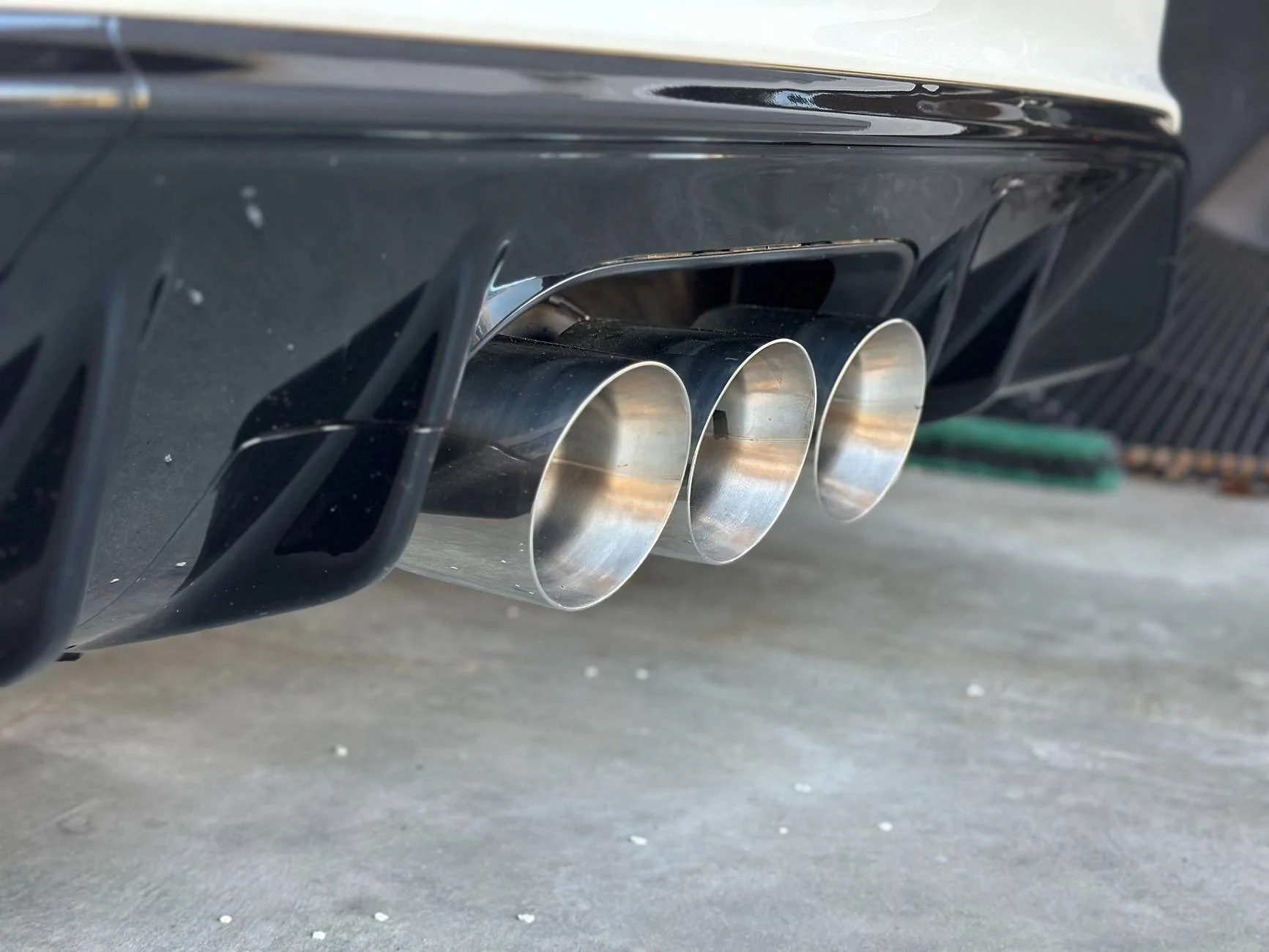

FINALLY... THREE 4.5" OD EXHAUST TIP VICTORY!!!
After searching forever for tips that would work (you can read previous threads) I took a gamble and finally found the winner for me - some new tips that just came out from China that are 2.5" ID, 4.5" OD and 6" long total (all other 4.5" OD tips are like 7-8" long and would stick out way too much). Here's the ebay link (it was super fast shipping, actually really impressive) and my local shop replaced the old black 4" OD aftermarket tips I tried last with these and he did a great job getting them tucked under the car enough so they don't stick out as much as others. These come in black as well, I decided to go back to chrome and I taped off and spraypainted the very inside of the tips black to cover up all the inner welding, etc. since outer pipes need a 2" to 2.5" stepup, etc. I also feel like when driving - these 4.5" are a little more full with less "rasp" than the 4" ones when the valve opens up.
LINK TO CHROME TIPS:
https://www.ebay.com/itm/404909645949
