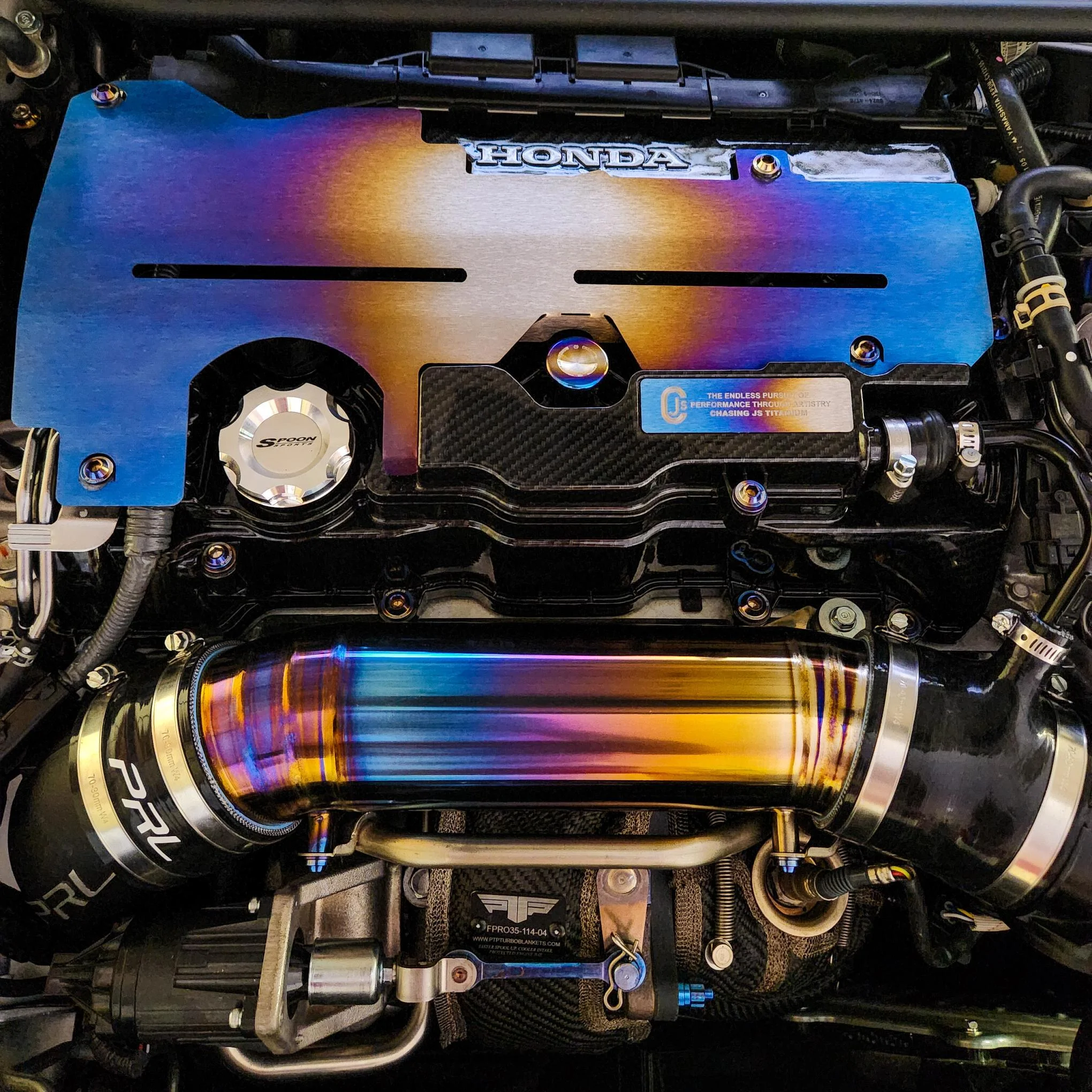

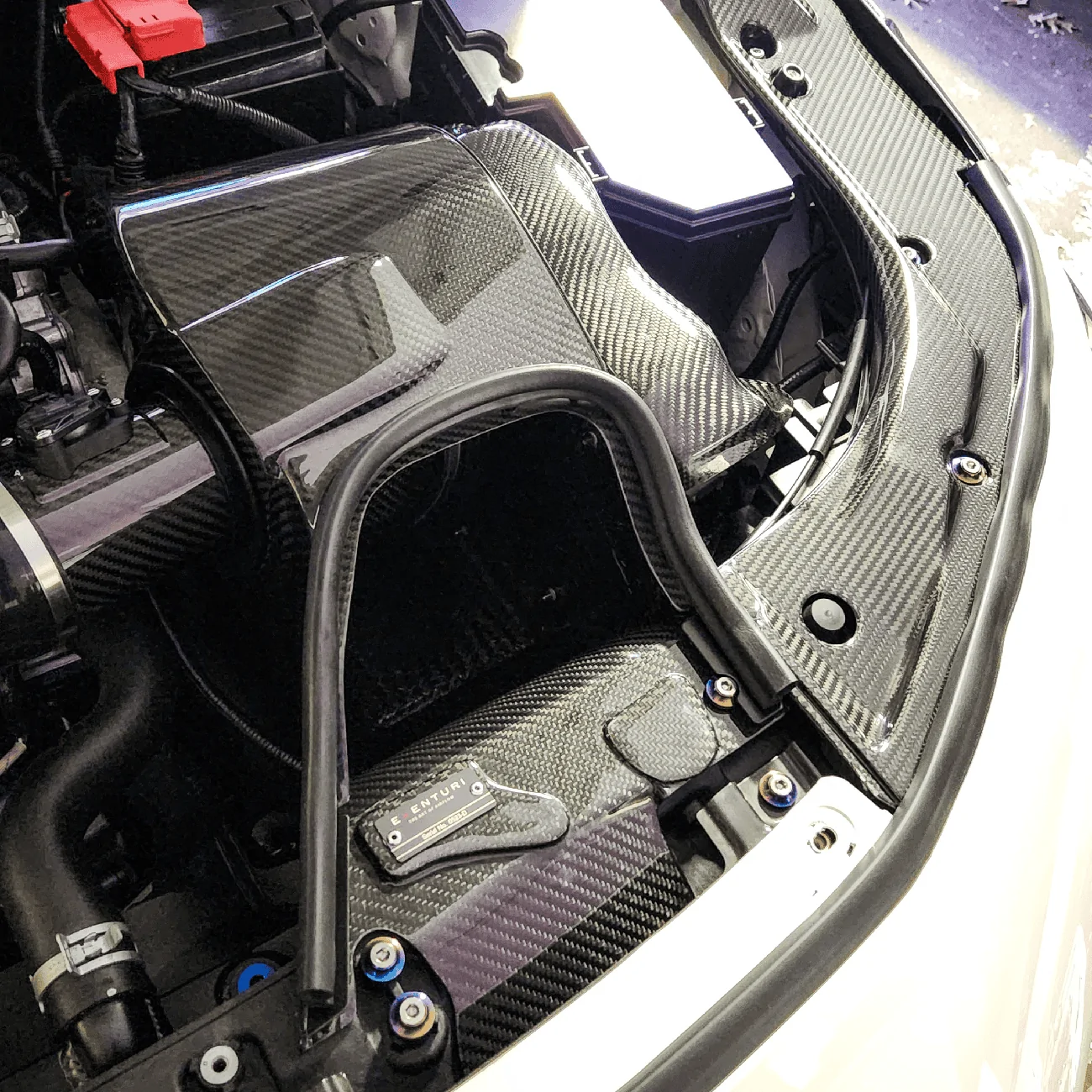

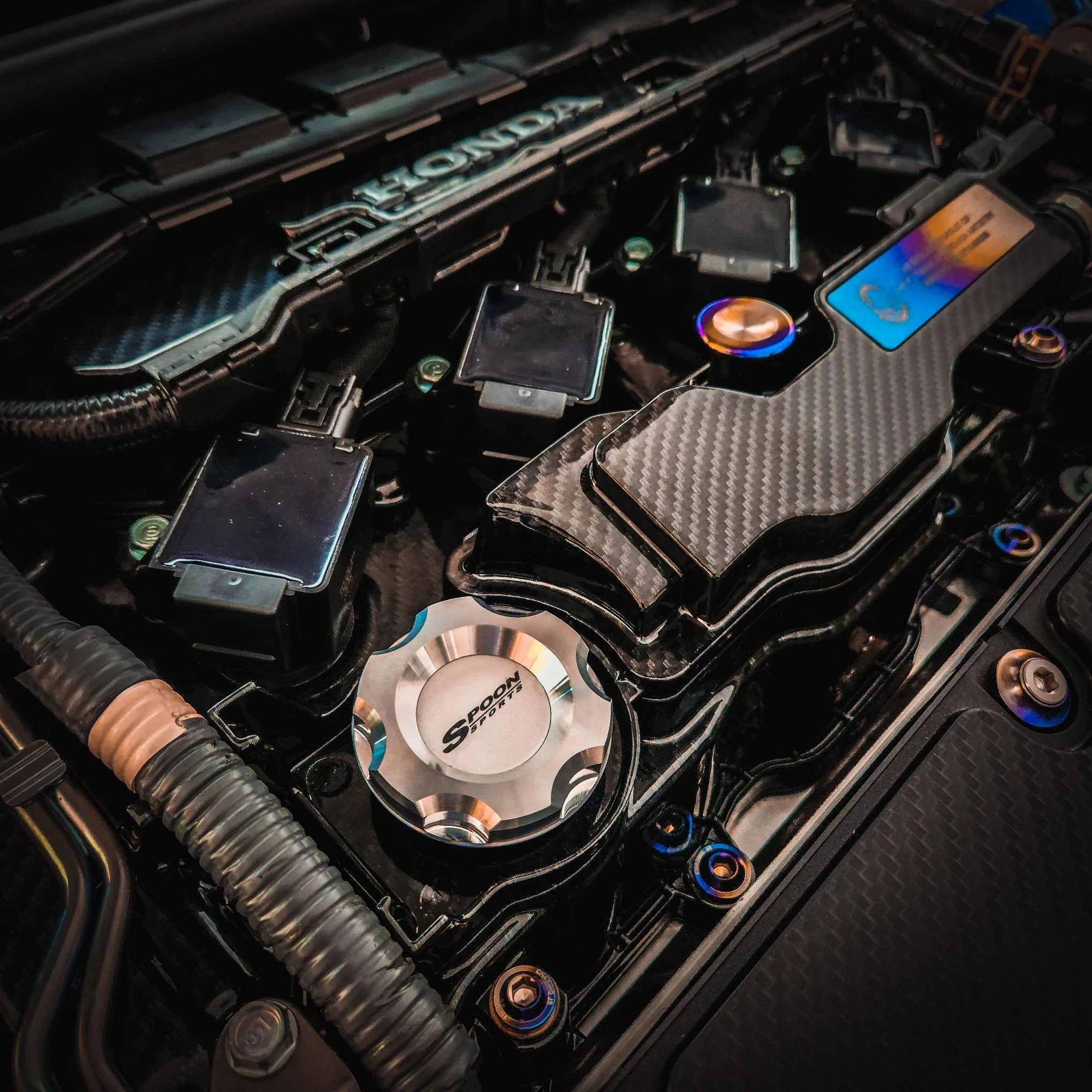

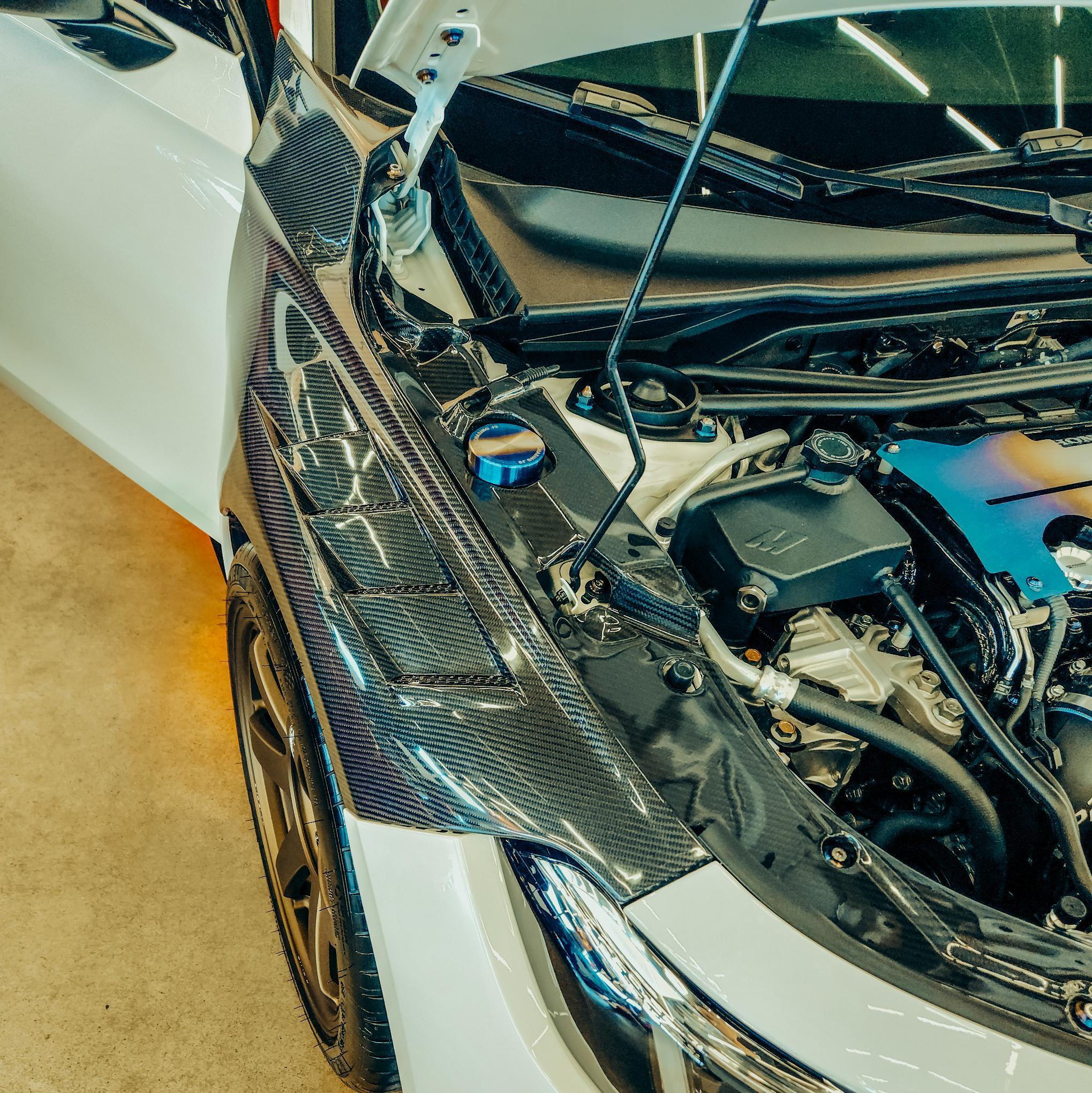

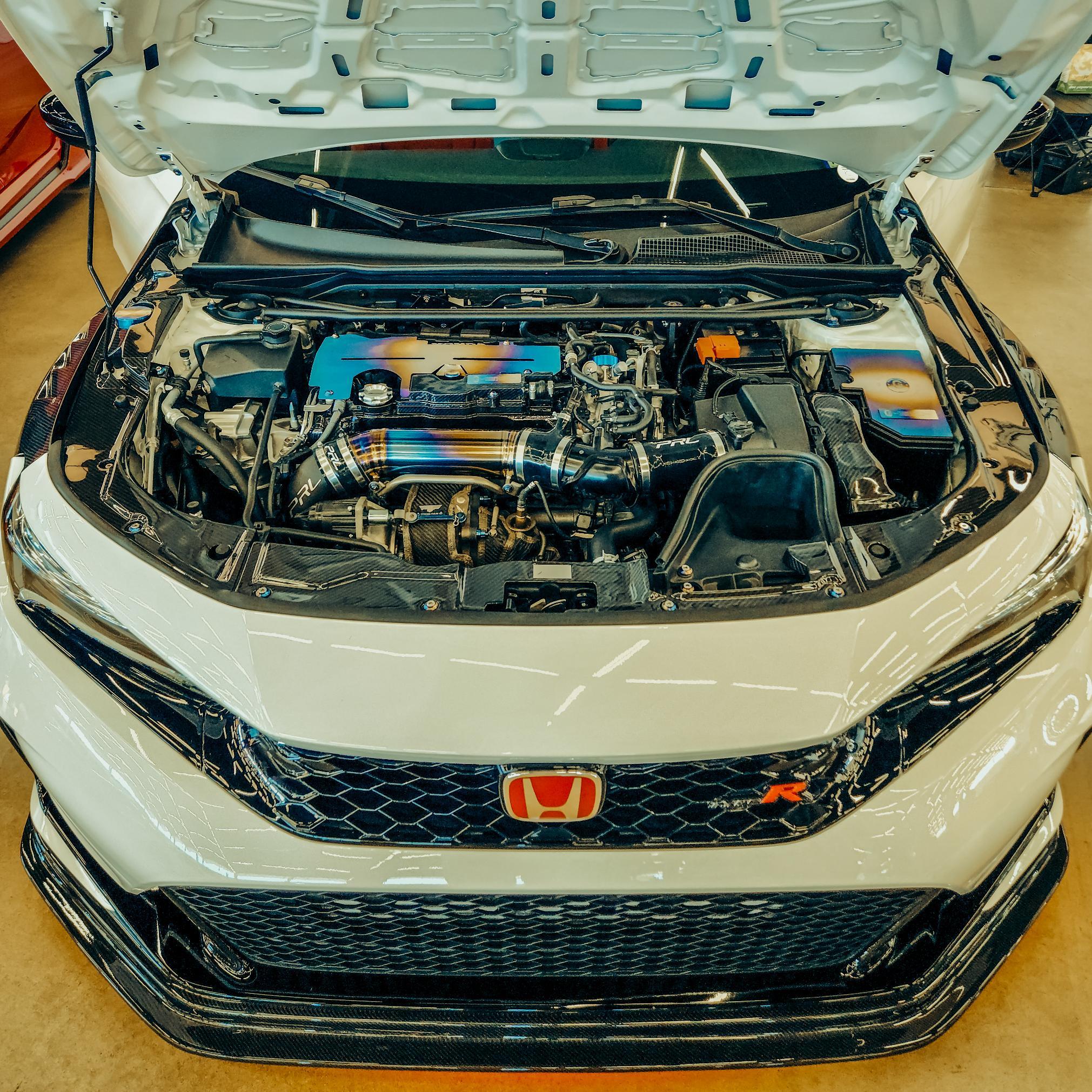

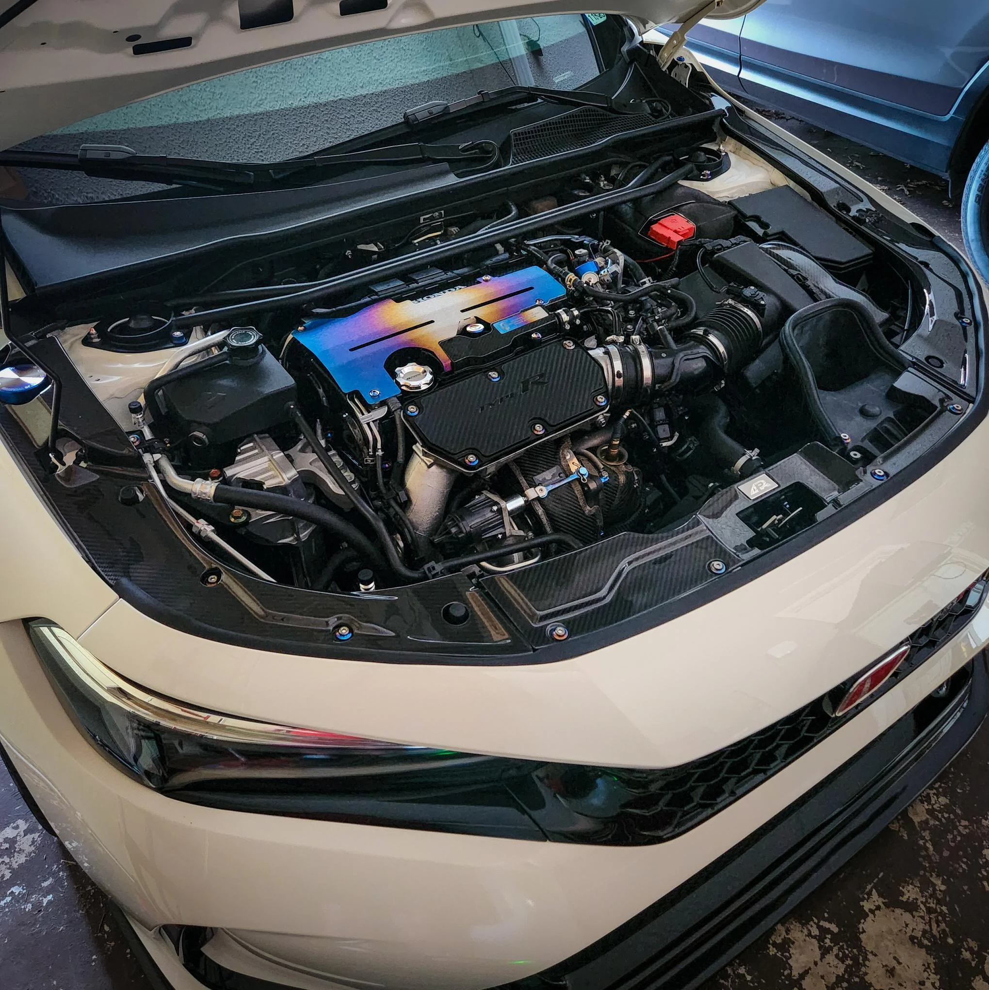

Engine bay coming together, waiting a few more parts.
APR carbon side shrouds installed

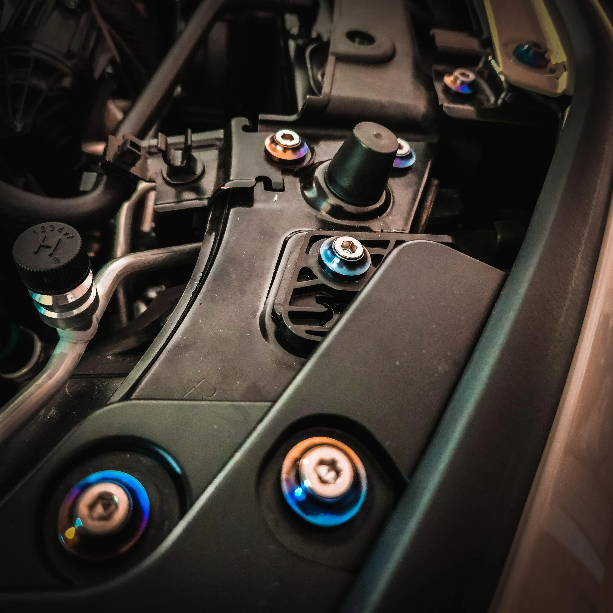

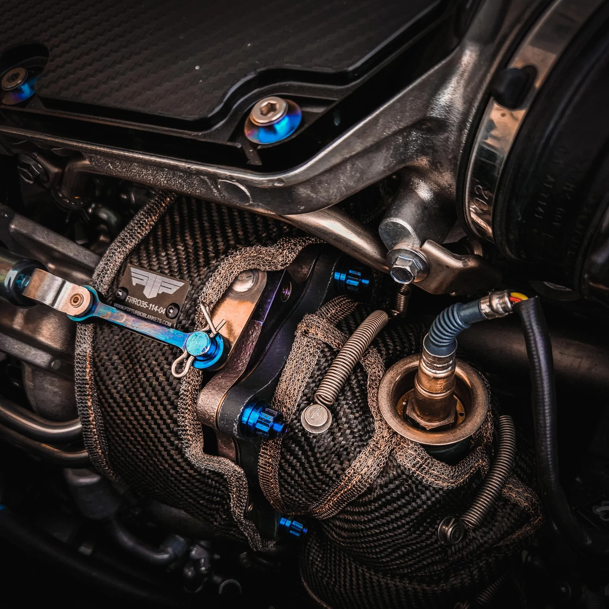

Valve cover and Chasing J's titanium hardware
Downstar titanium bolts
@Two Step Performance black cerakote dp, PTP black lava blankets, and Rampage anodized titanium studs (with a broken stud that was a PITA to extract)
PWR / C&R radiator (sorry for the POS tape)

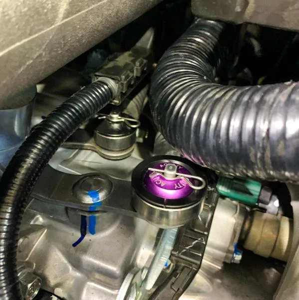

@ACUITY shifter cable bushings

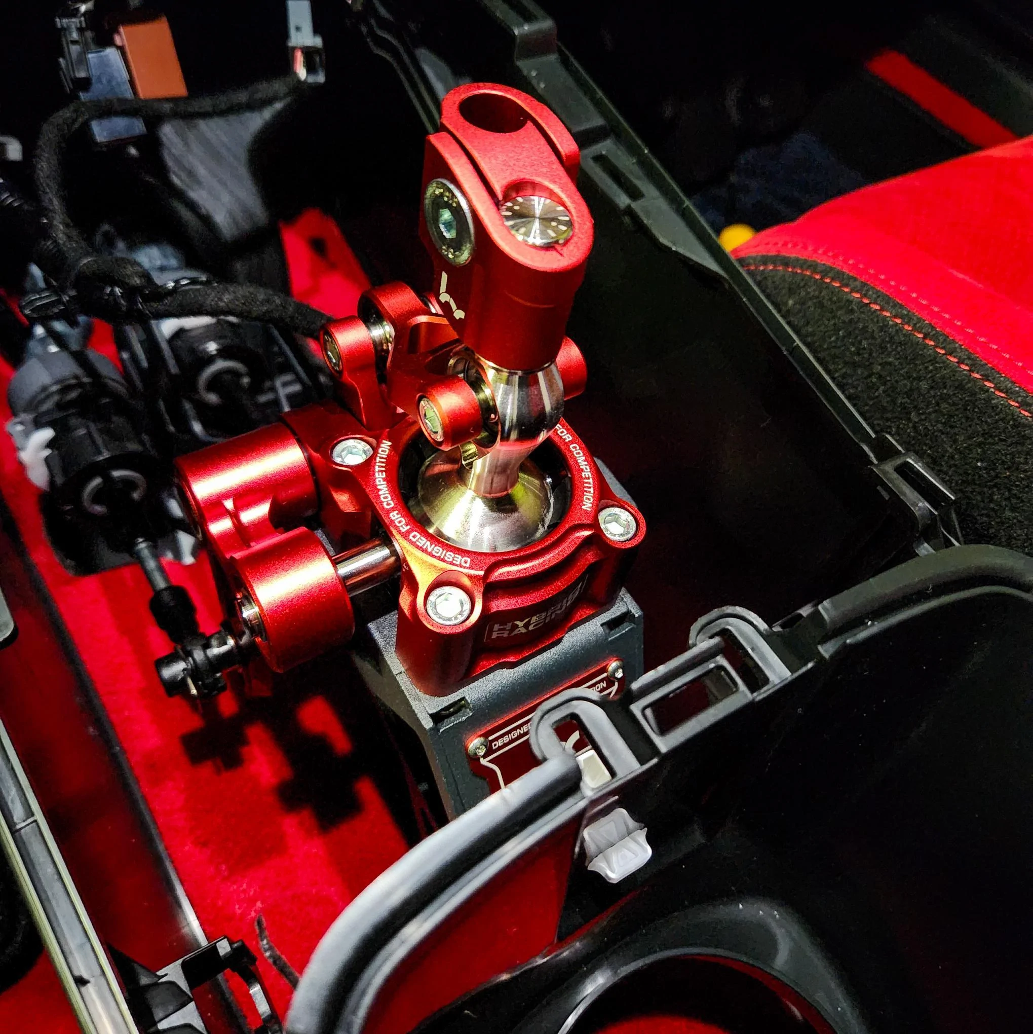

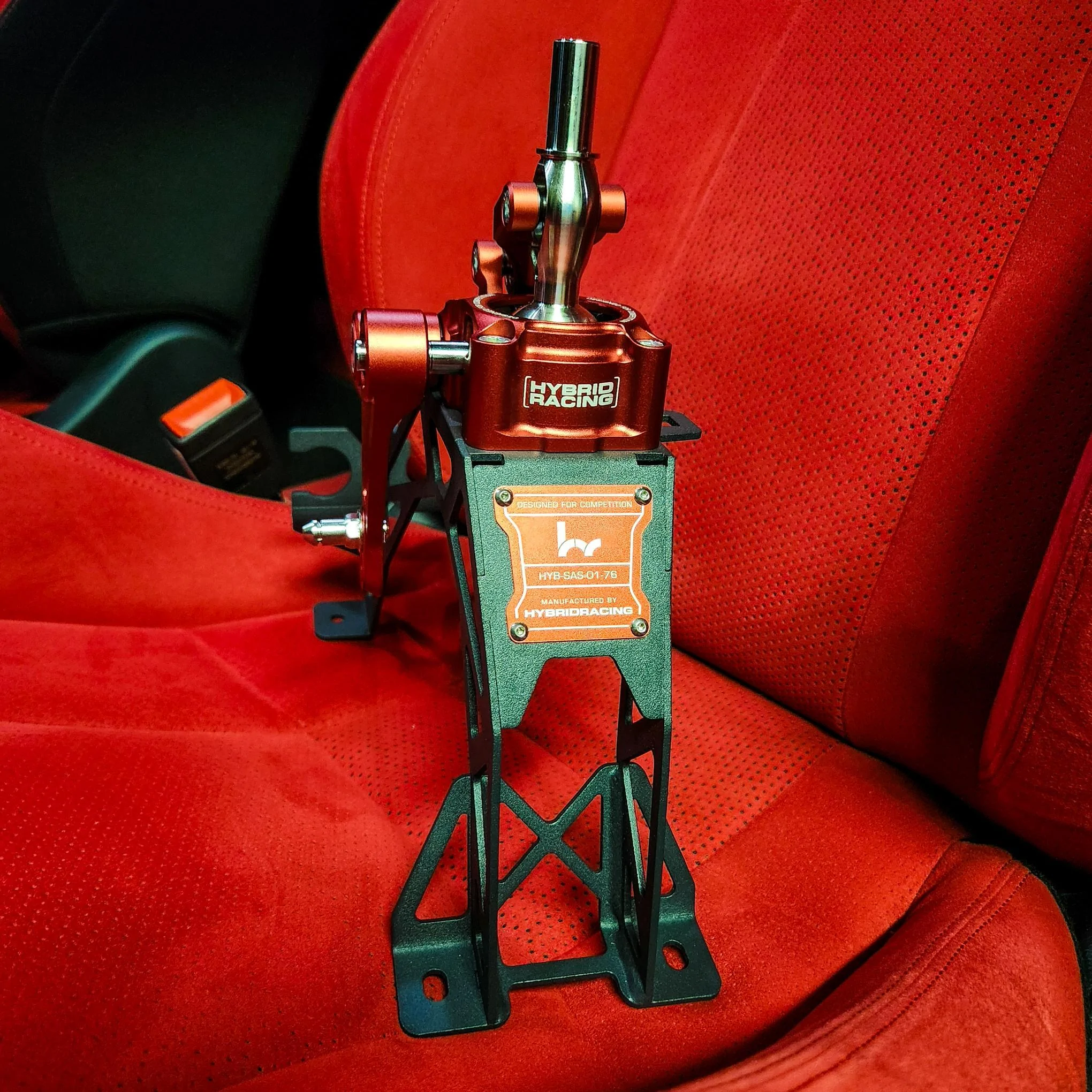

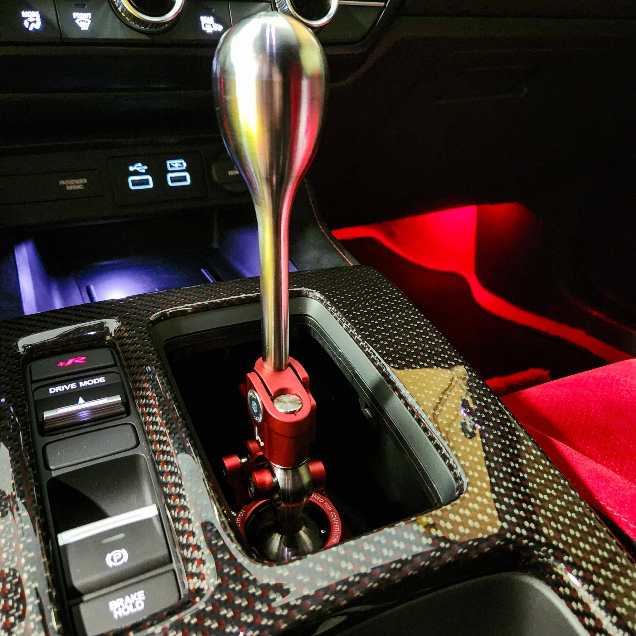

Hybrid Racing short shifter and competition rod:
Outside of the retaining clips for the shifter cables, installation is pretty straight forward. Currently set to their recommended settings (15% decrease in L-R and 25% decrease in F-B) but will test out the higher option in the coming weeks (30% decrease in L-R and 50% decrease in F-B) to see most preferred option. It does come with a threaded option if you want to run a normal shift knob and you can also retain the shift boot if you want. The competition rod is not threaded so a shift boot collar will not work.

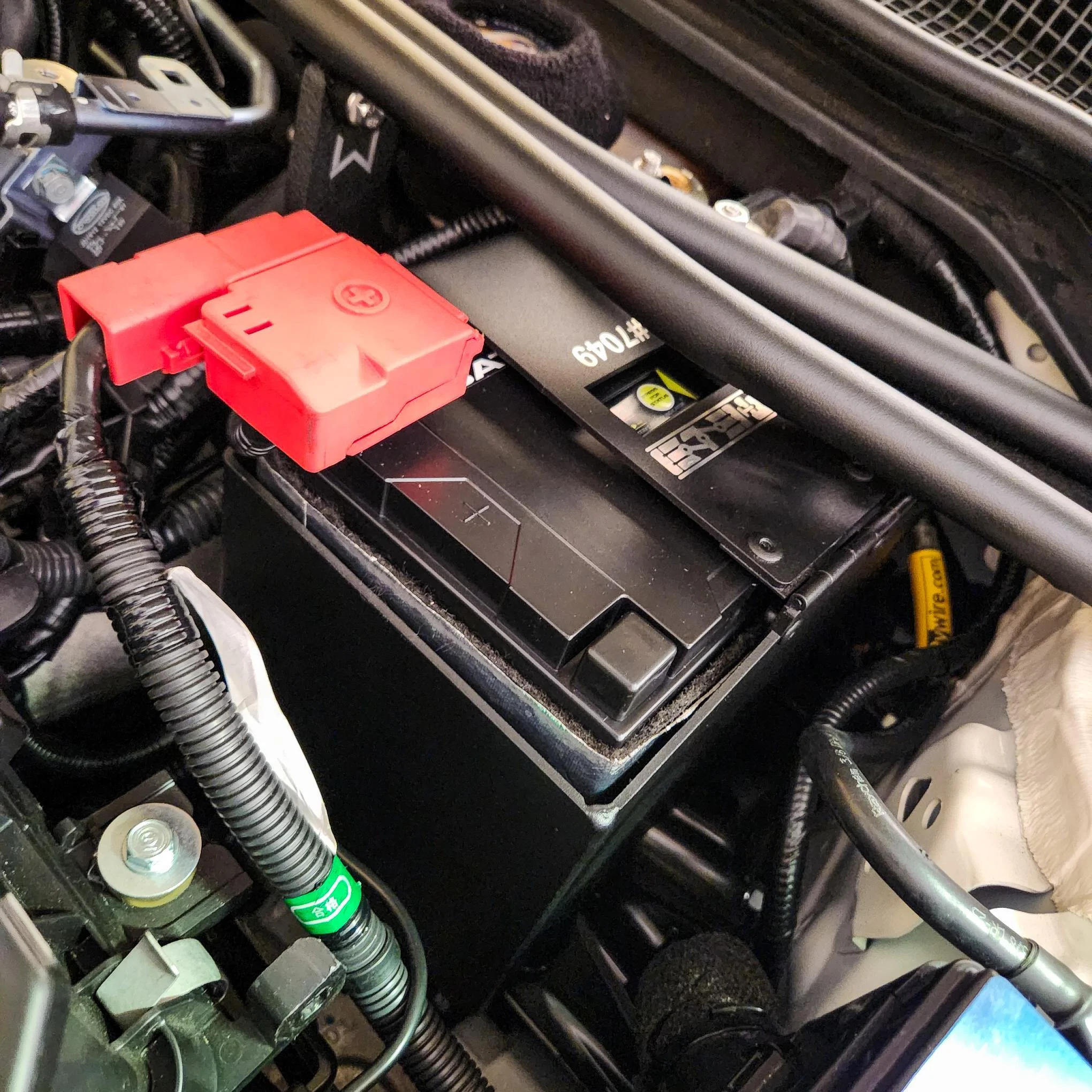

Antigravity ATX30-HD battery, Mele Designs battery box, and DEI battery insulation:
Had issues with the ATX30-RS not having the amperage hours for longer drives and overheating in Texas heat. Upgraded to ATX30-HD and paired with the DEI battery insulation and have had no issues since.

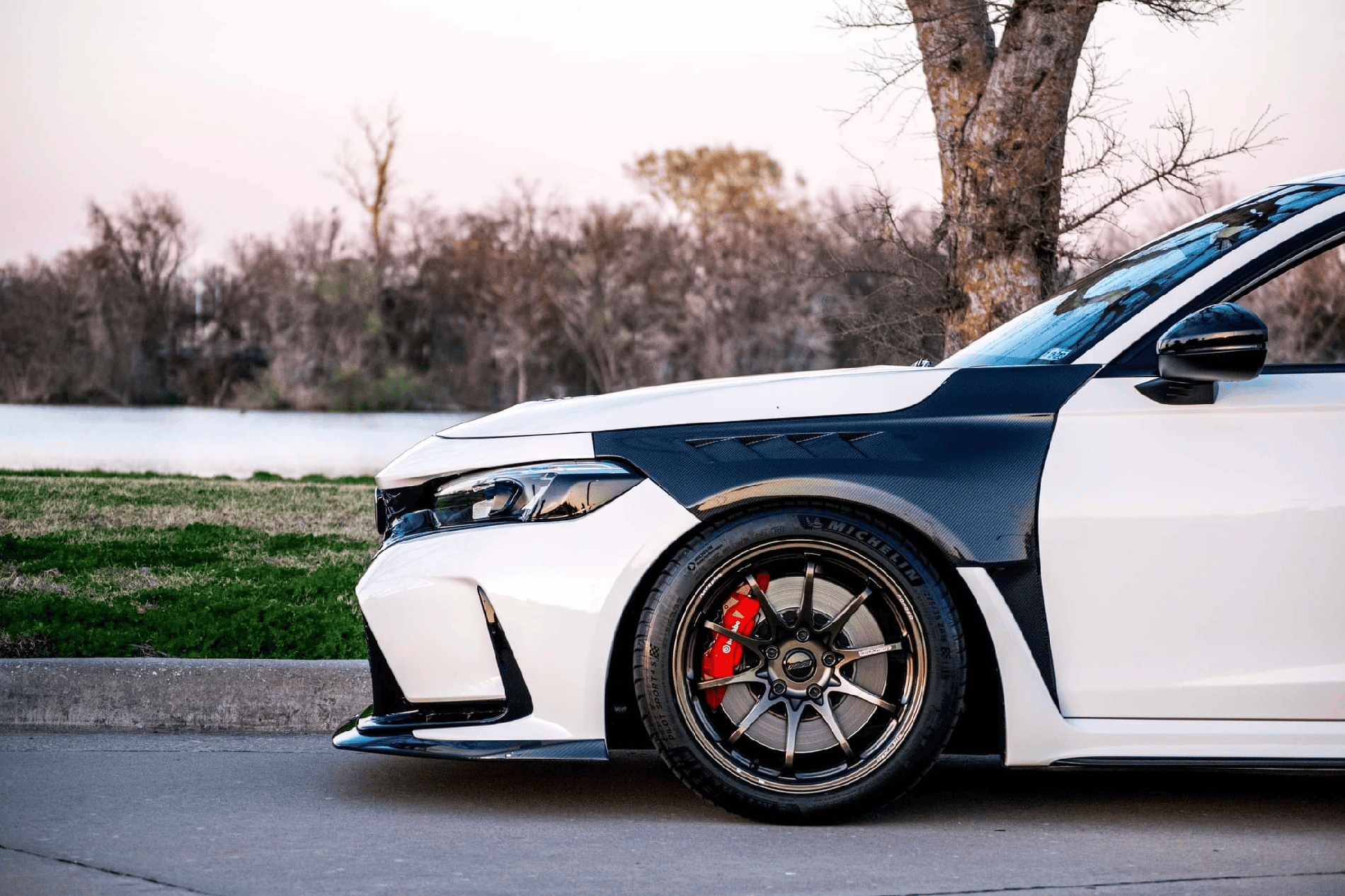

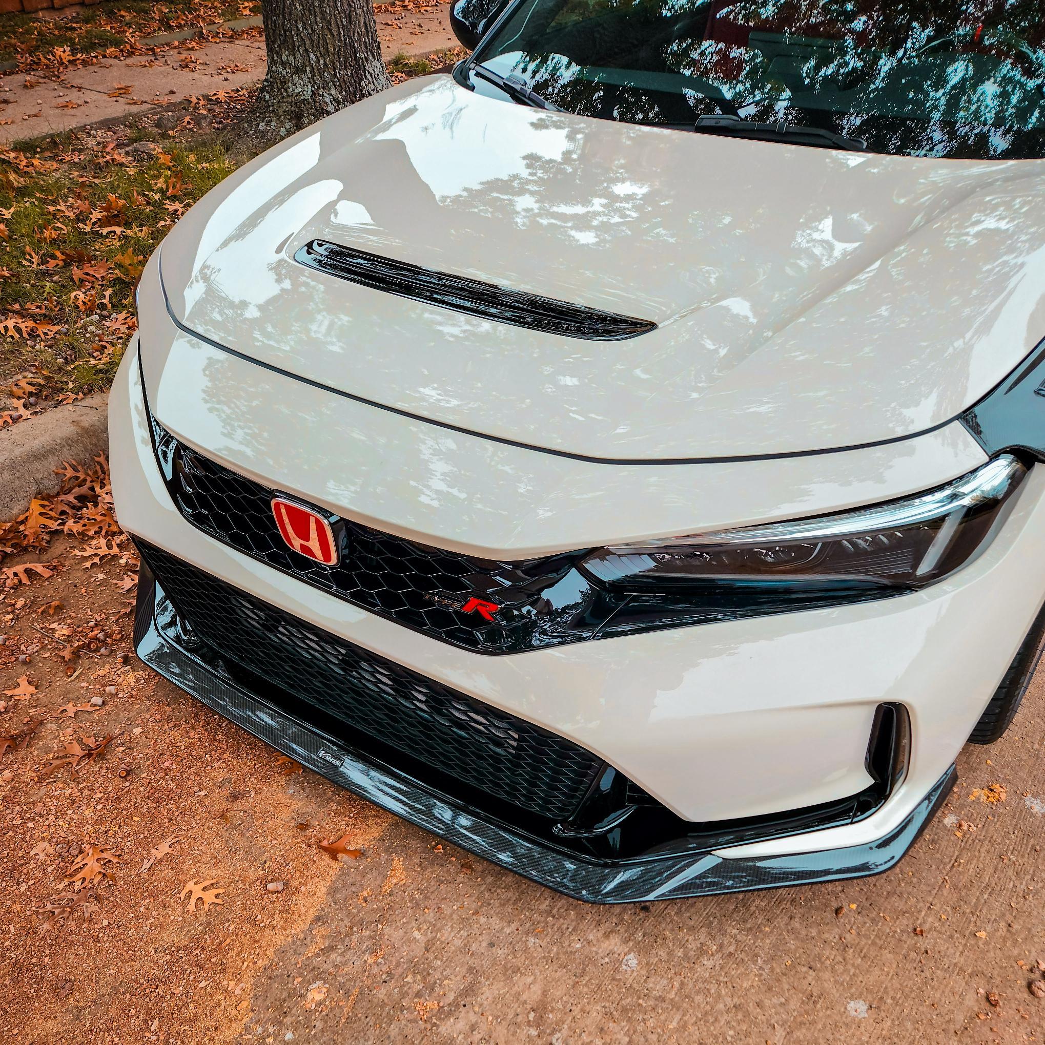

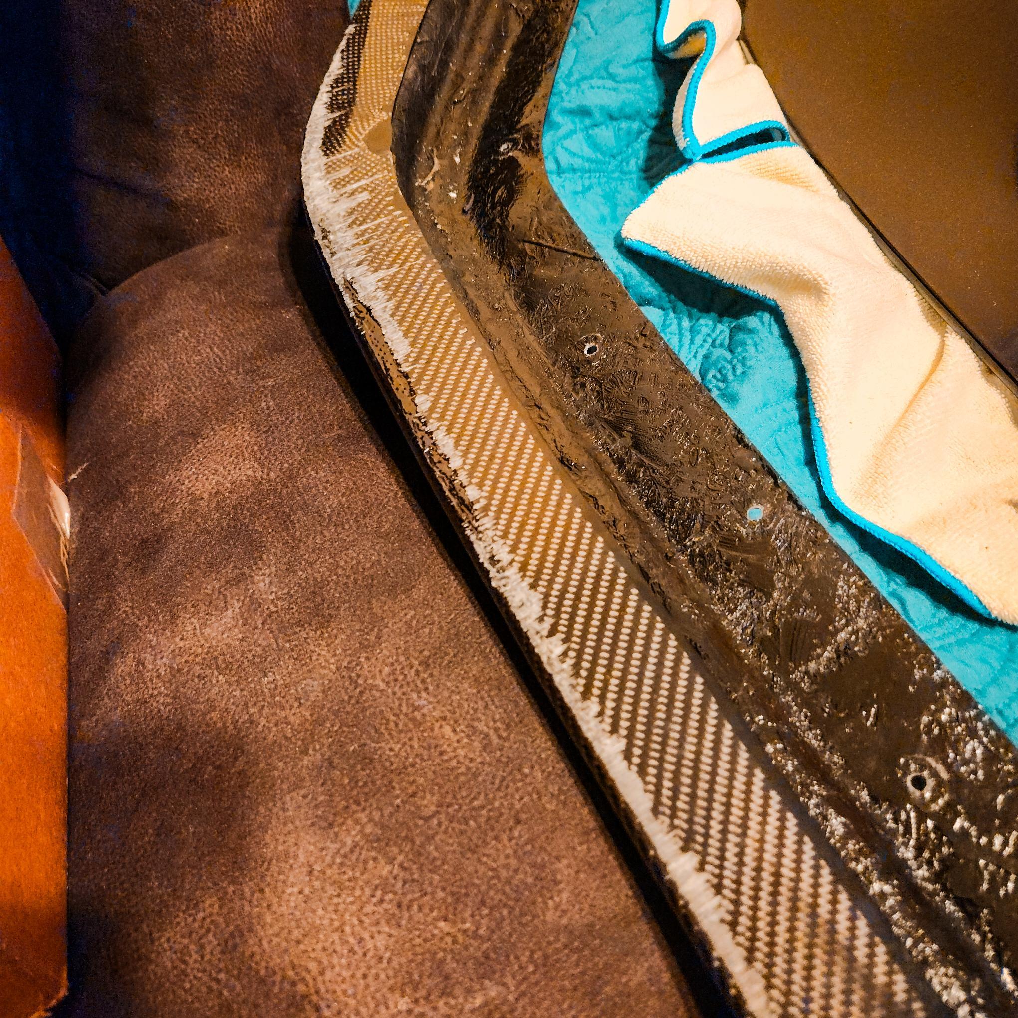

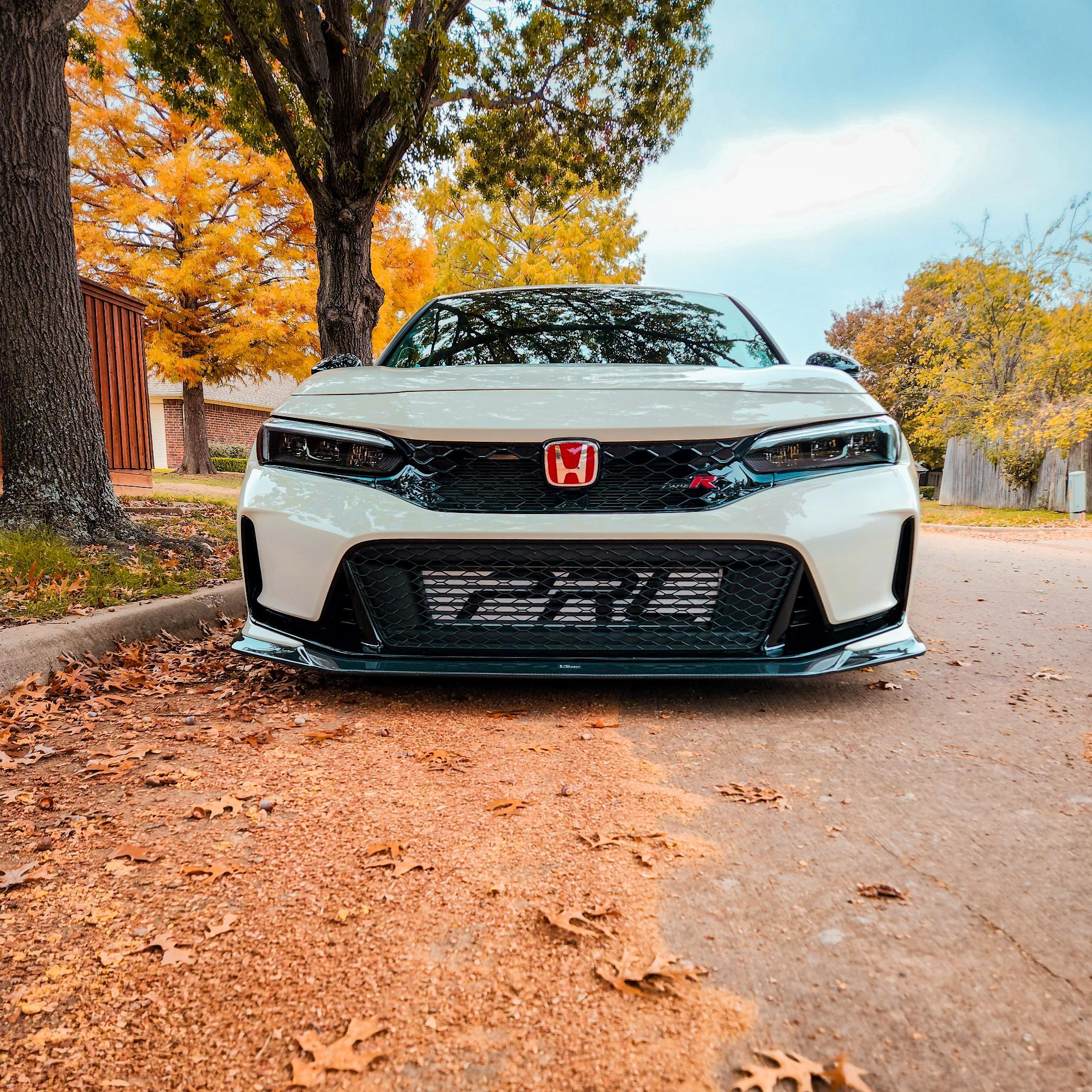

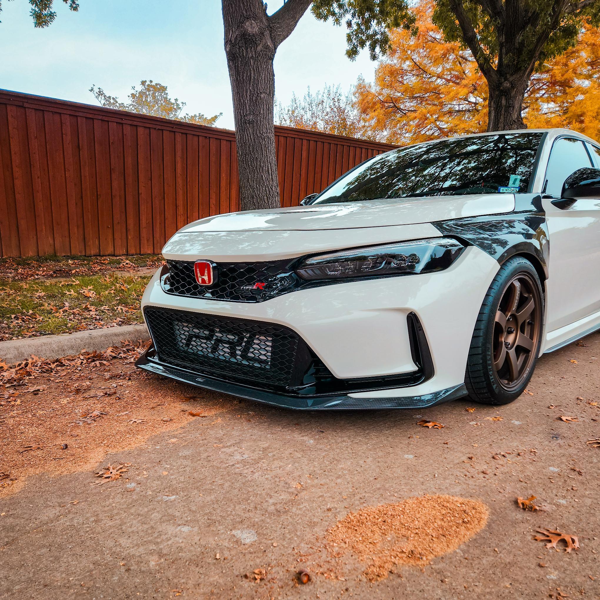

Replaced the Garage Unique lip with Varis. More drivability with the different design (the GU lip is chewed up on bottom from being so low on DFW roads). Waiting on Racebred to finish the chassis brackets for a splitter.

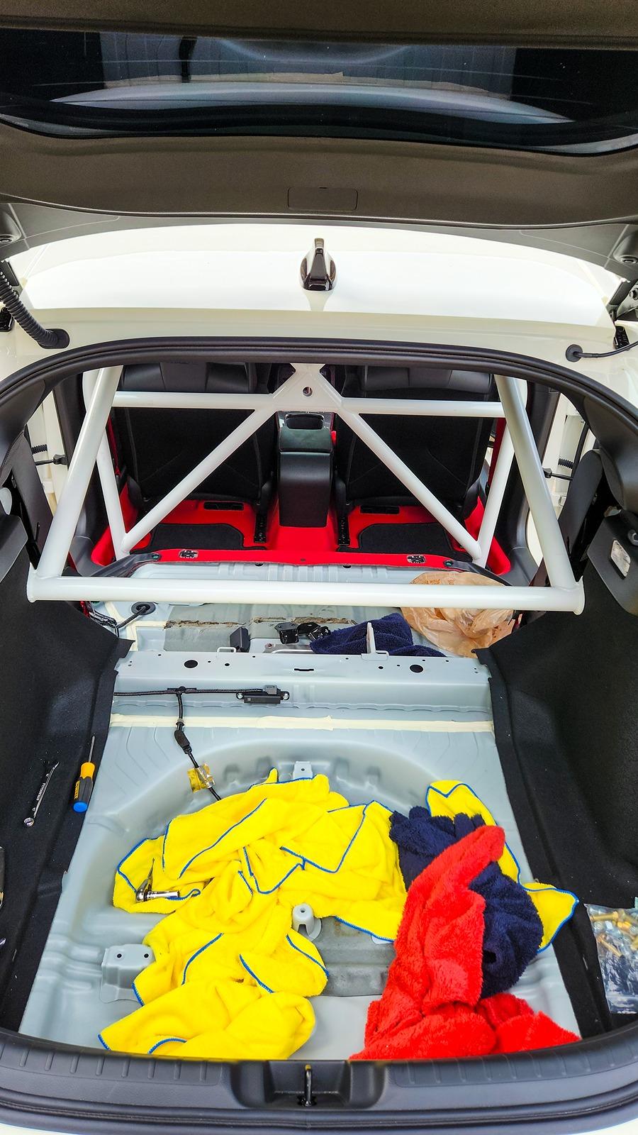

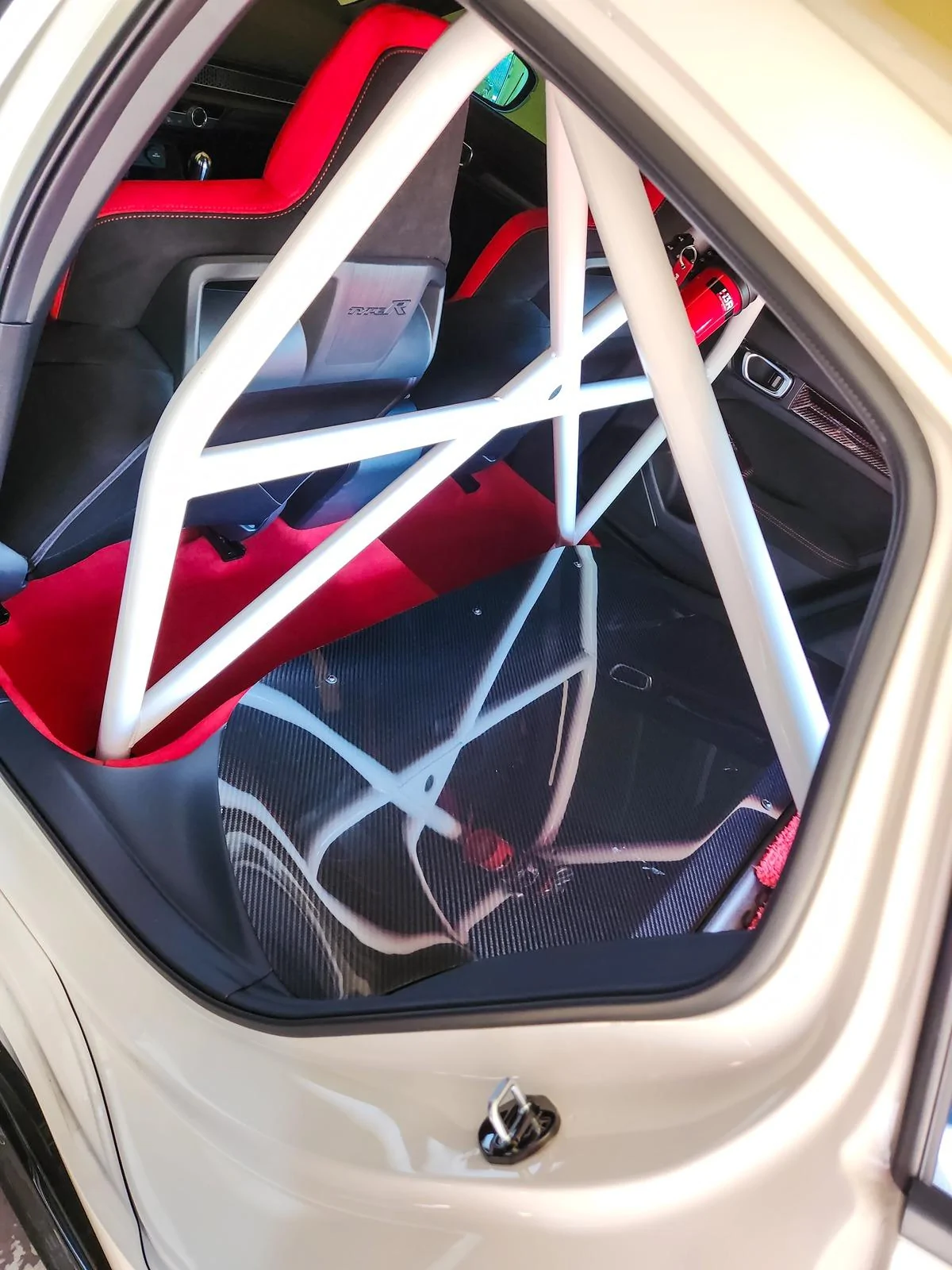

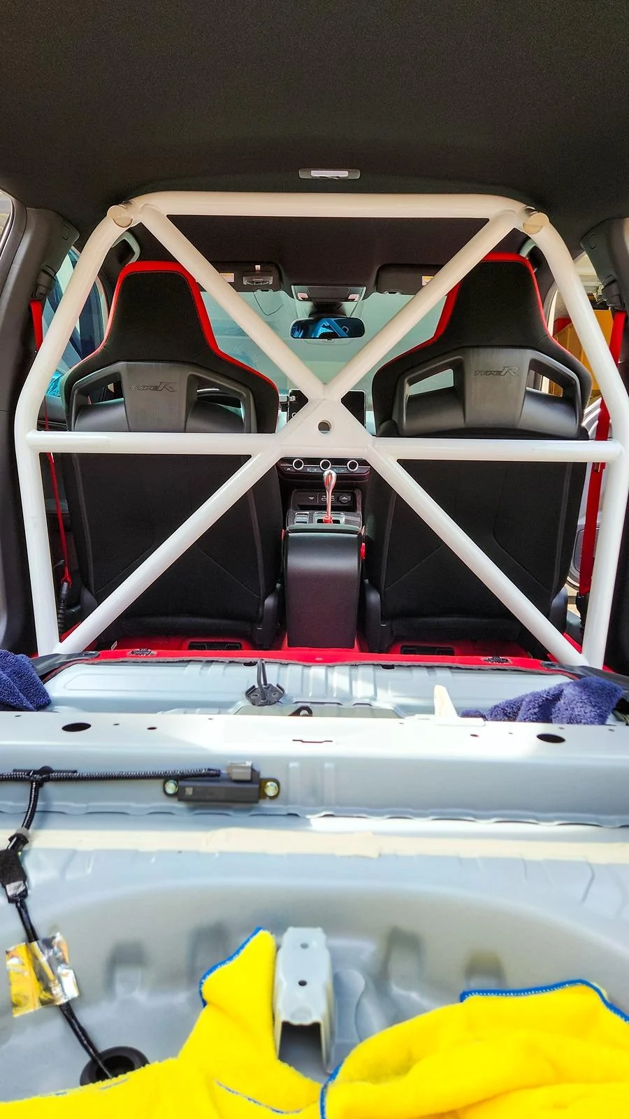

EVS Tuning roll cage install
Pre install mockup:
11th Gen Honda Civic Championship White FL5 #943 Build 20240330_164001
If you cut the hatch liner just perfect, you can get a seamless look like OEM. Will still mount directly to the frame and the edge of the hatch liner is just on the edge of the cross section. There is no option to keep the rear seat back. You can re-install the bottom after install though should you choose.
11th Gen Honda Civic Championship White FL5 #943 Build 20240330_173825

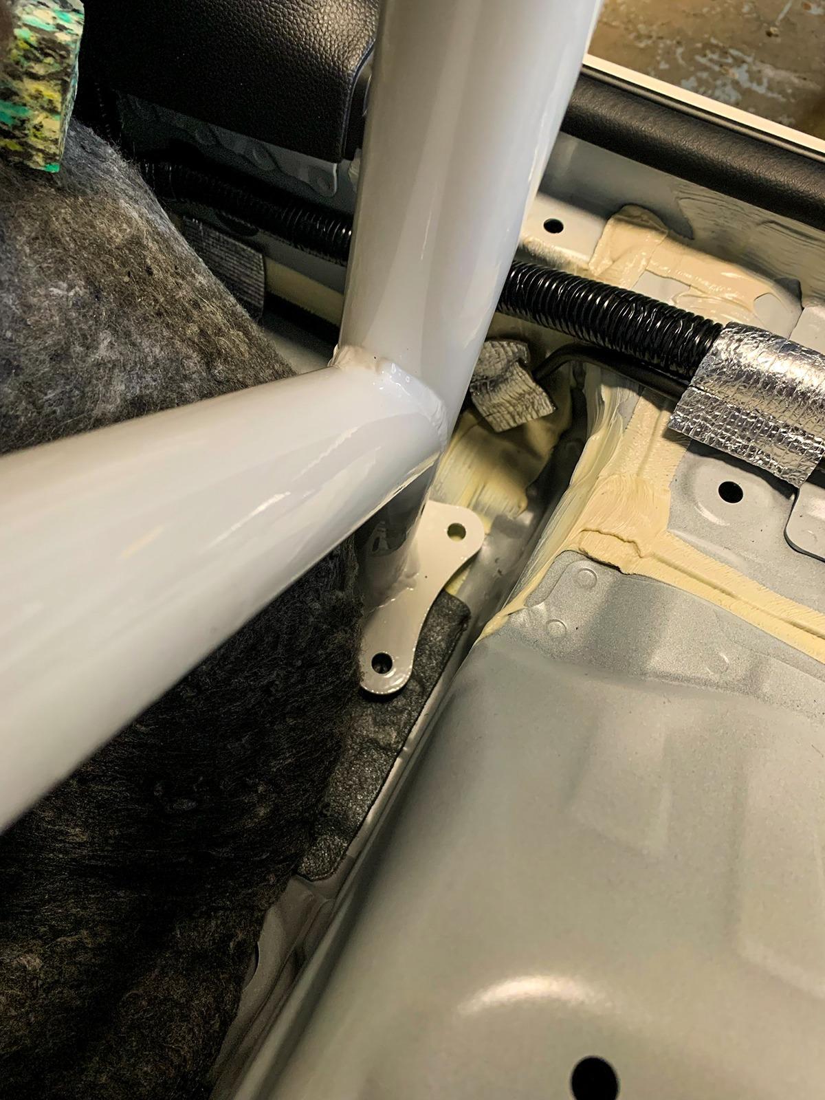

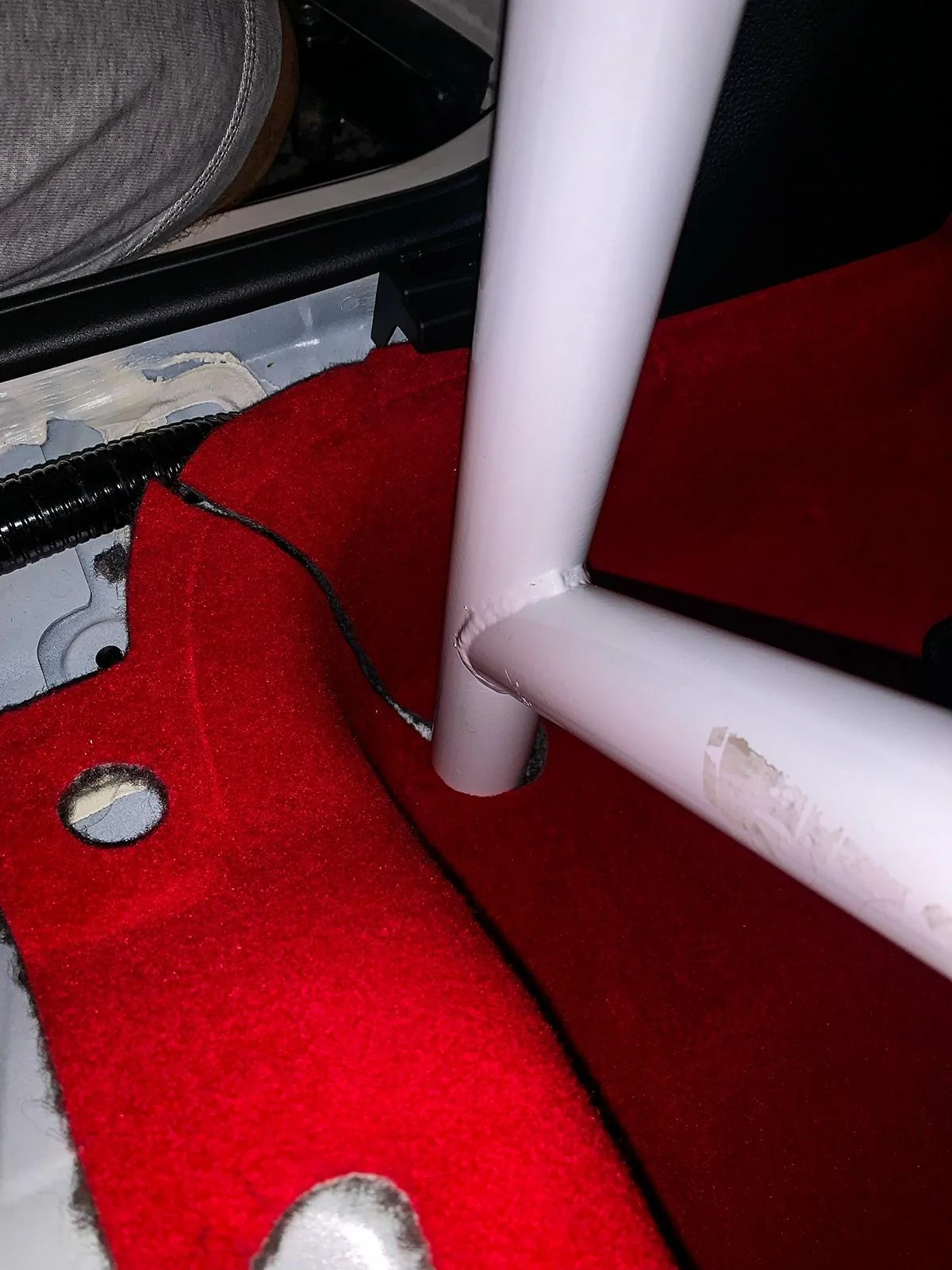

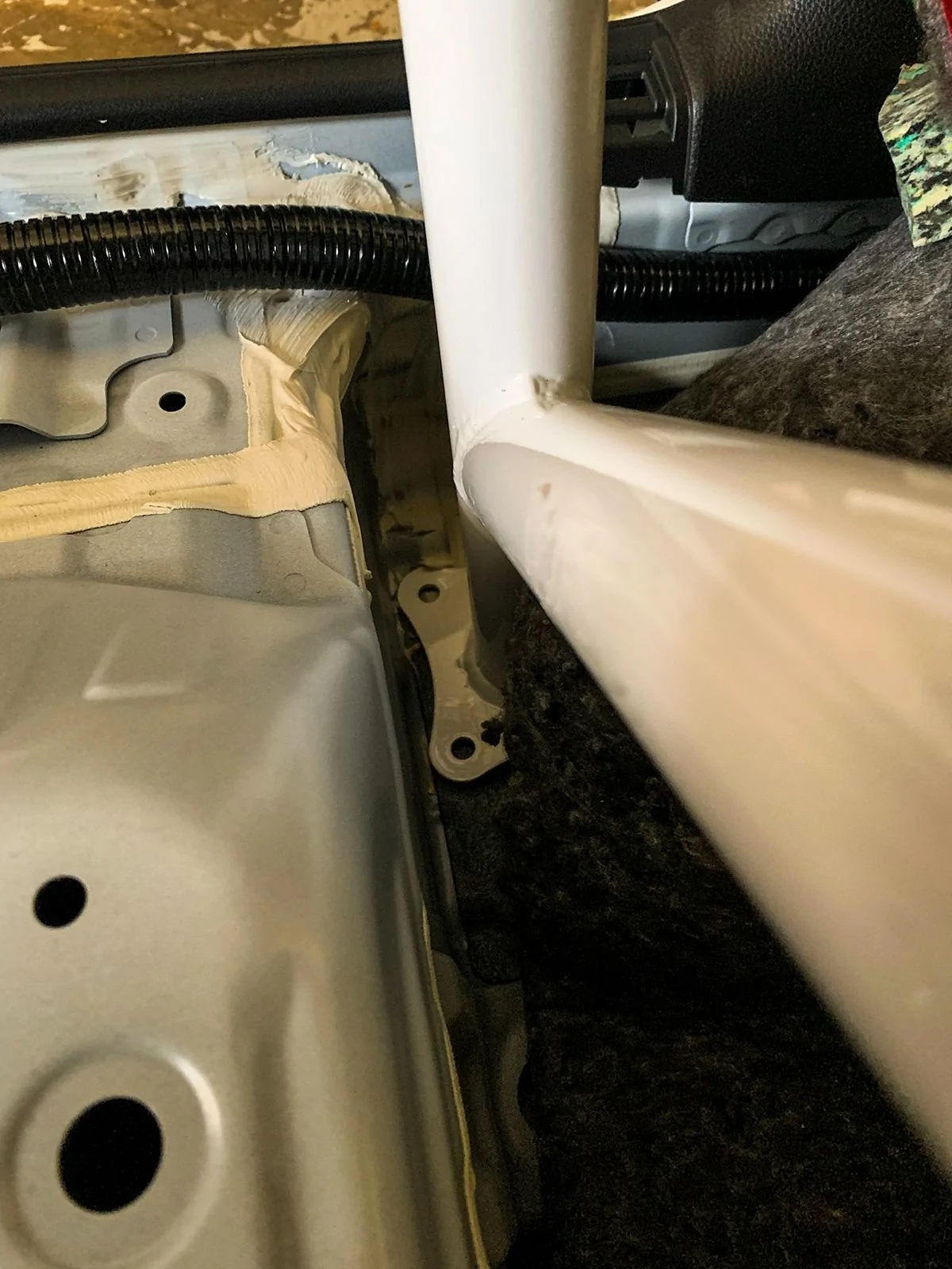

The frame is not 100% square. Some of the welds are not the best which I believe to be the root cause of the issue. Tried and tried to align perfectly, but when making the floor mounts square, the top goes out of alignment.
Driver side rear:
11th Gen Honda Civic Championship White FL5 #943 Build IMG_20240417_125717
Passenger side rear:
11th Gen Honda Civic Championship White FL5 #943 Build IMG_20240417_125716

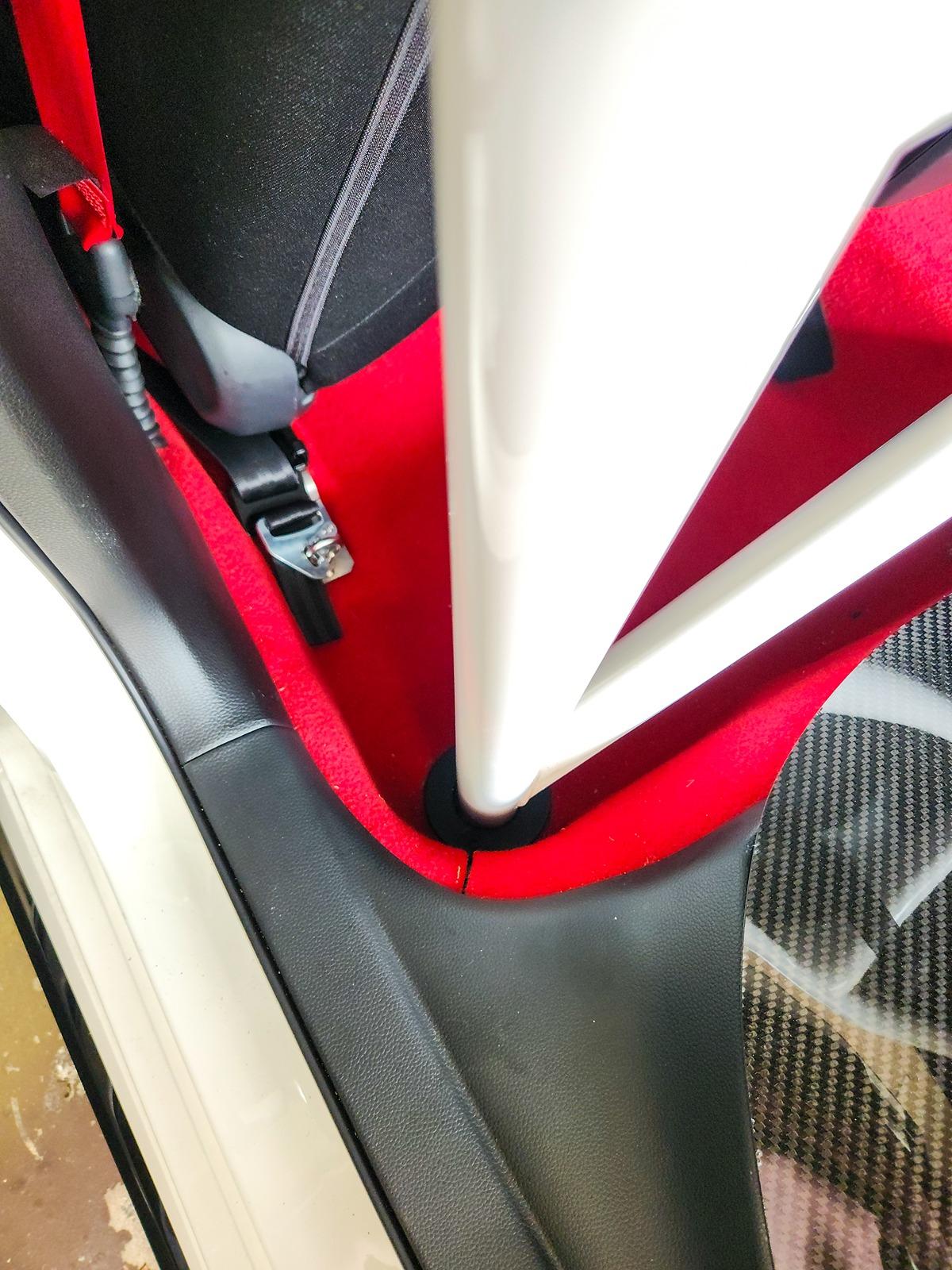

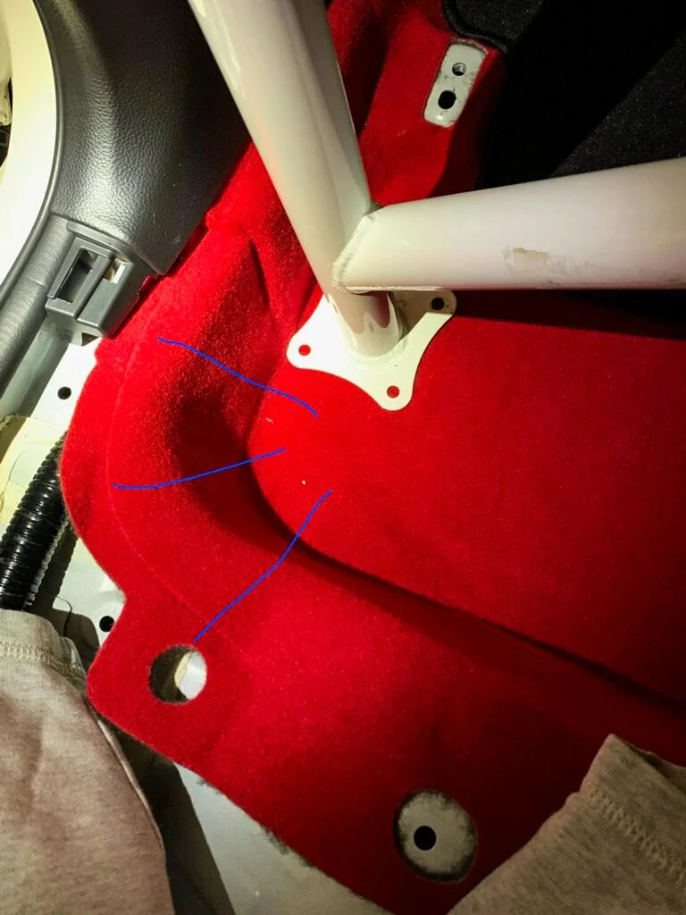

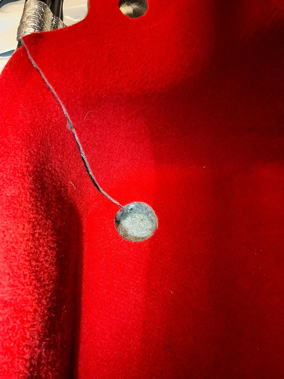

I didn't want to cut a large square hole for the mounts, so I decided to attempt to cut a line down the carpet to fit around the cage tubing and get it as close as possible. Decided the center of the three options would look best when the doors are closed.
Cutting plan:
11th Gen Honda Civic Championship White FL5 #943 Build IMG_20240417_125551
11th Gen Honda Civic Championship White FL5 #943 Build IMG_20240417_125541
Cut:
11th Gen Honda Civic Championship White FL5 #943 Build IMG_20240417_125533
11th Gen Honda Civic Championship White FL5 #943 Build IMG_20240417_125528
Used a 1.5" iron pipe size split flange to fit around the cage tubing to hide any imperfections in the carpet from cutting (1.5" IPS = 1.9" true inner diameter and cage is 1.75". This was the closest I could get.). Painted matte black as preference and contrast to the red interior, white cage, and polished hardware.
11th Gen Honda Civic Championship White FL5 #943 Build 20240417_125237
If you are really looking for the cut seams, you can see them. But with the doors close you have to stick your head in the car window and look directly down to notice. Cross view with the doors closed, not as noticeable.

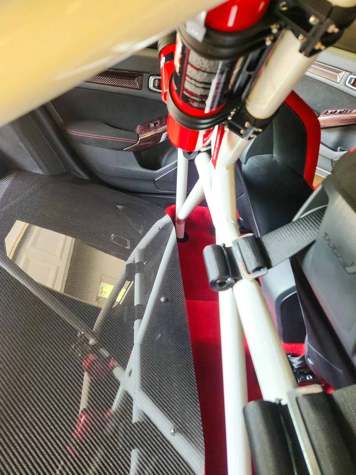

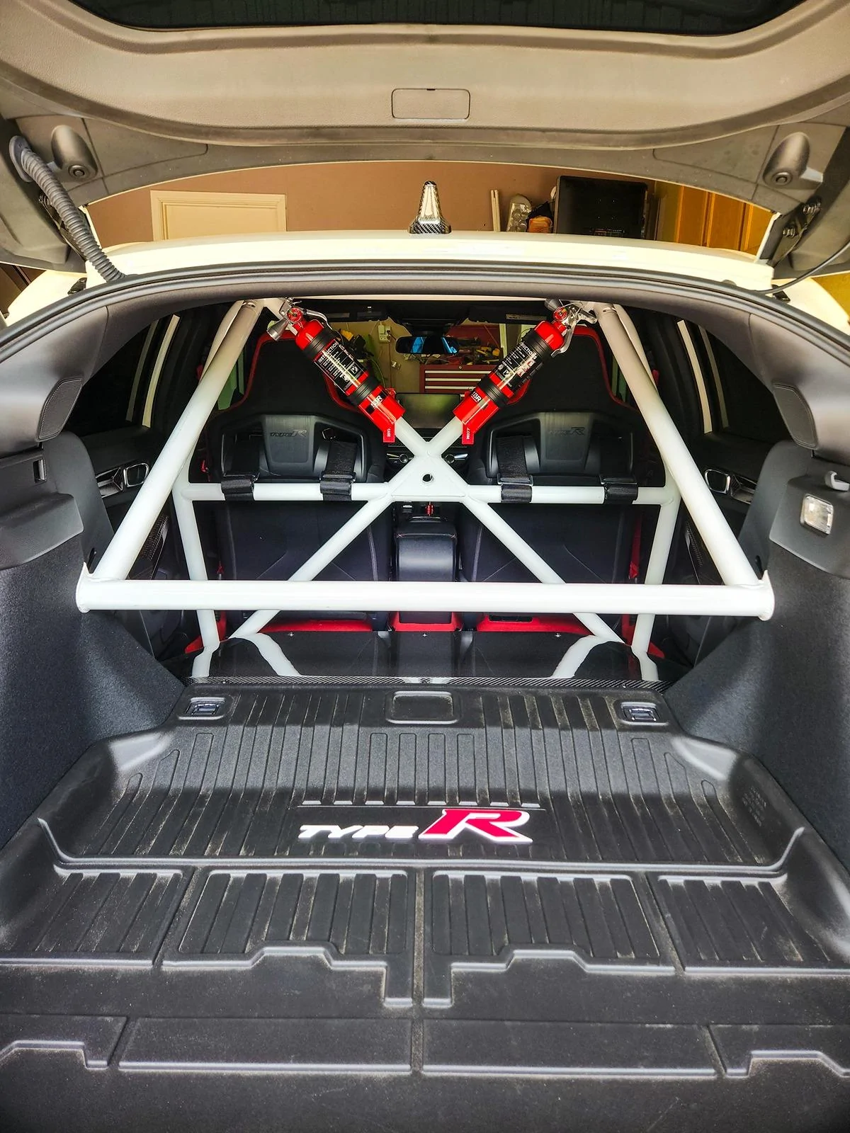

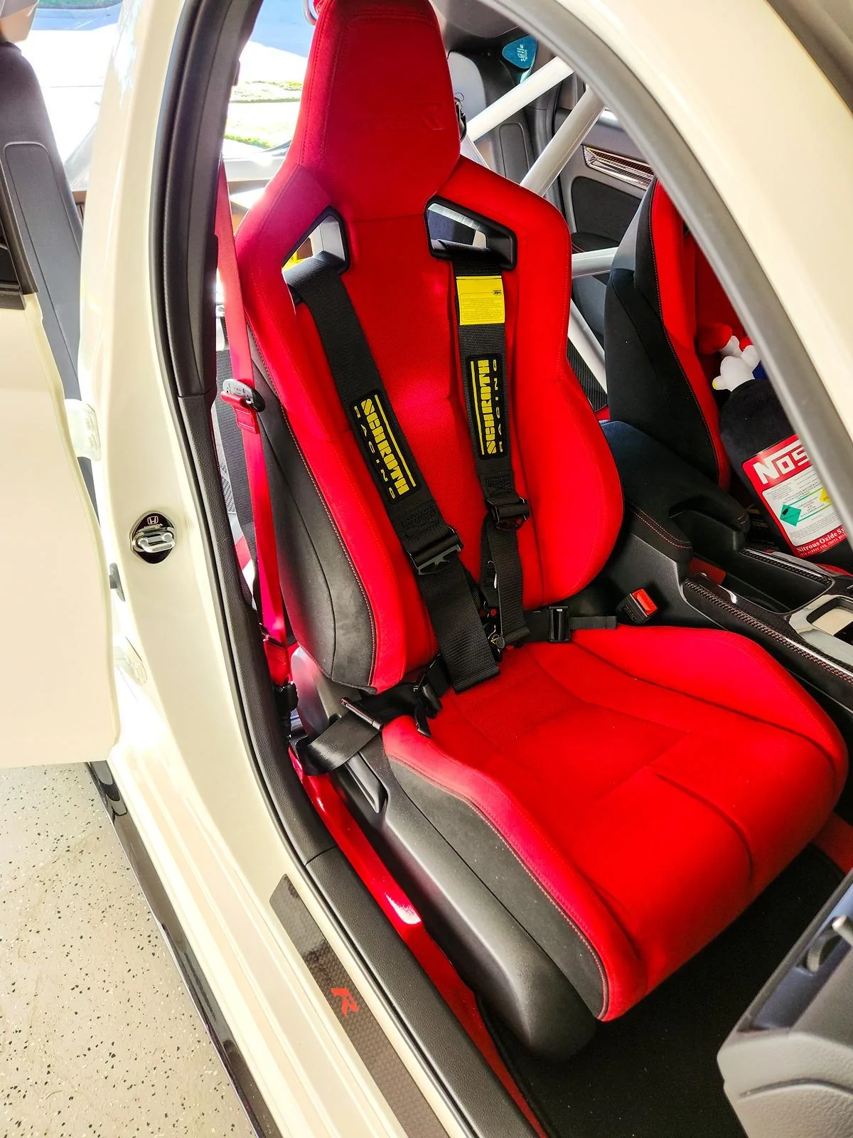

Finished off with EVS carbon seat delete, H3R extinguishers and cage mounts, and Schroth anti submarining harnesses. Schroth has interchangeable cam locks and the option to add a dual sub strap should I go with an aftermarket seat later. For now, I love these seats too much to want to change.
11th Gen Honda Civic Championship White FL5 #943 Build 20240417_125218
11th Gen Honda Civic Championship White FL5 #943 Build 20240411_183409
