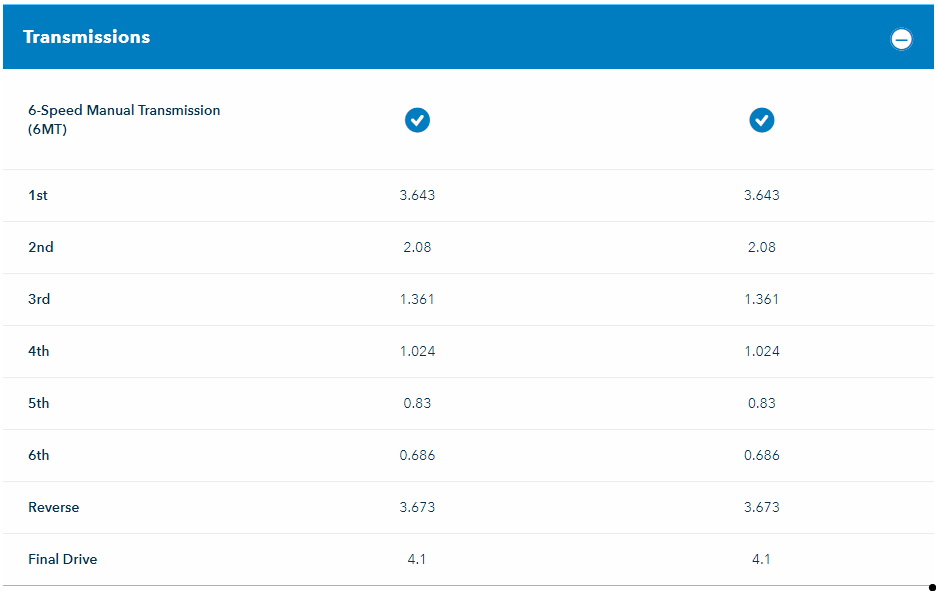

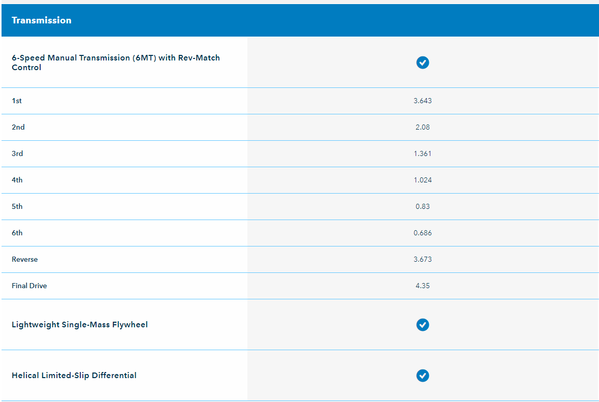

Looks like the Si has a numerically higher final drive but the same gear ratios in all 3 transmissions ( Hatch 2.0 MT / 1.5MT So 1.5MT)
Civic Hatch Sport and Civic Hatch Sport Touring

Civic Si
11th Gen Honda Civic CIVIC SI FINAL DRIVE 1649124669623

I wonder if that 4.1 Final drive would fit in in the SI , it would help out so much on highway driving.
Damn that such good info, idk where you guys get all this from
I feel like that difference will impact acceleration but overall better since ur on boost more specially once tunes i feel like the gearing are so small. (Could be 100% wrong though)
It would theoretically negatively affect acceleration, though. As well as throw off the speedometer. But i’m curious to see how different final drives will impact how the car performs, in both MPGs and acceleration.
Back in my S2000 days, a lot of people opted to replace the OEM 4.1 final drive with 4.44 and 4.77 final drives to improve acceleration, but the MPGs and highway cruise RPM took a hit.
