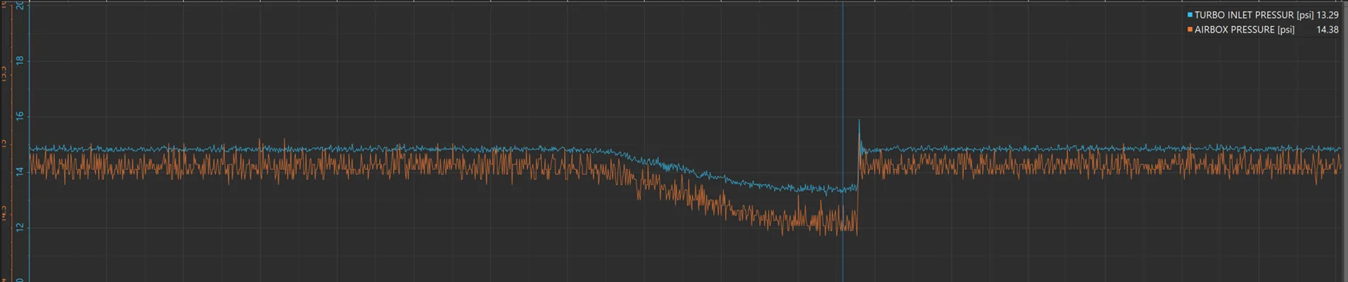

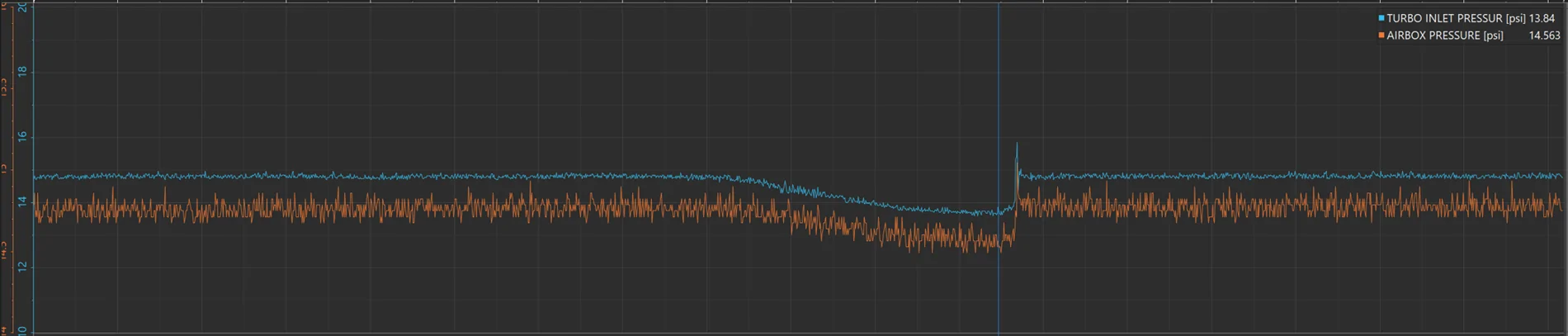

These are both great looking pieces. The intake will require tuning as noted.
The only flaw I see is that that this intake does not have a secondary air inlet point and will be choked on applications beyond 400whp as have all others that lack a secondary inlet point. Of course, not everyone is worried about exceeding 400whp so this will be a non issue to many.
Thanks for the compliments on the aesthetics! We invested a tremendous amount of time and effort (approximately 2 years in total) in developing these components to harness all the power while maintaining CARB (50-state/California) compliance.
Good callout on the tune - yes, since the MAF housing is larger, you will need a specific calibration (we include both our Stage 1+SF and Stage 2 calibrations, for free on the AP, which were both validated over hundreds of hours of testing on the street and track).
With respect to the COBB intake having a flow limitation and limited power capacity - that's not accurate ;). We designed the box/MAF to be capable of supporting the highest HP FL5s/DE5s out there, at over 500 wHP. I suspect you'll see some documentation of that start to pop up very soon :).
The extra inlet holes you're referring to on the PRL intake aren't necessary on our airbox. During preliminary designs, we flirted with the idea and went through a few iterations, but found it not only wrecked havoc with the MAF sensor due to turbulent airflow (especially when the radiator fans kicked on), but it also increased intake air temps, as it was drawing air directly off of a hot engine, thereby working against our intents to increase power. Additionally, it would have created a nightmare in securing our CARB EO. There was nothing to be gained by going that route.
With our intake and airbox design, we were able to develop a system that ultimately allowed the turbo to spool easier, smoother, and with less wear. Less wastegate position = less exhaust restriction = lower exhaust manifold pressure = more efficient engine operation and more power output. In the attached images, you can see the overlay of compressor inlet pressure and airbox pressure. Note, there were no calibration changes to the boost curve - it was merely scaled for the MAF sensor. The airbox pressure being closer to ambient helps the compressor inlet pressure.

I hope that info helps clear things up! We're going to have a blog post posted this week or next with all the technical info that the geeks will love. Let me know if you have any other questions!
- Matt @ COBB

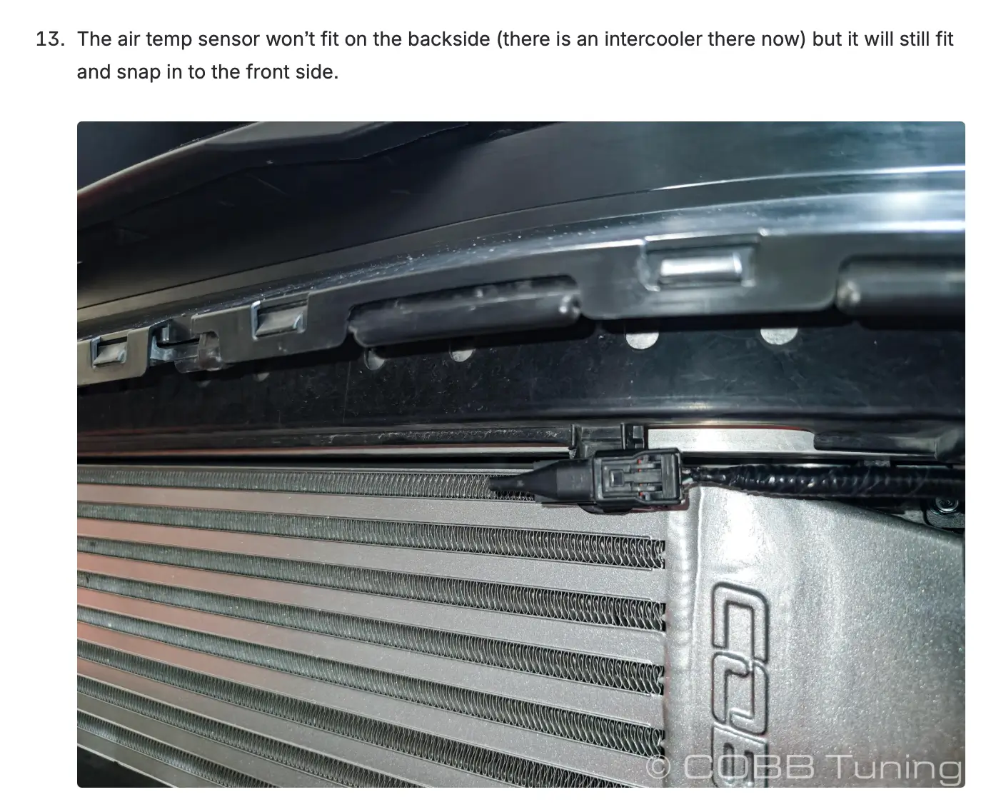

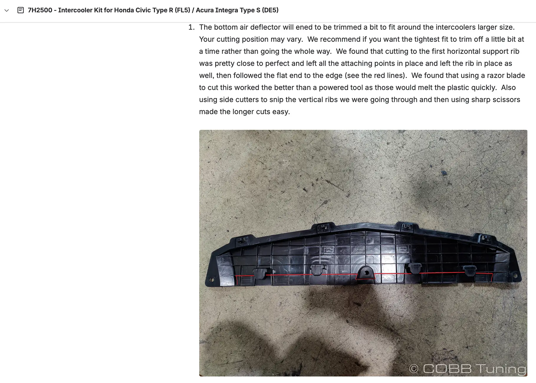

Does either the Cobb or PWR intercooler require trimming/relocating the air temp sensor/bracket like the PRL intercooler does?
I only had to trim the 2 air deflectors on the inside of the bumper that route the air toward the intercooler. Those plastic pieces are also removable and easily replaceable since they are screwed on to the inside of the bumper. They cut pretty easily as well with scissors and you just need to trim them so they aren't smashed into the IC.
Didn't need to do anything to the air temp sensor mount. That stayed put but you did have to unhook the temp sensor from and flip it around to the front side of that peg.
Hey JC,
Great questions!
You do not need to relocate the air temp sensor (Step 13 - Installing Intercooler).

You will trim the air deflector. It's not difficult, just a bit tedious (Step 1 - Trimming).
- Matt @ COBB
