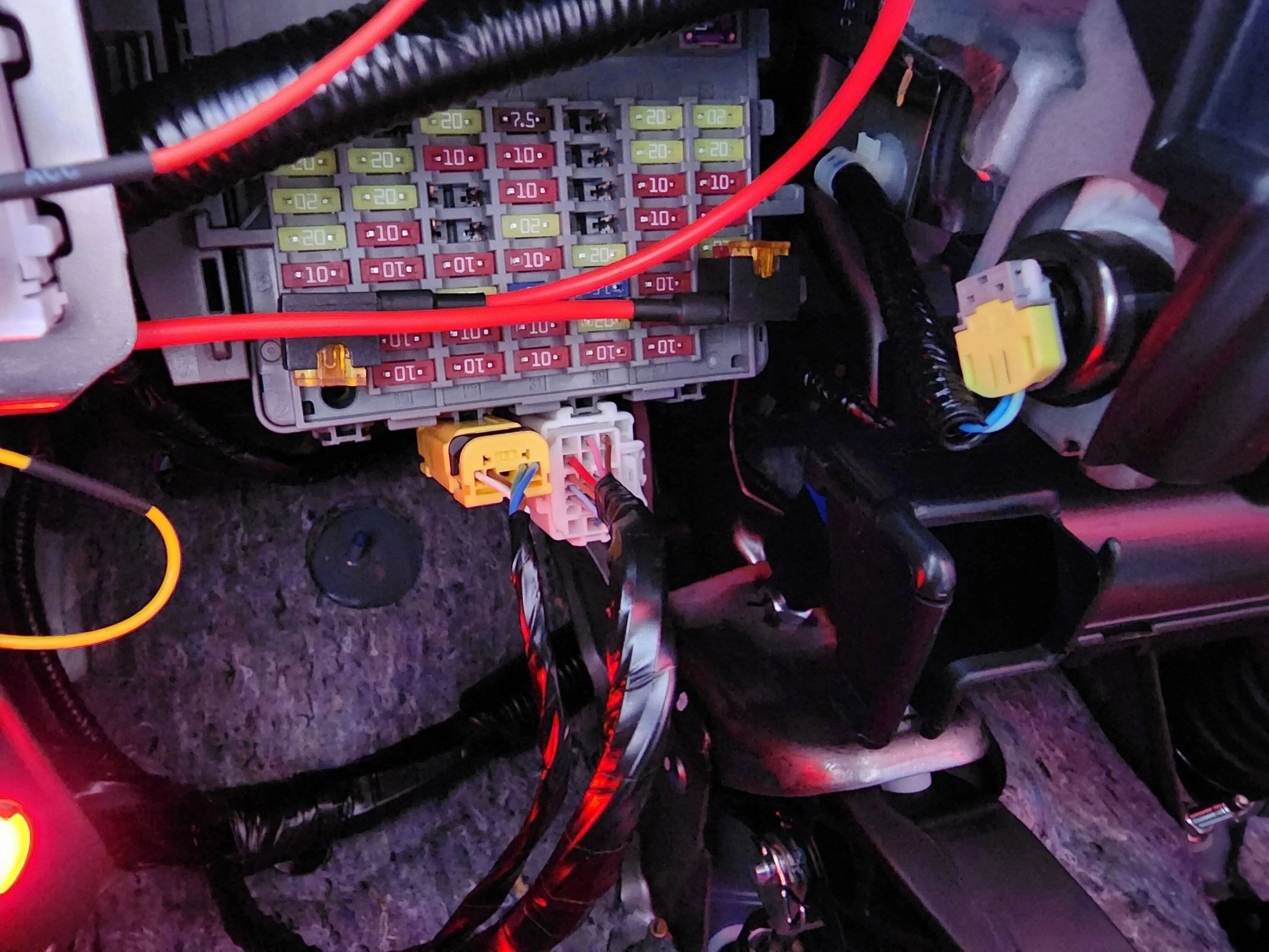

Did you hardwire into the fuse box? If so do you remember what fuse location you used?

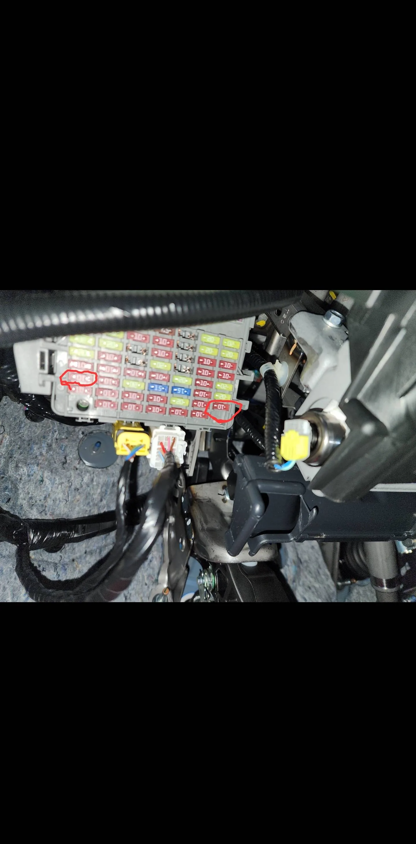

I did, I didn't specifically pick a spot I just used a circuit tester to find a battery fuse and an ACC fuse. I used 10A fuse locations. I can try and get a picture of exactly which ones they are for ya if you'd like
Here's some pics to help you out if you decide to go that route.
Definitely be sure to double check with a circuit tester. Hope this helps.
