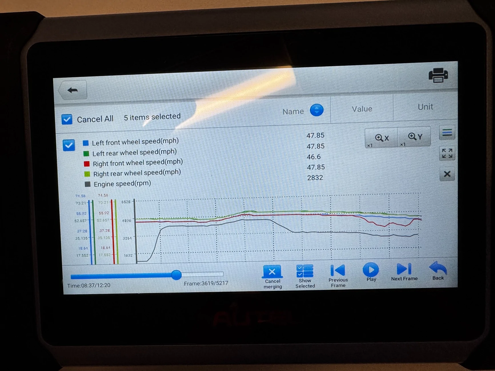

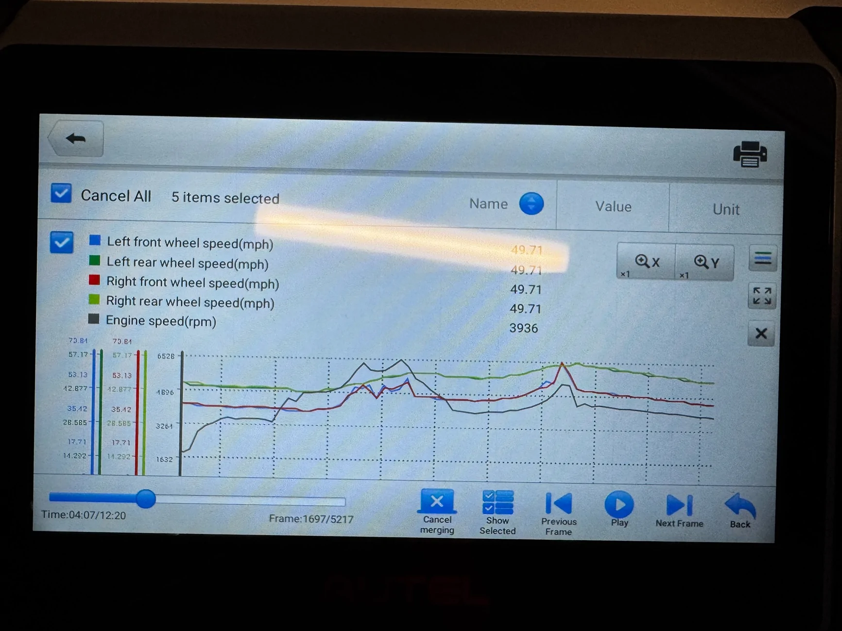

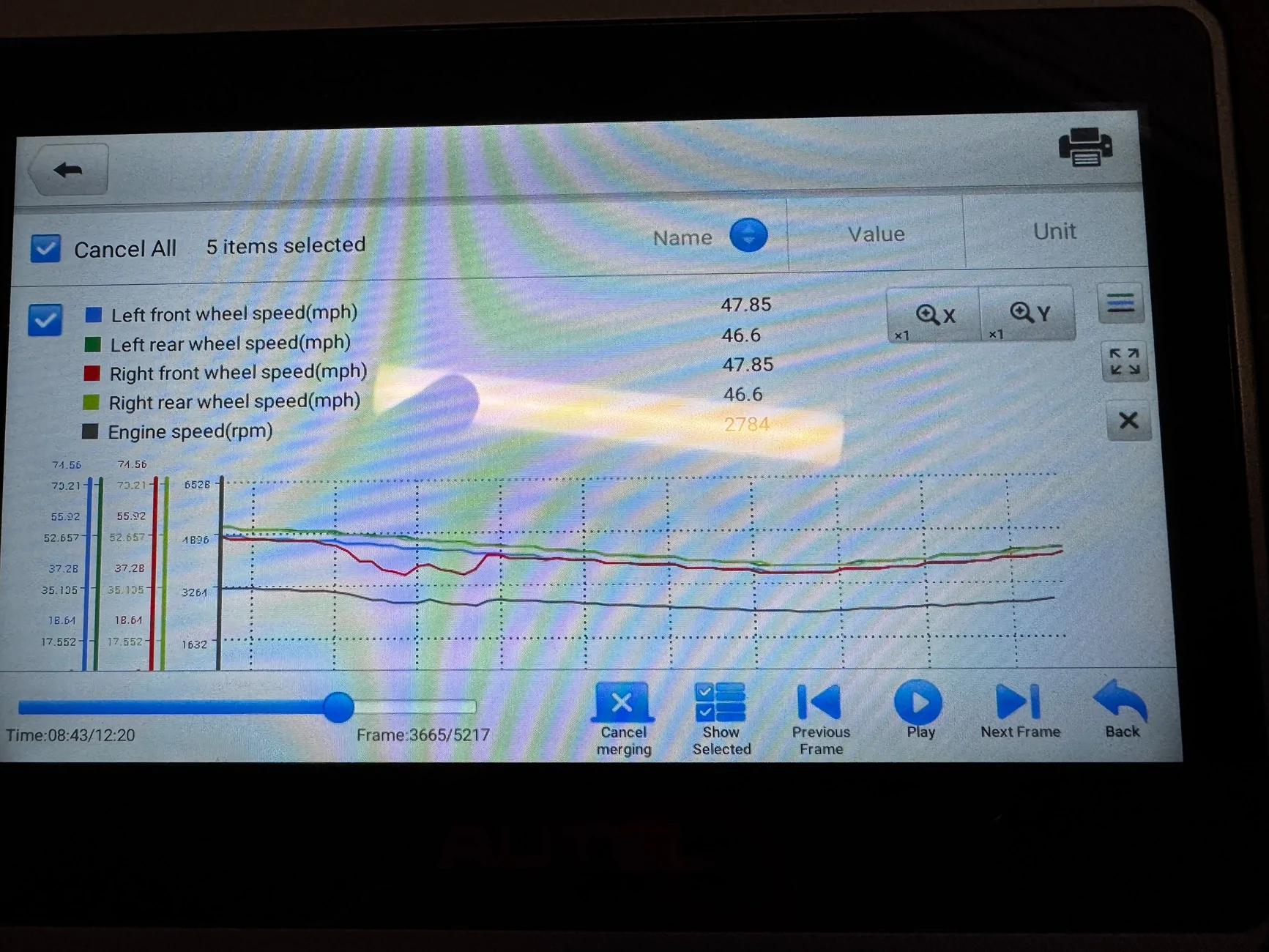

I took a log this morning driving to work in heavy rain with my Autel MX808S. Whenever I drive through a heavy rain/puddles I get this intense vibration that starts around where the RMM is - Ive posted about it recently. Anyways with these logs would you say that my passenger front speed sensor is bad?
The first image is showing normal wheel spin / loss of traction under power. I did this on purpose for the log today but also it was really slippery out and my summers are getting a little worn at 6/32 (not bad but I can tell wet traction in heavy rain isnt the same as 8/32). As the car hit the water and the front tires speed increased, so did the engine speed. Normal. The second and third show the one passenger front speed sensor DECREASING speed while engine speed remained constant. The other front tire stayed at the same speed as the rears. I dont think traction was lost since it slowed down and engine speed didnt change. Thoughts?

looks suspicious to me.. id pull out that sensor and clean all the brake dust off of it

Will have to do that today or tomorrow then. Just spray/clean it with electronics cleaner? I am still getting used to working on a car again after being hands off for so long. I am mechanically inclined lol.
