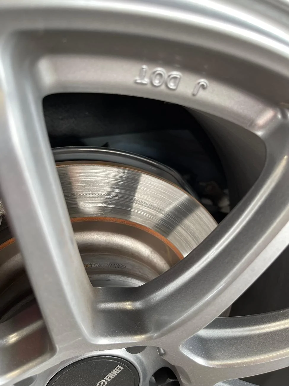

I took my car to the dealership again, and this time they noticed scratch (I think he called it "chatter") marks on the rear rotors:
11th Gen Honda Civic Low Speed Wheel Squeaking Noise IMG_7568
I had to get new rear rotors since there wasn't enough of them left after the previous resurfacing. I've been driving around for several days now, and the squeaking is completely gone.
I believe I had two completely separate low-speed wheel squeaking issues which are now resolved:
  1. Original squeaking issue would happen only after driving around for a while. Something was leaking brake fluid onto the pads, and after fixing the leak, the issue was resolved. My front pads also got replaced (normal wear & tear). More info here.
  2. The second squeaking issue I'd hear right away when I first start driving. This was caused by the chatter marks on the rear rotors, and replacing the rotors fixed the issue.
