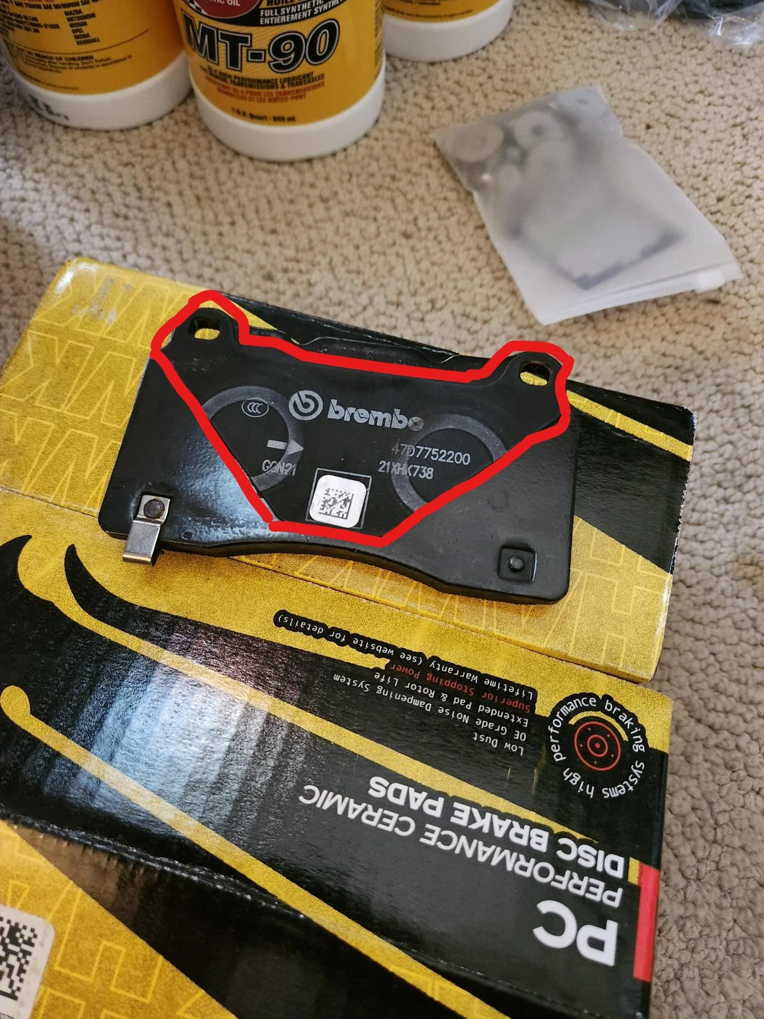

curious if when you took out your pads to put the shims in did you find shims already in there from the factory?
my car has shims from the factory installed between the pads and brake cylinders. I never have seen that on my previous cars.

See below for what is on the factory pads. I changed those out a while back to ceramic pads, but I think others who have experienced the squeaking may be on the Brembo's still (but certainly could be wrong there) so that should eliminate that from being the culprit. Tbh I should have done the shims at the same time when I swapped, but I am looking to upgrade the brakes but other parts have taken priority for the time being.

Same on mine. What’s interesting is the compressible material on the factory shims. Not used to seeing compressible material on a shim and am curious to the purpose.
