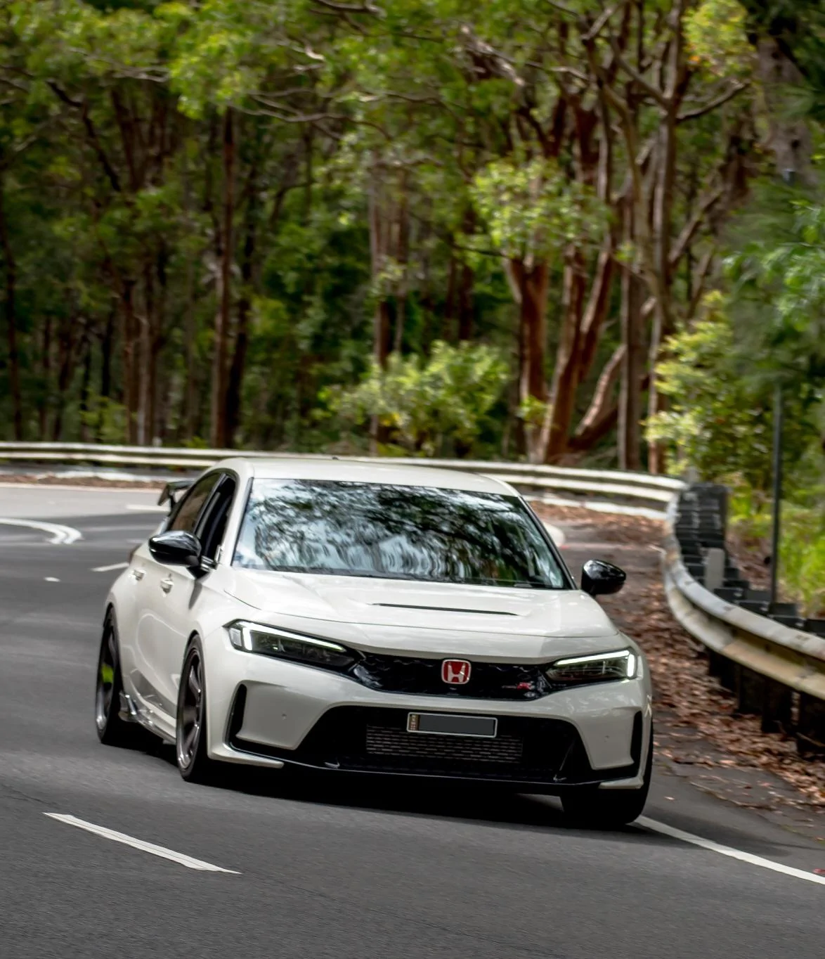

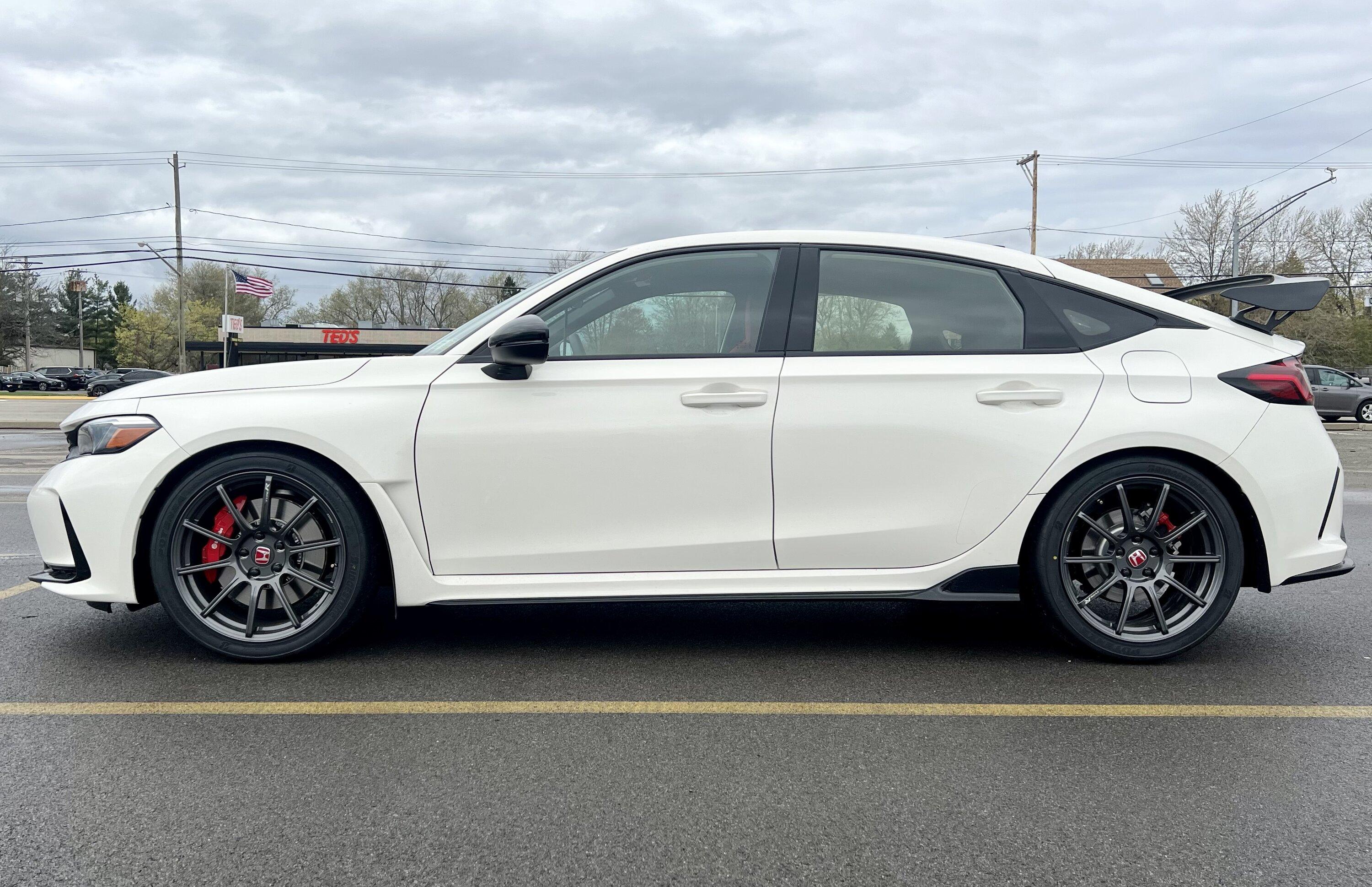

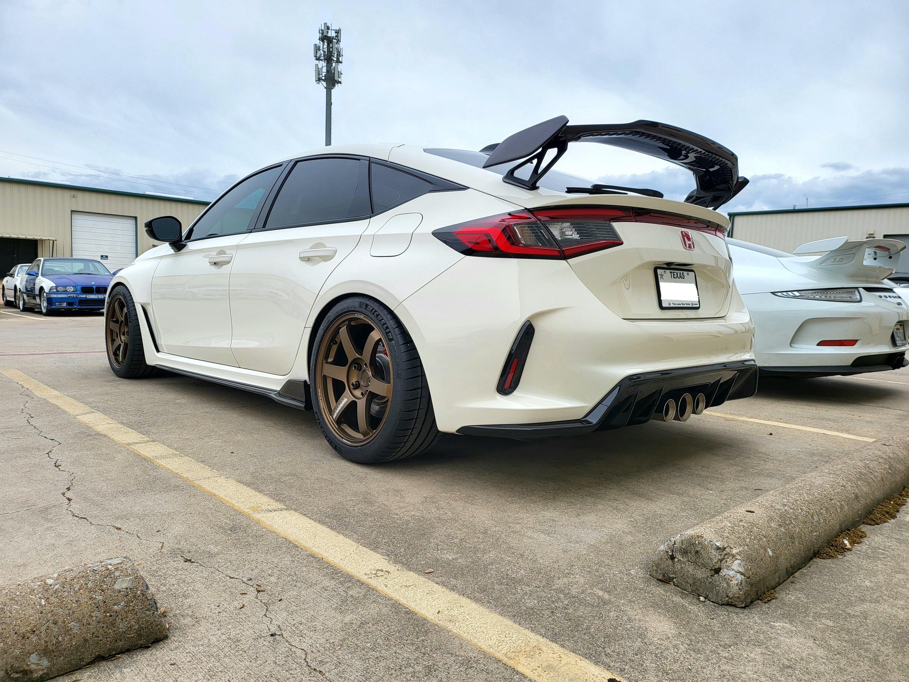

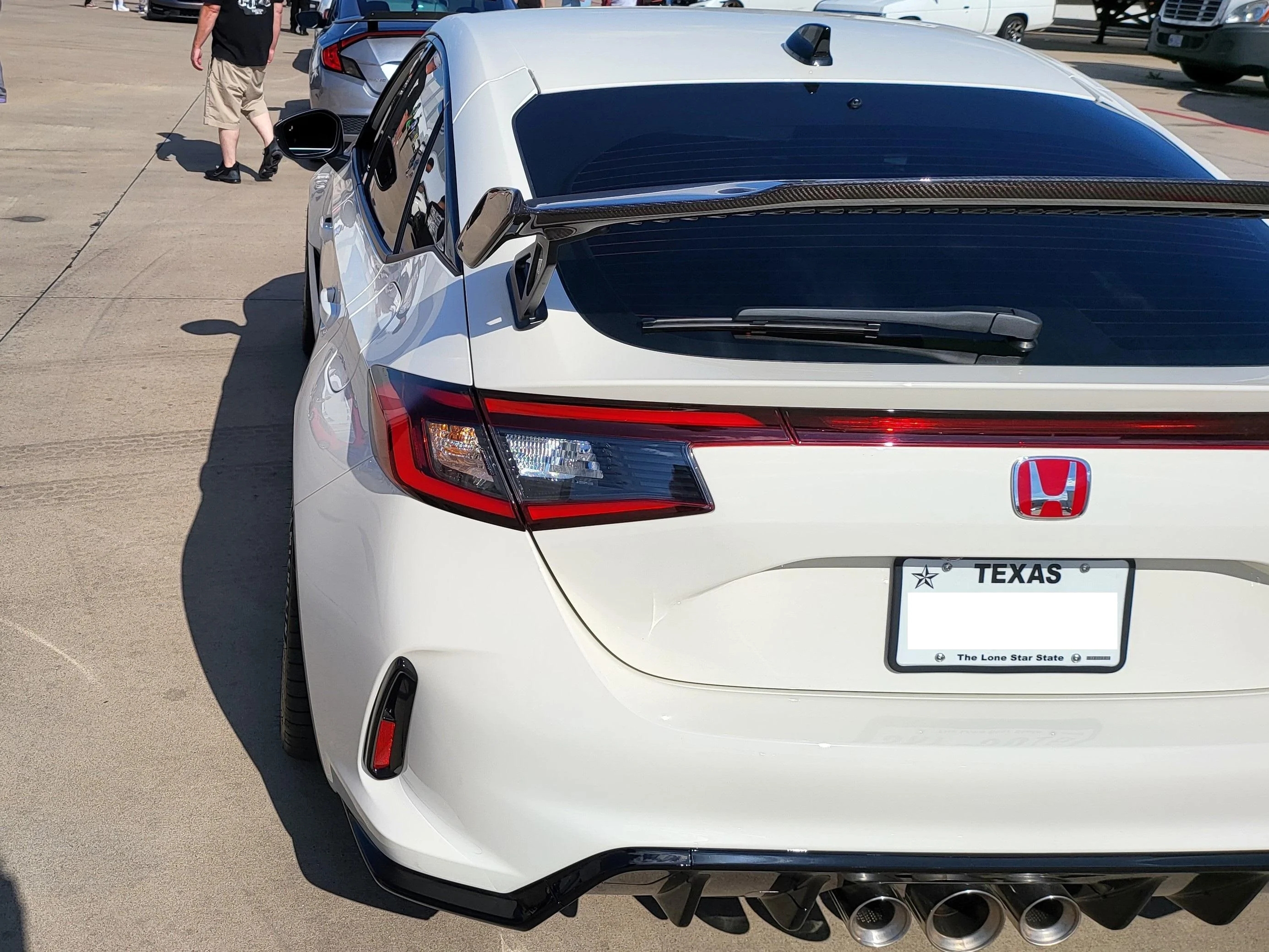

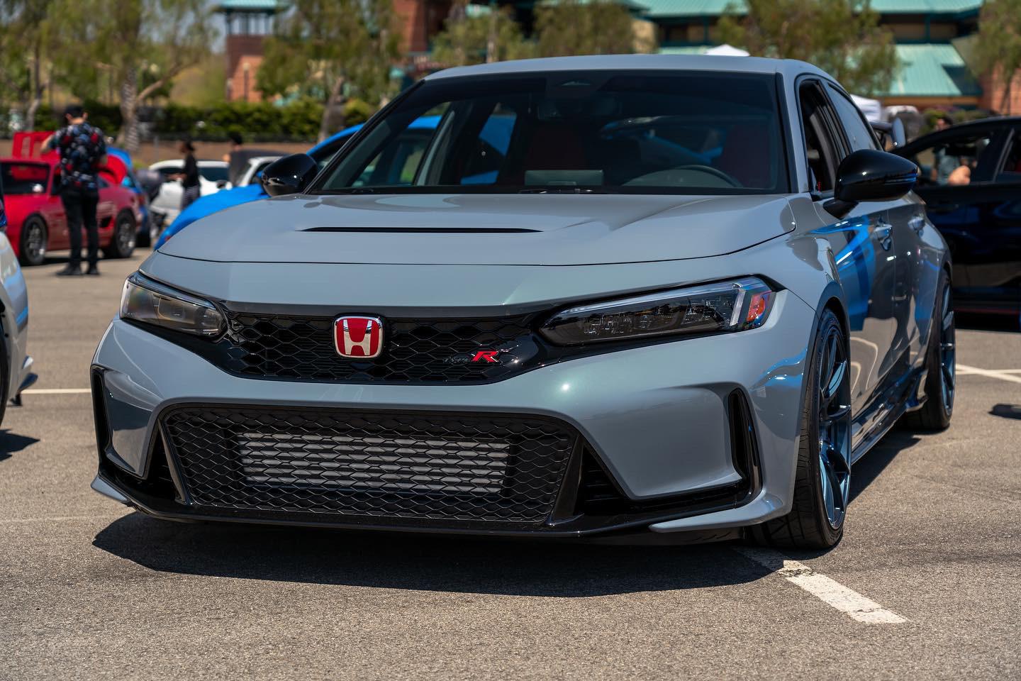

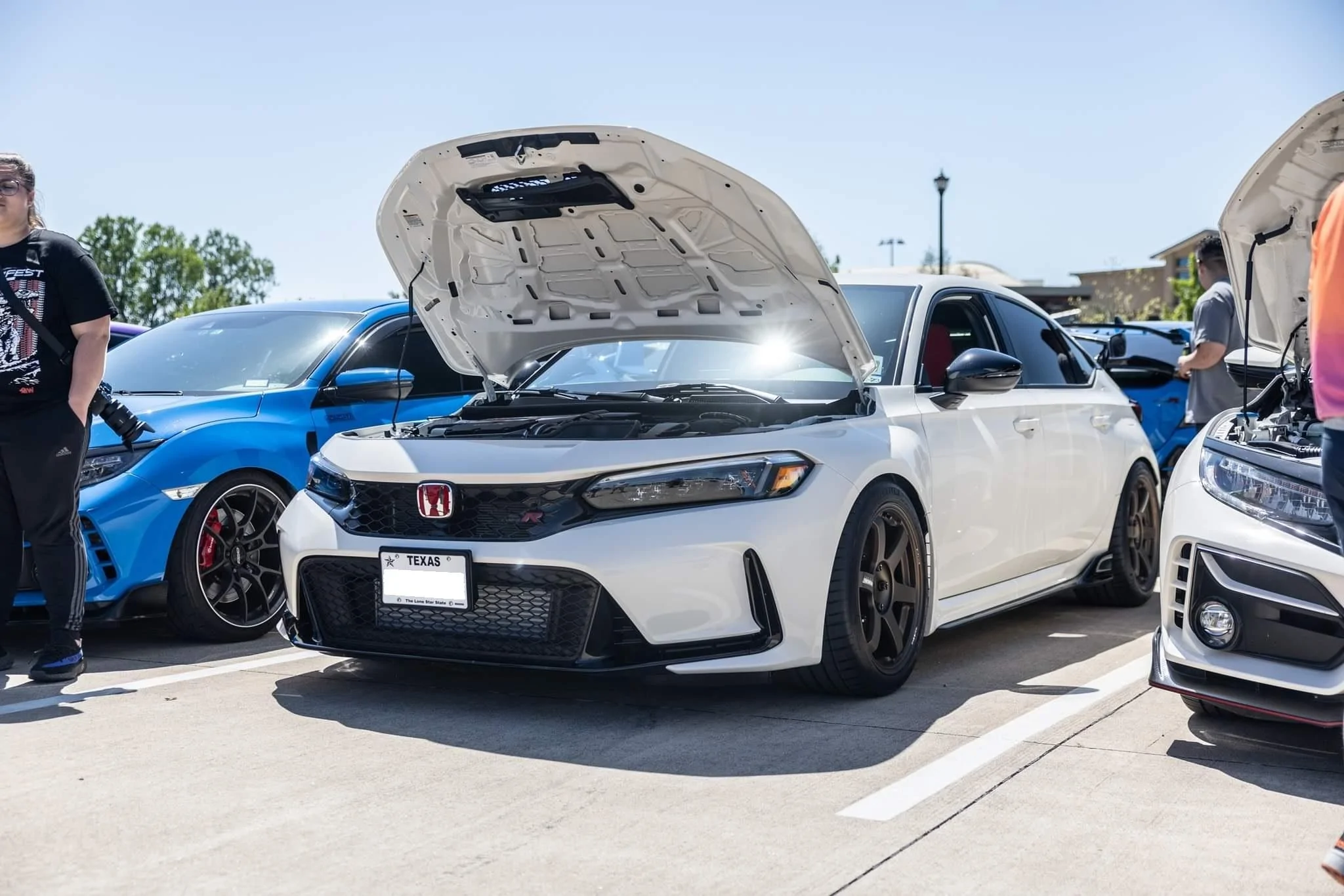

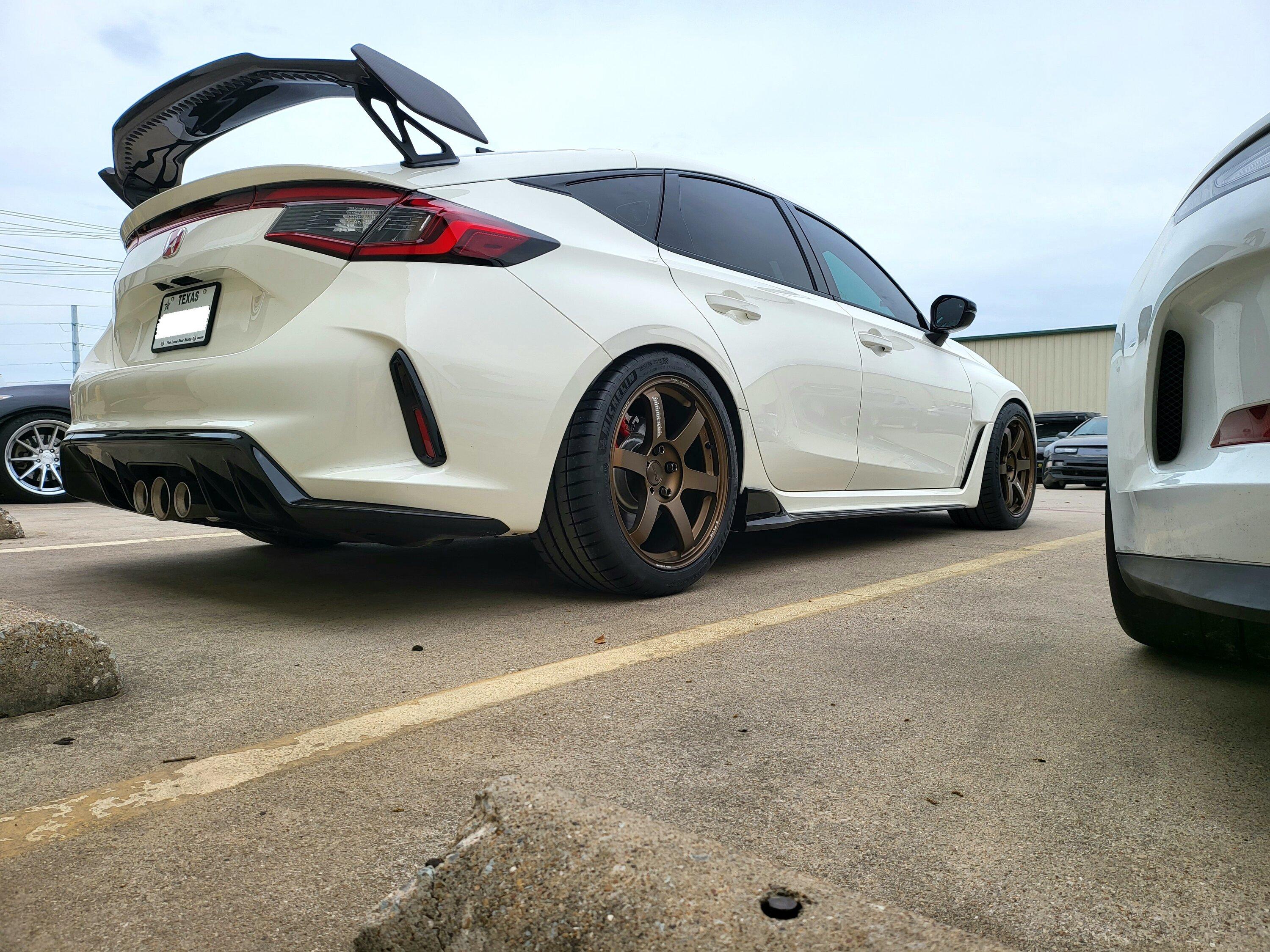

TE37 Saga S-Plus - 18x9.5 +39
Michelin PS4S - 265/35/18
Swift sport springs - 25 mm
Camber - 1.7 front and 2.2 rear
No rubbing

Is that natural camber you've gained as a result of lowering or have you got camber arms/pins removed?

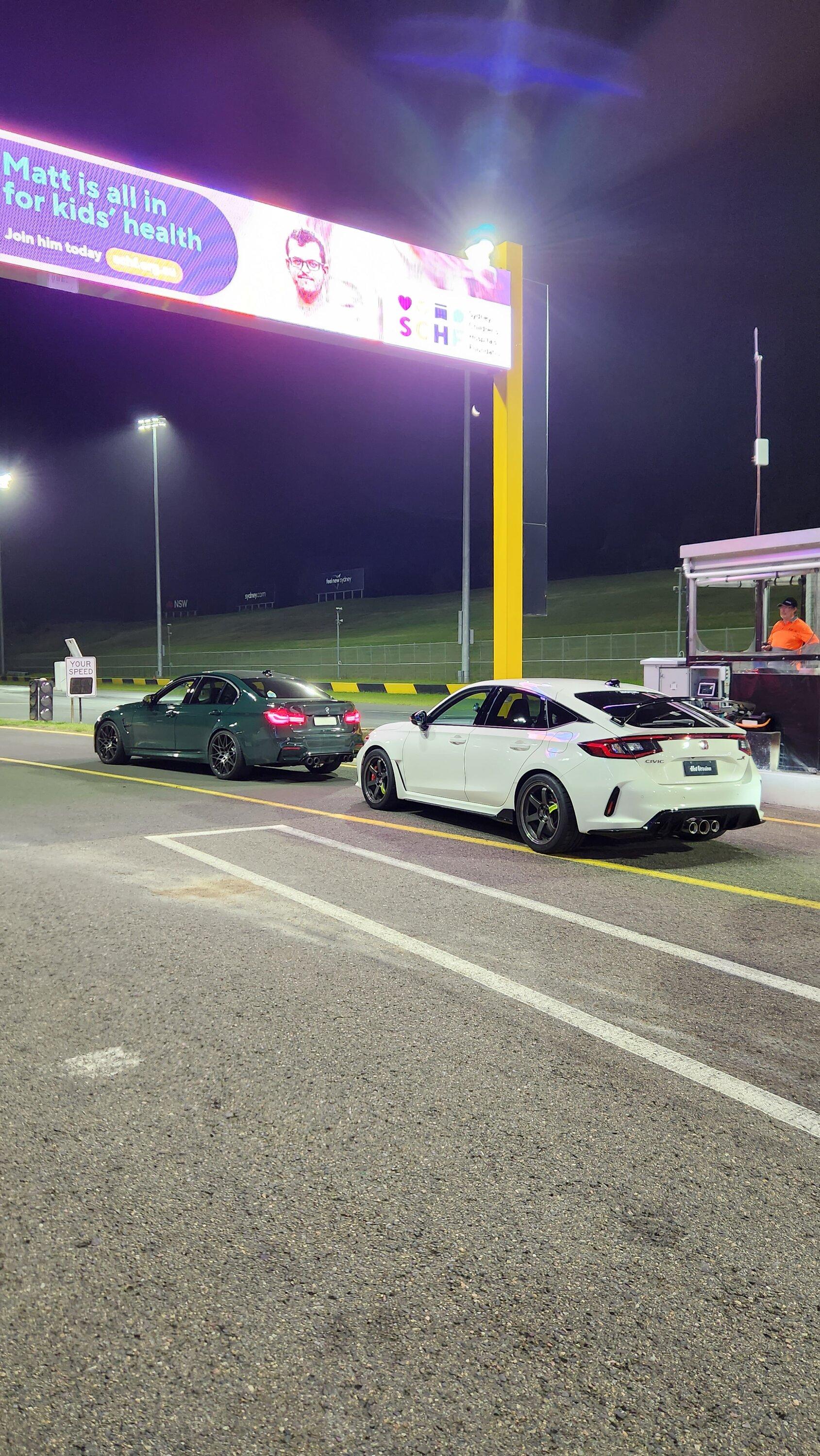

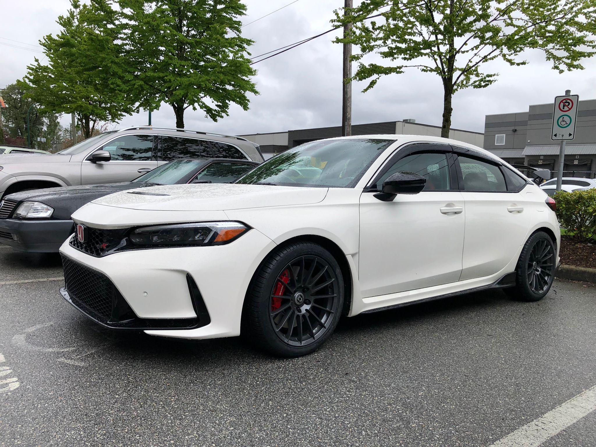

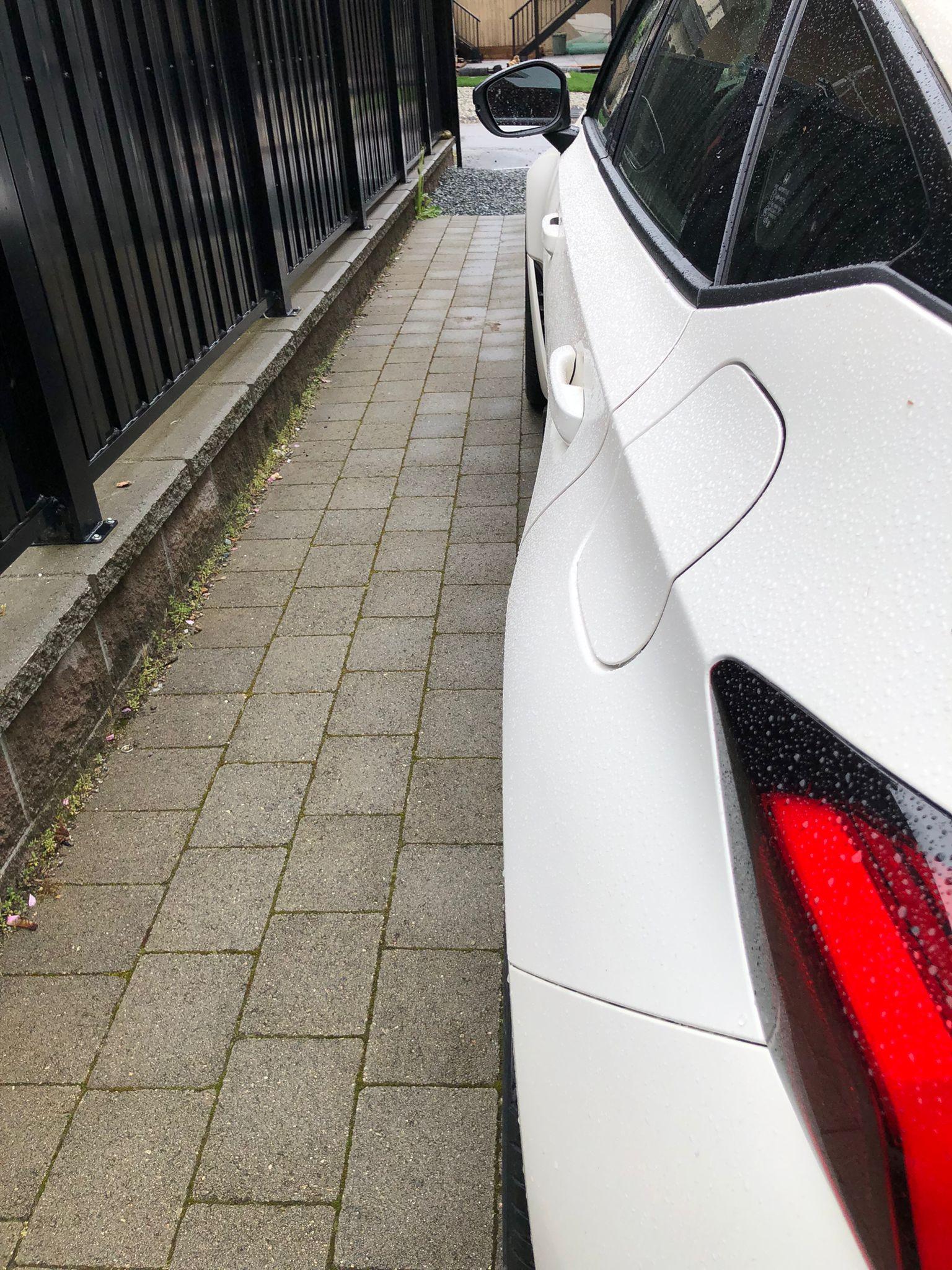

TE37SL 18x9.5 ET45
No spacers
RE71RS 275/35R18
Stock height (waiting for springs)
Camber
Fr -1.8°
Rr -1.5°
Factory suspension arms just with front strut pins removed and maxed out
Zero Rub

No camber arms, just removed the pins. Front was 1.2 (left) and 1.6 (right) before removing pins and alignment; rear was 2.2, so no change in the back.

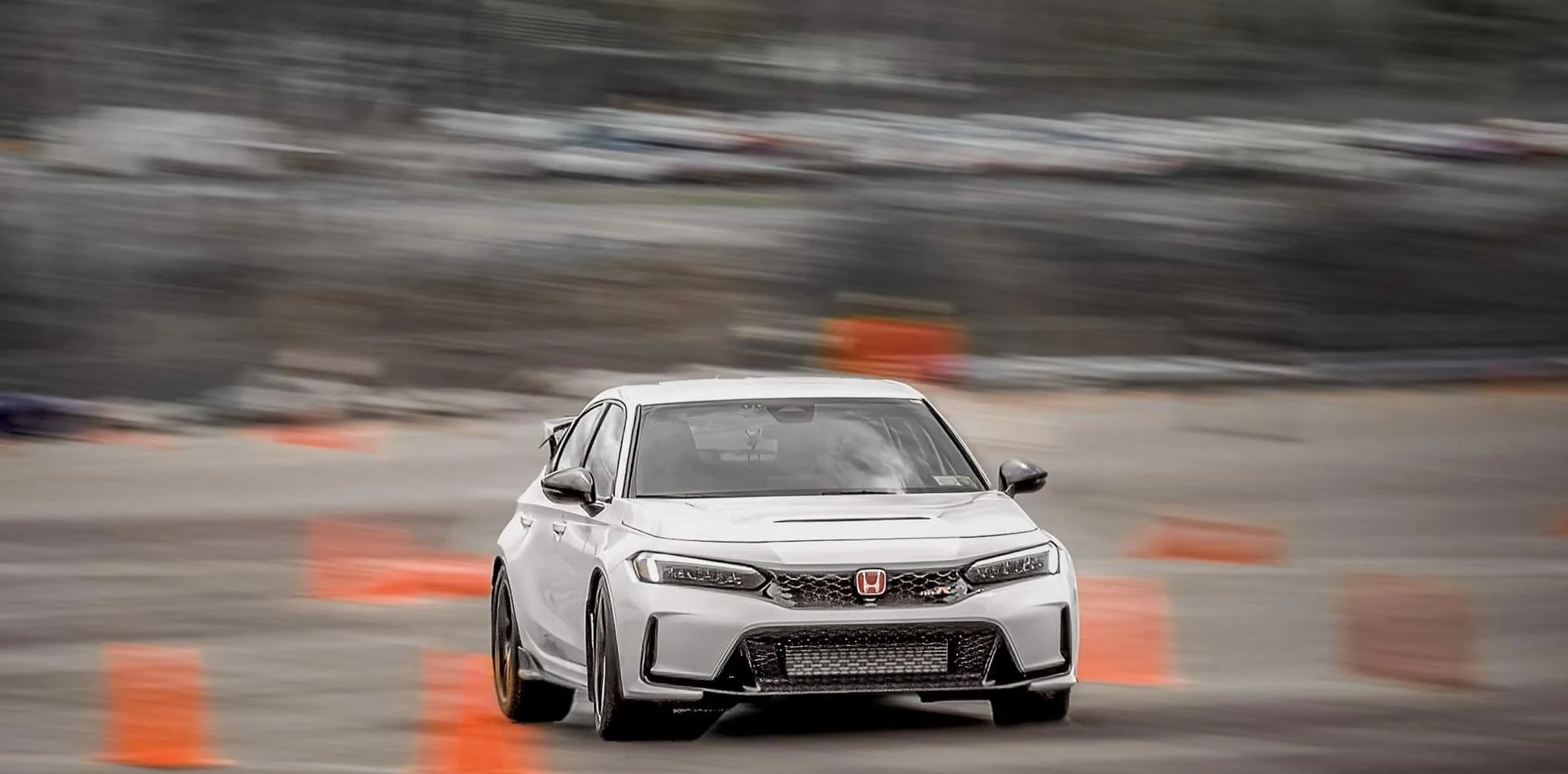

Oem Forged
Bridgestone Potenza RE71RS 275/35/19
Stock suspension with front pins pulled 1.9 degree front camber
No rubbing

I like. How do you like this compared to stock setup? Is the extra sidewall and lighter rims noticeable?

The ride is definitely cushier with the extra sidewall. I only use these for autox so don't have a ton of other info beyond tons of grip with the re71rs. The re71rs in this size weighs significantly more than oem ps4s. I did weigh both setups on my bathroom scale oem/ps4s was 52.2 lbs and the forged/re71rs was 51.2 lbs.
