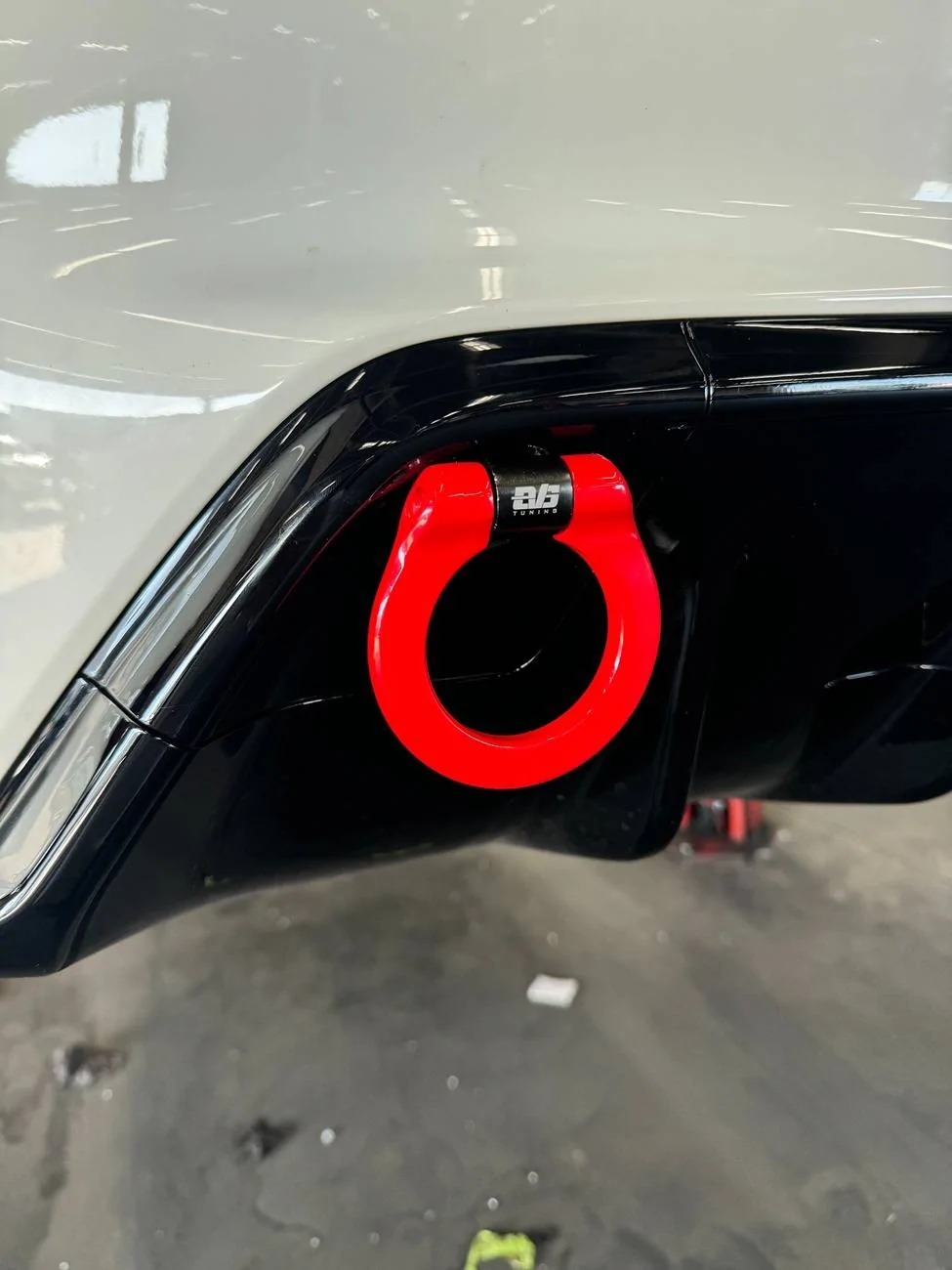

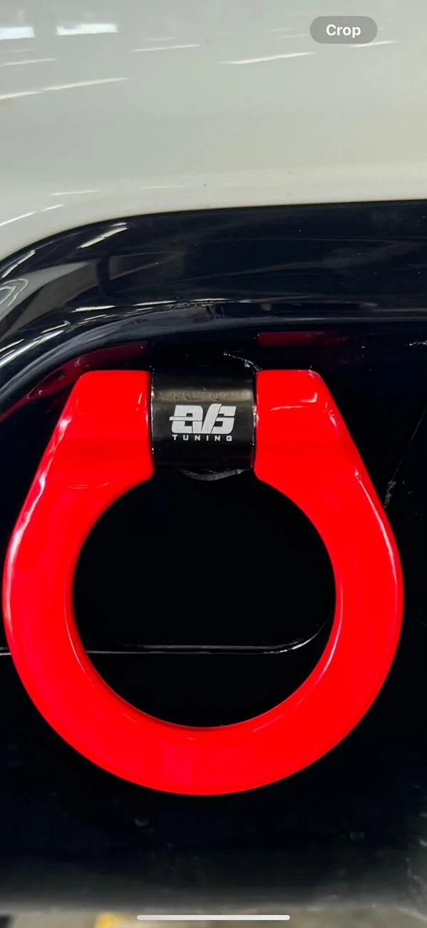

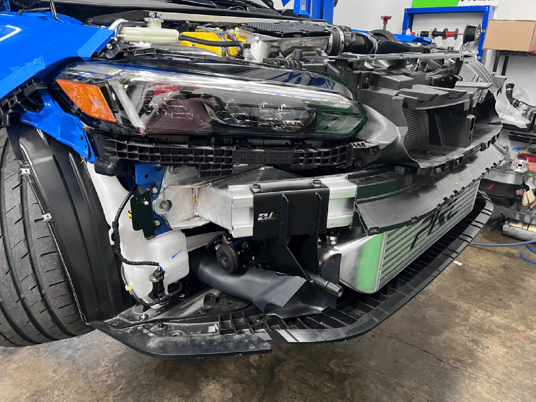

So I purchased the EVS tow hooks from Evasive and while it is true you do not have to drill holes into the bumper ?? you do have to cut a piece of the plastic bumper bar behind the bumper and trim the brake duct in order to fit the front bumper tow hook. Oh, and remove the headlight in order to get the long screws in. Other than that it is a real solid tow hook capable of doing its job.

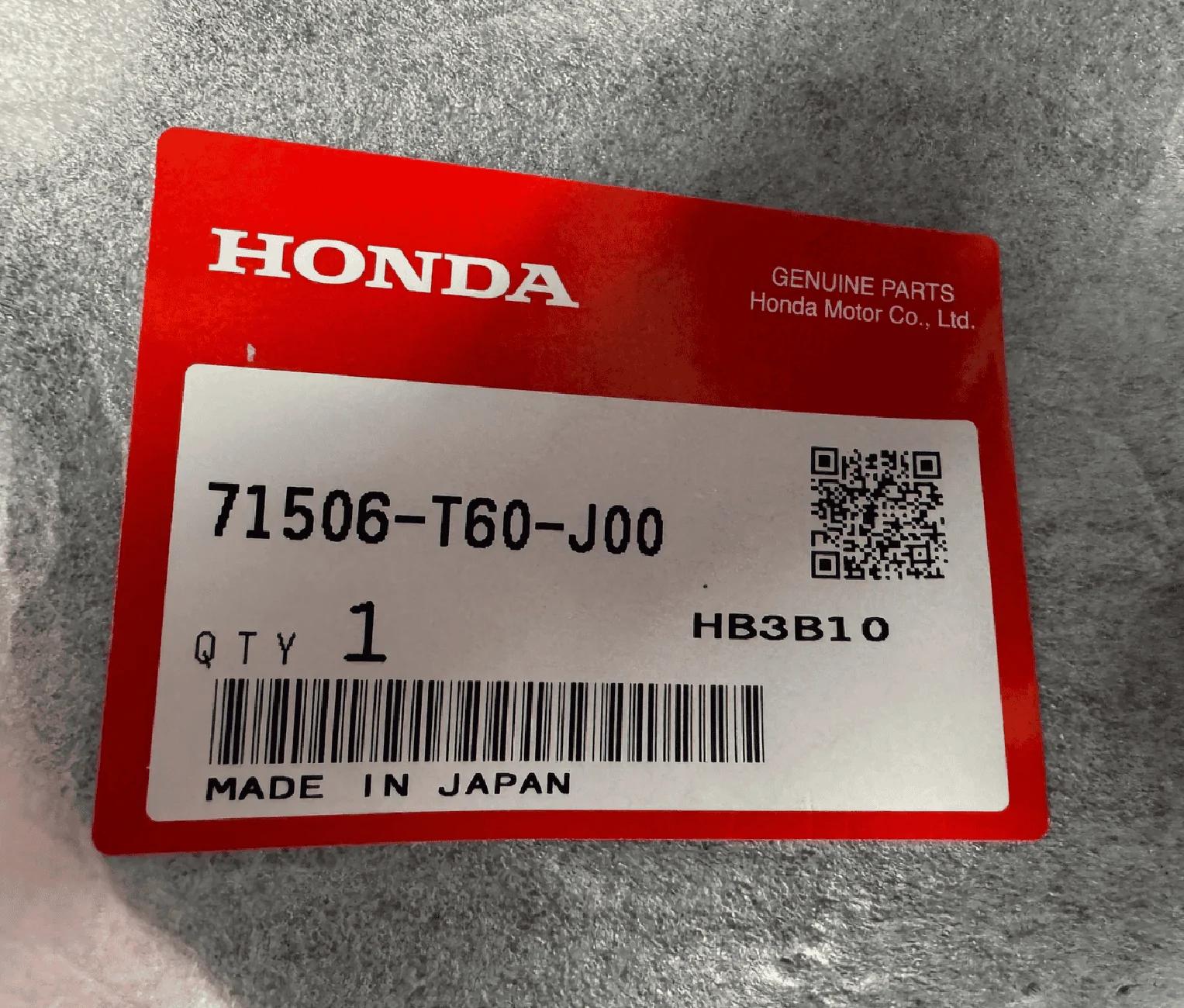

For the rear tow hook. You are supposed to just remove the rear bumper tow hook cap and screw in the tow hook but in my opinion it is a pretty big piece and it looks like crap leaving all of that space uncovered. So I went ahead and purchased that plastic piece(picture of the part number below), measured and drilled the hole. You can always cut yours without buying one but it was cheap($20) and you can always unscrew the tow hook and put the cover back.
End result, they look really nice and are the real deal.
@TW00Si here is the part number for the cover

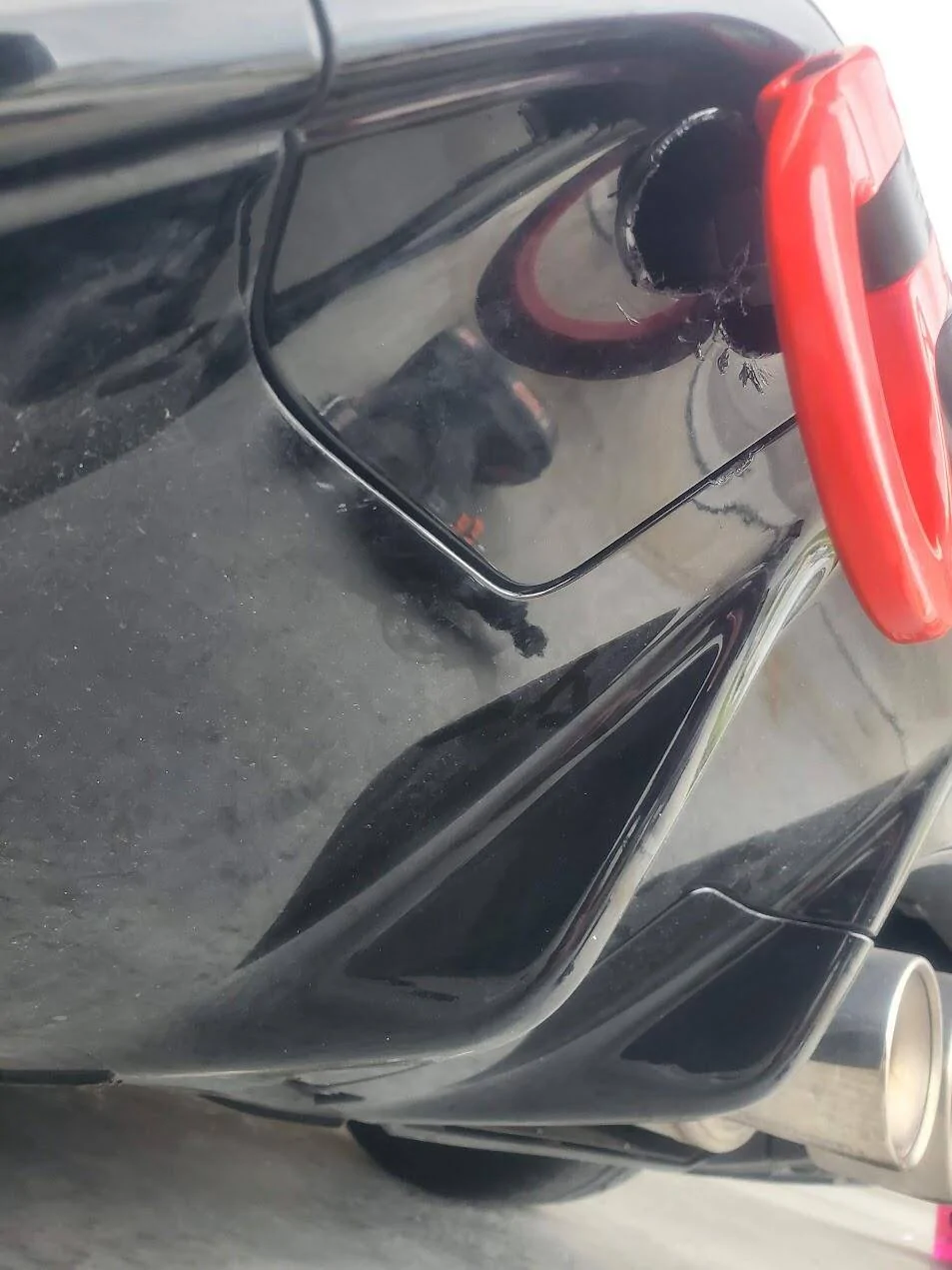

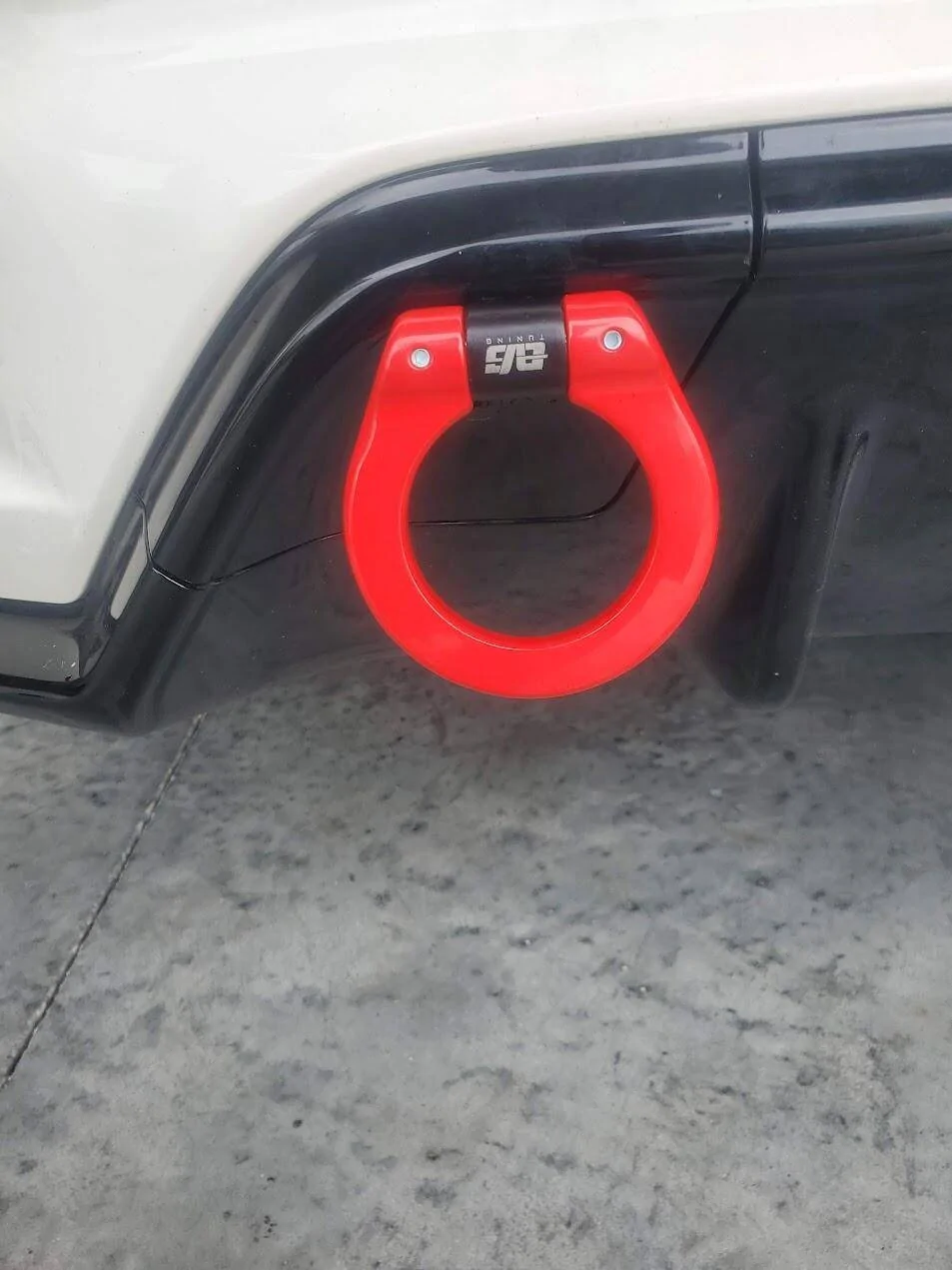

I also went went and drilled a perfect hole for the hook.. looks a lot better then that whole trim piece missing​

and the hook is threaded all the way in?

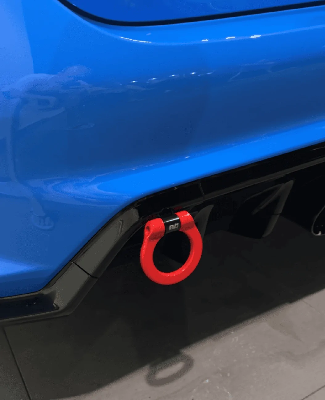

You are a better artist than me ? messed up the first hole, not noticeable unless you get close and look ?
