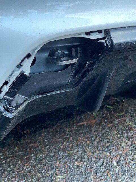

I have the rear tow hook and there are fitment issues. The hook does not screw all the way in and there is binding between the sheet metal and the side of the shaft. This is not super obvious so I'm not surprised nobody has mentioned it yet. It might also just be specific to my car.
The rear tow hook is a copy paste of the FK8 and the design seems pretty lazy (it is literally the same part number). They definitely should have extended it out further beyond the plastic cover and the shaft should be smaller so it doesn't bind.
I ended up modifying the rear hook to adapt a Sparco tow strap to it. It's not done yet since I had to order a bolt and a new tow hook cover to hack up but you get the idea. You can see how close the shaft is to interfering with the sheet metal hole and this is after I ground down the OD by a few mm.

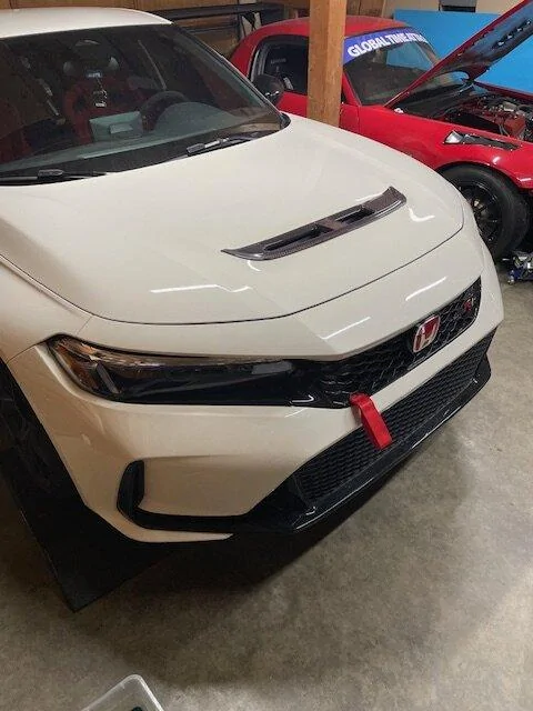

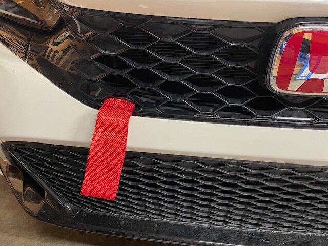

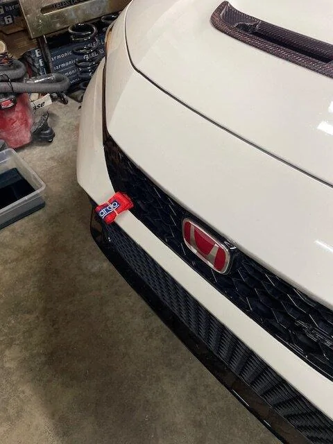

I also purchased the front EVS tow hook but decided not to install it since I was able to mount a Sparco tow strap to the front bumper beam with less cutting involved. I didn't snag any images of what it looks like underneath unfortunately. I can do that the next time the bumper comes off if folks are interested.

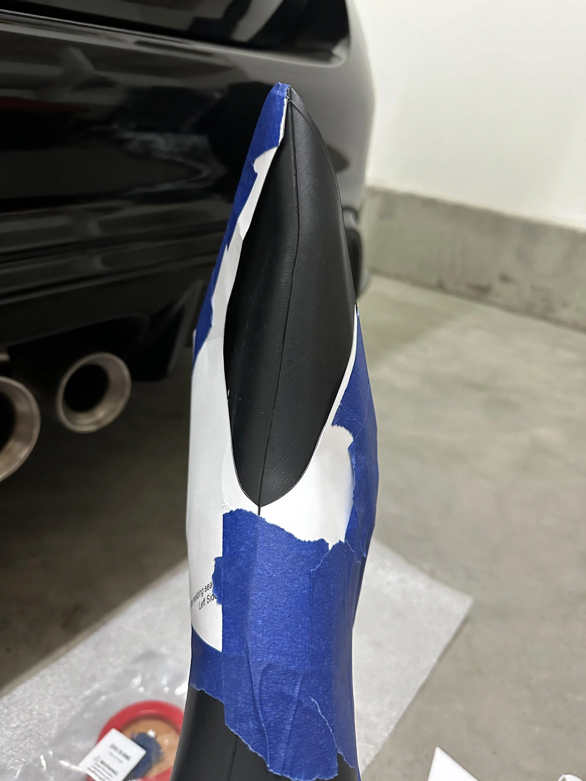

It didn’t seem like there were any fitment issues. If anyone needs to know how the cutting template lines up:
Before:
11th Gen Honda Civic EVS Tow Hooks Review photo feb 24 2024, 4 02 04 am

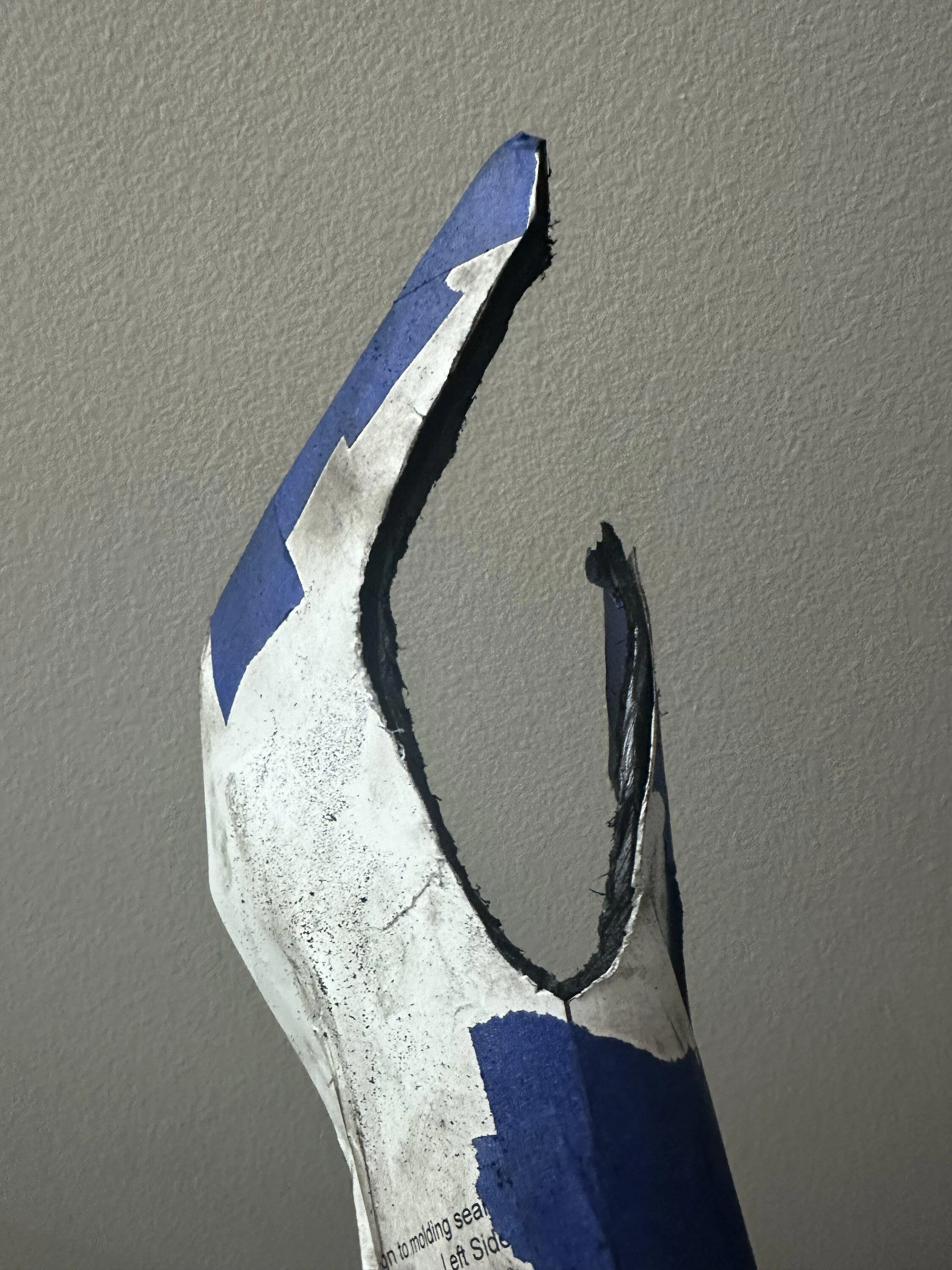

After:
11th Gen Honda Civic EVS Tow Hooks Review photo feb 24 2024, 6 37 39 am

That looks nice but will it tear up the grill if you get pulled out of a bad situation with it?
