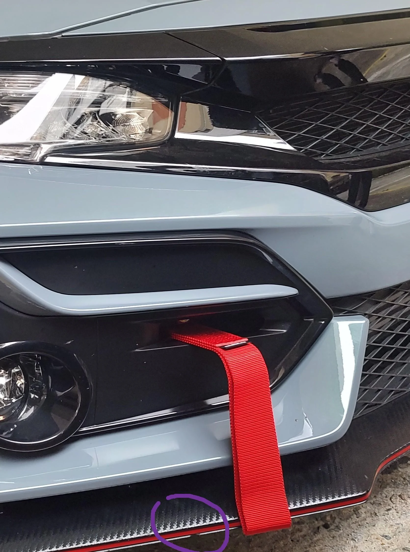

The hooks on the bottom were never meant to be used for towing. They’re tie down points used for transportation.
The car should be on a flatbed under normal usage. I’ve seen tow trucks lift by the front wheels but need to be careful the straps don’t touch the fender.

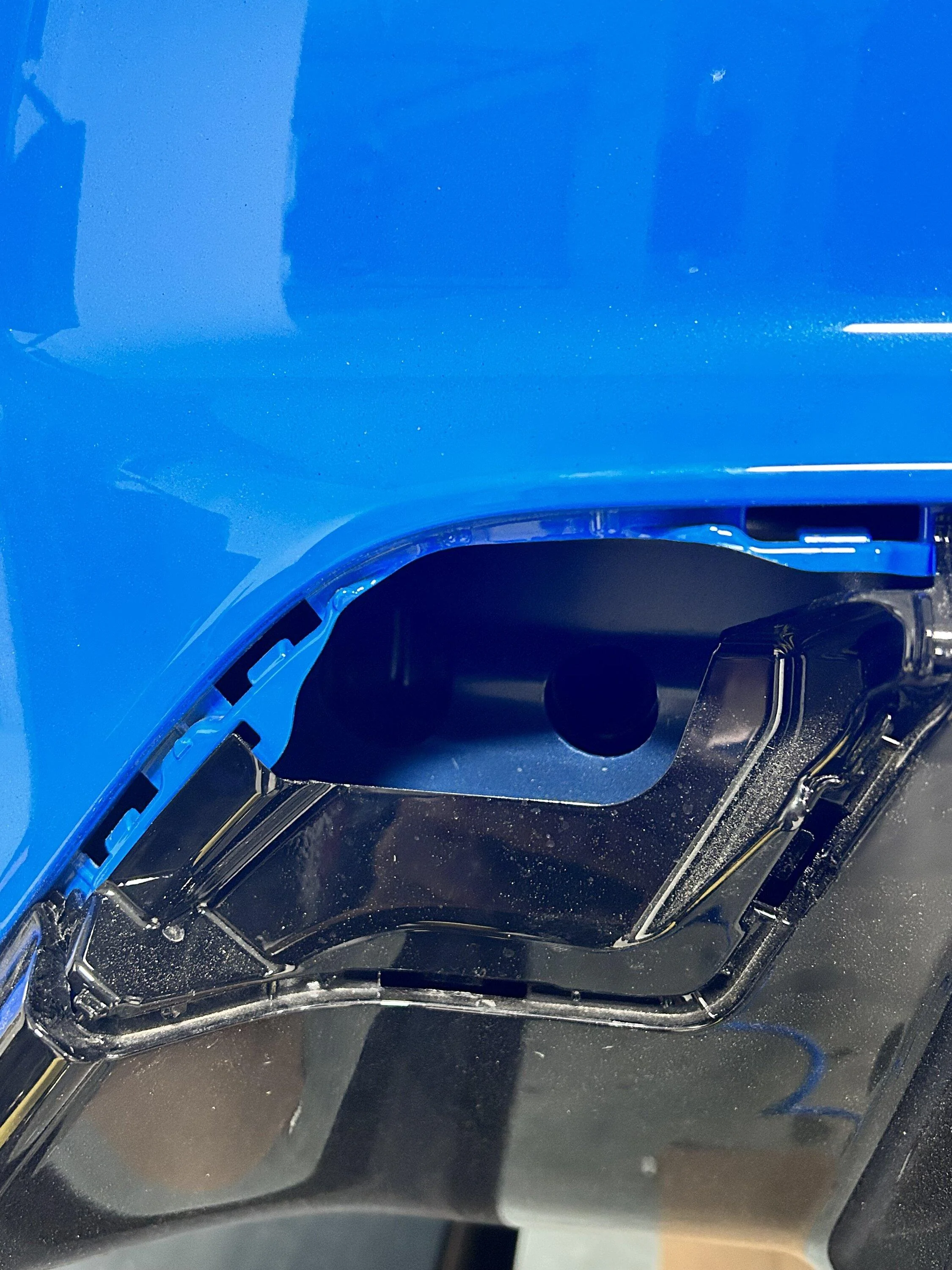

Thanks again for the heads up ayau. To really put this to bed, I pulled the honda tech service manual on this issue. The two points referred to in the pics above actually are front tow hooks, much like the rear hook. There are supposed to be other "tie down slots" on the front and rear sides with rubber plugs intended for tie down on a flat bed truck (I have not looked for them - but see attached).
The manual cautions that the front hooks and rear hook are only meant for "straight flat ground towing," not at an angle. I assume, but am not sure, that this means that the car should not be elevated or pulled through even modest turns by those hooks, except to pull the car onto a flatbed. As ayau suggested, It seems that pulling onto a flatbed is really the intended use. You could maybe pull it along on a track in a real pinch but I would not.
Again as ayau said, it appear that you should use a flatbed if possible, or front wheel lift if not (be sure to release parking brake). If at all possible, I would avoid using the front tow "hooks" because front end damage is almost certain and I'm not sure how you could really get a pull along hook real secure in there on track.
The owner's manual encourages flat bed use.

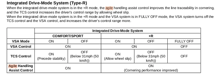

The FK8 service manual has a nice explanation on how the VSA works. I suppose it shouldn't be that different for the FL5. The only thing the pedal dance does beyond the "VSA fully off" (5 sec hold in R+) is disable the agile handling assist, which IMO is nice to have. The short press (VSA OFF) only disables the TCS at low speed.

Also anyone ever see a similar VSA table for the FL5?

Hey! I own a FK8 so not everything I say might be true for the FL5. You can "disable" the VSA in any mode by entering the VSA maintenance mode (we call it the pedal dance). It's not a full disable like pulling a fuse because the ABS fortunately still works. The problem is the pedal dance was not made for driving (thus the awkward procedure) so in practice we lose 2 things: agile handling assist and the +R suspension.
So if you are tracking in comfort or sport suspension mode, the pedal dance makes sense. The FL5 seems to have less static stability than the FK8, so you can probably play with your tire pressures and have great rotation even without the agile handling assist.
