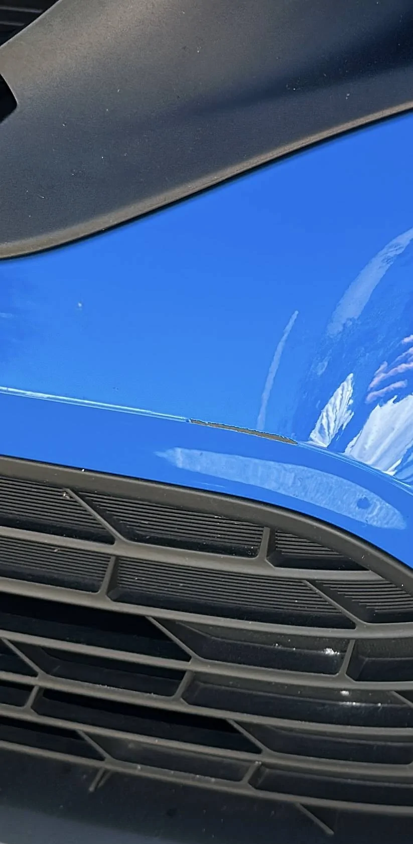

Anyone know how to fix this scratch? Will a touch up pen work on this? Thanks.

Looks like diy touch up or good body shop! Sorry

Do you suspect it was like they before pickup?
Also can you elaborate where this is? Kind of hard to tell from the pics

This one needs premier first to fill up the space its too deep for a scratch try fill up as much as possible sand it with 3k or 5k sandpaper and apply touch up pen.

I’d take it to a body shop. They’ll be able to clean it up, fill it, and polish it to where you’d not notice it unless looking REALLY closely for it. Shouldn’t cost much either.
