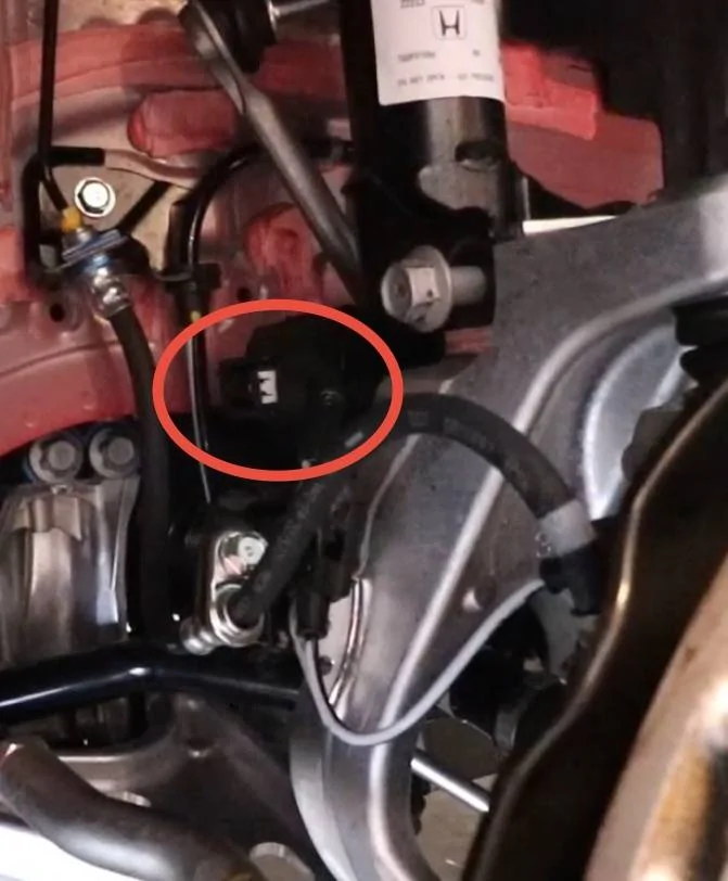

During the install of my springs, the only thing electrical I touched was in the front wheels. It is the ADS connectors, which needed to be disconnected (circled in red) as they get in the way of removing the strut from the spindle. As you said, the ADS module isn’t even close to being messed with as it’s in the cabin behind the rear seats.
Remove your front wheels and double check the ADS connection and/or wires for any damage as this might be why you’re getting an error. Hope this helps and that you’re able to figure out the problem!
Front right wheel well shown

ABS adaptive damper harness is the name of the part. #57455-T60-A04 that is for the drivers side though.
Cost me about 300 bucks to order it from honda. It's obvious to see if unplugged however not obvious to see if damaged.
