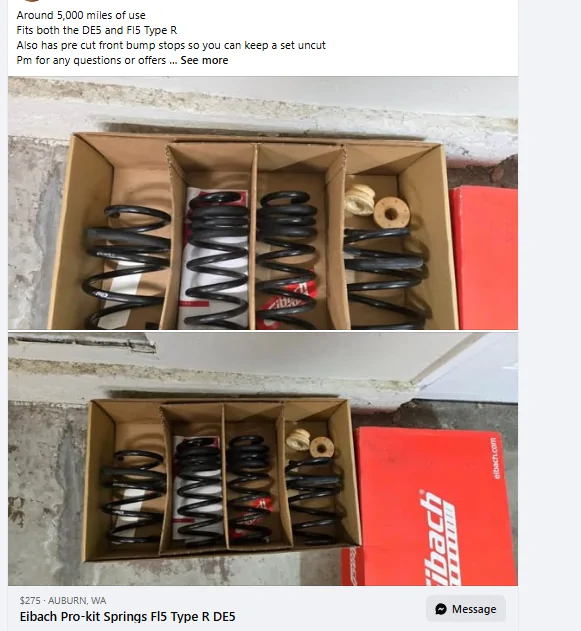

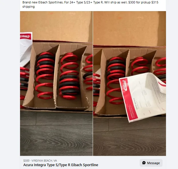

Would anyone happen to know if the FL5 and DE5 Eibach pro and sportline kits are the exact same, despite having different part #s?
E10-40-043-03-22
E10-201-006-02-22
I'm seeing a lot of them lightly used for sale on multiple FB groups saying they're interchangeable .
Hoping to get a formal confirmation from experts here before I pull trigger on a set locally that came off a DE5.

They are interchangeable from a fitment perspective.
However, while I dont have the exact published [progressive] spring rates, likely the DE5 versions are going to be smidge softer/lower rates than the FL5 version given they are supposed to match up to their specific ADS modules and ride quality.
