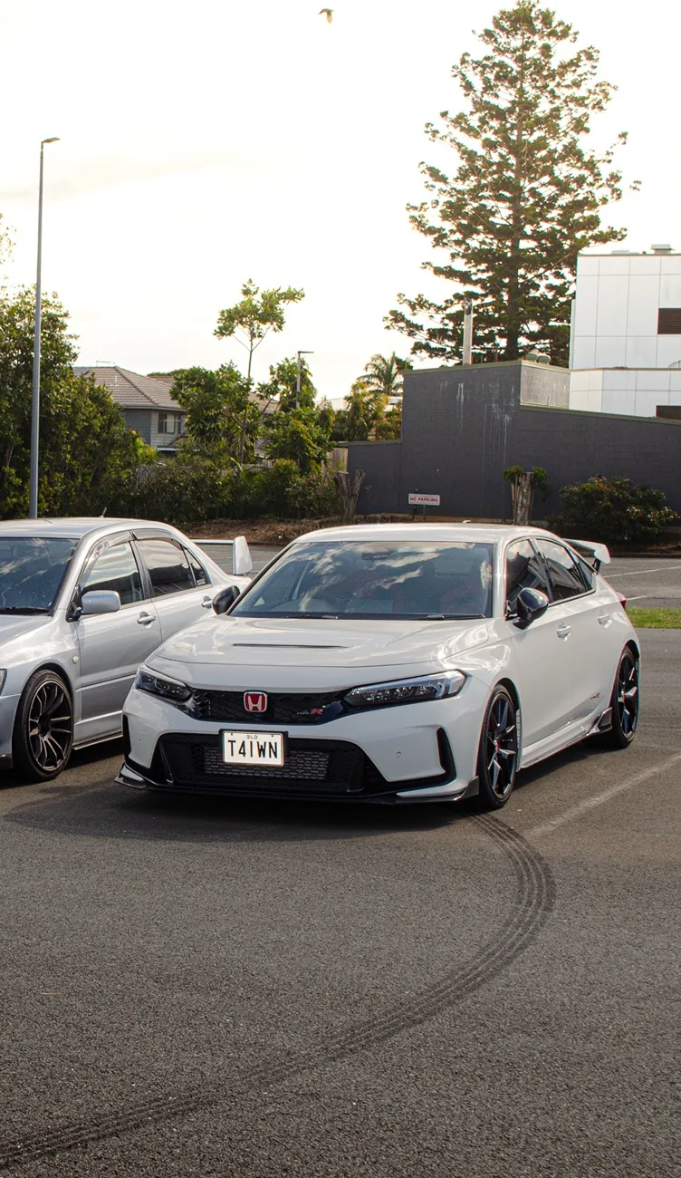

+1 for spoon.
To me they ride almost identical to stock, maybe even more comfortable but not sure if thats just my own preference. All I know is that it defintely isn't more uncomfortable. It doesn't drop as low as the others though, but if you daily drive your type R, then I think its better since it just gives it a slightly more aggresive look.
Also the new spoon springs fixed that raked look so you dont get that if you buy spoon springs now.
