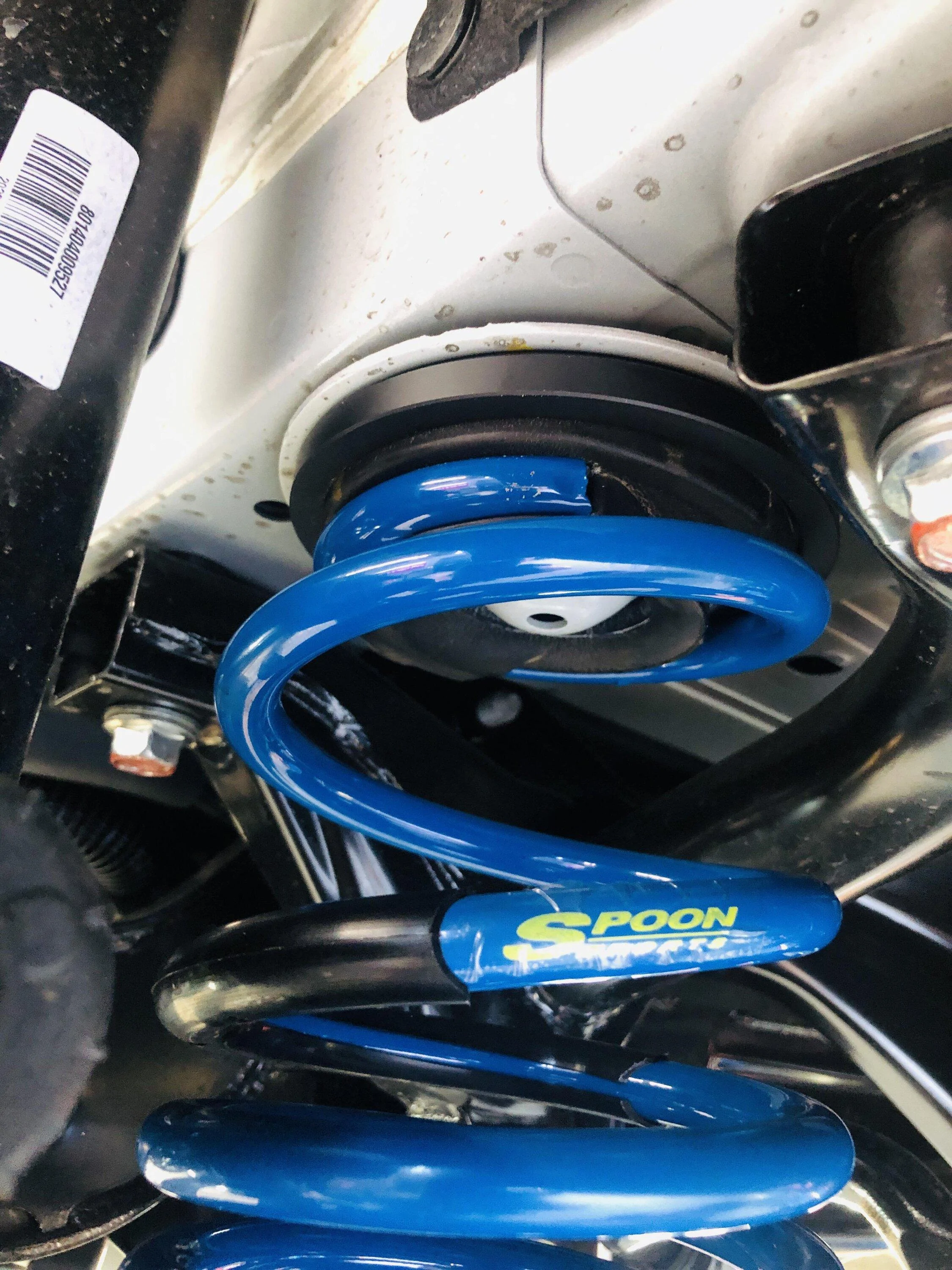

I've been running the Spoon springs (FL5 Specific Set) for about a month now - been on the track once. They feel great, ride is definitely stiffer, and body movements are better controlled.

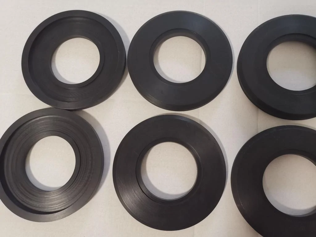

However, they are not perfect. Firstly, the fronts are noisy on sharp drop offs (decompressions) such as when it rebounds after hitting a speed bump or sharp undulation in the road, I have been able to reduce the noise by installing an additional spring insulator (made by Tein) to the front springs however it has not eliminated this noise. Additionally, I am running a 7mm spring shim on the rear positioned between the upper spring rubber insulator and the body, to make the vehicle sit flat. Without the shim, it is heavily reversed raked.
Is the noise a common problem of the spoon springs on FL5?
have you found a fix the eliminate the noise?

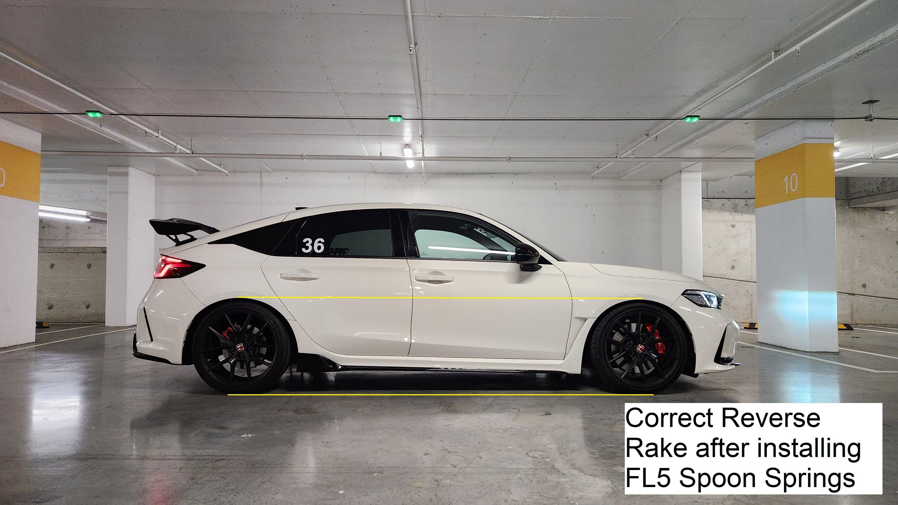

the reverse rake is the result of having an front and back even drop (20mm) and having the rear wheel well lower than the front stock.
By raising the rear it actually looks strange to me, like the car is slanted forward.
Pic of spoon vs spoon with raised rear:
11th Gen Honda Civic Spoon Springs vs Eibach? E06CA1FA-AC63-4BB8-B1CE-00377A7C0D46
11th Gen Honda Civic Spoon Springs vs Eibach? 3ED68D35-114D-423A-AFC3-D756CD9B7358
