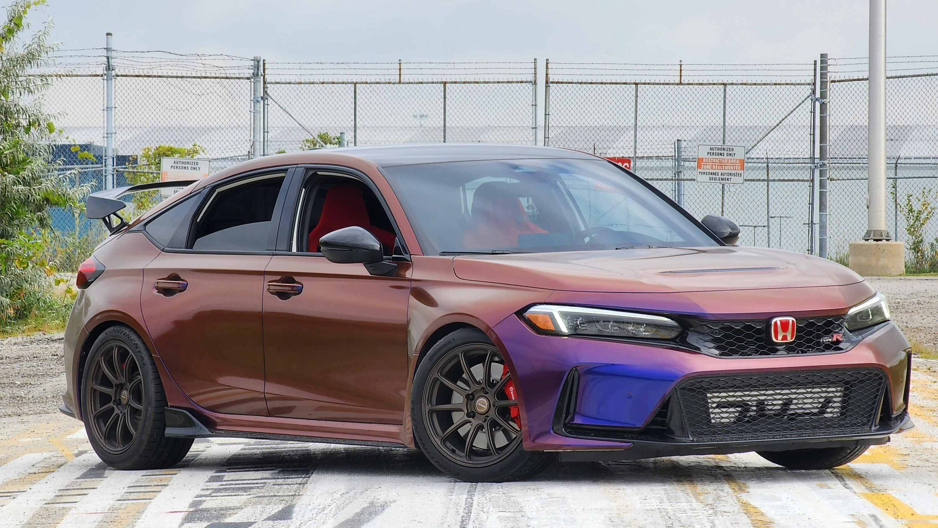

I know the reverse rake has been discussed many times, but I saw a recent video where Jomoto-san claims that's not the case. He said it only appears that way because the way the fender arch is positioned. I have no firsthand experience with the Spoon springs, but thought that was an interesting statement. Here's the video, see the 4:05 mark.
Thanks for sharing! Didn't know the measured at the jack-points and the rear arches are just much lower on the FL5. I have the Spoon Springs on our shop car as well, and noticed the "rake". Ultimately if it does bother someone then it's best they go with H&R for the more even look. Swifts will be good too
