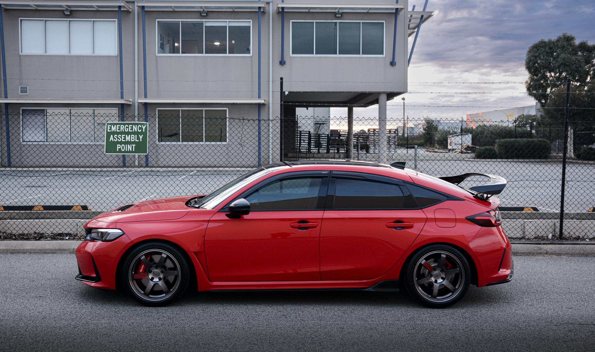

I'm always iffy about using lowering springs, some of them state its only a 1 inch drop and then it turns into 1.5. How is it since everything settled? Did it drop more or stay about the same since install?
what you see in the photos is pretty much the drop of the springs which already settled. I wish it can go just a bit more lower.

That looks sweet. My only concern is that I'm running the OEM wheels but with 265/35R19 tires, so the overall diameter is 1" larger than the OEM wheels and 265/30R19 tires. Since I got it like this from the dealer (I asked for the larger tires on delivery), not sure if it's "lowered" a bit already or not, and how springs would affect that, and if I might have to go to 18s with 265/35R18.
My diameter would be equal to a 265/40R18. I know those work with stock springs.
I think the 265/35/19 will work even its lowered as it does not drop the car that much.
Im currently running 265/35/18 on those sagas.

Spoon says it lowers it by 20mm front and rear. My ride height is now higher by 1/2" or 12.5mm, due to 1" larger diameter wheel because of the taller tires. This also means the wheel gap is 1/2" or 12.5mm lower as well. So effectively, the new drop would be 20mm + 12.5mm = 32.5mm.
If you are just going to lower the car and DON'T USE any wheel spacers, you will be fine as there is a plenty of wheel clearance on the FL5, however if you will run spacers, you might rub.

Yeah, might just have to try and see. Basically imagine your car with an additional 12.5mm or 1/2" drop.
