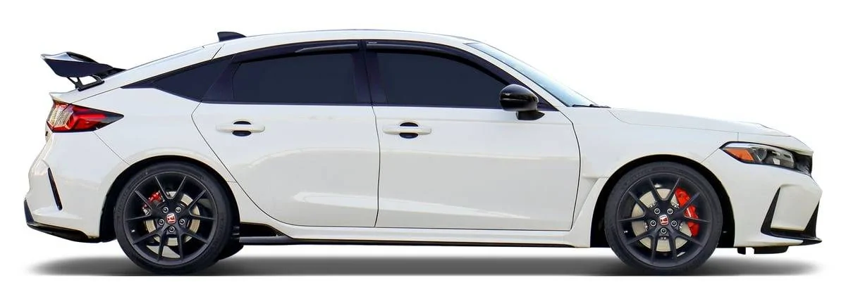

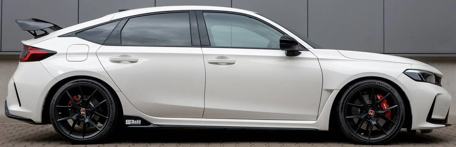

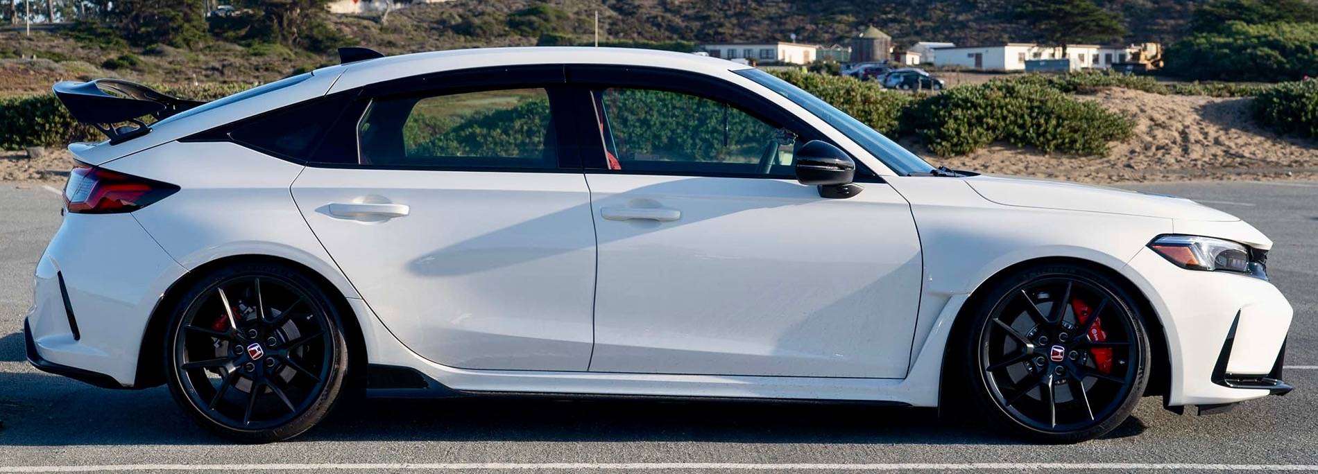

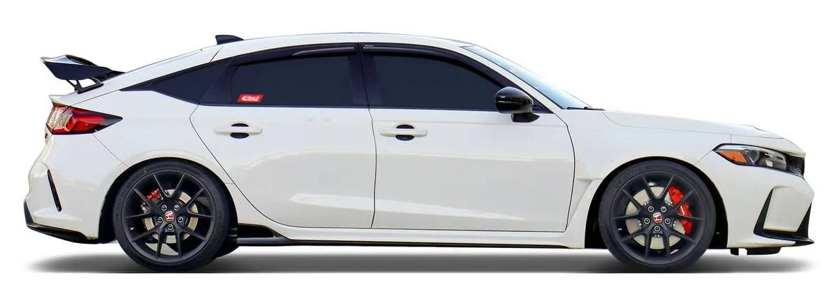

Split the difference and go with Eibach Pro-Kit. If I wasn’t planning on going with a larger diameter tire that is what I would do.
Stock:
11th Gen Honda Civic Spoon Sports Springs Installed on FL5 w/ 25mm R + 20mm F Spacers 1731390236290-0e
Pro-Kit:
11th Gen Honda Civic Spoon Sports Springs Installed on FL5 w/ 25mm R + 20mm F Spacers 1731390299958-0w
H&R (mirrored image to make compare easier):
11th Gen Honda Civic Spoon Sports Springs Installed on FL5 w/ 25mm R + 20mm F Spacers 1731390372180-ua
Swift:
11th Gen Honda Civic Spoon Sports Springs Installed on FL5 w/ 25mm R + 20mm F Spacers 1731391195807-u2
