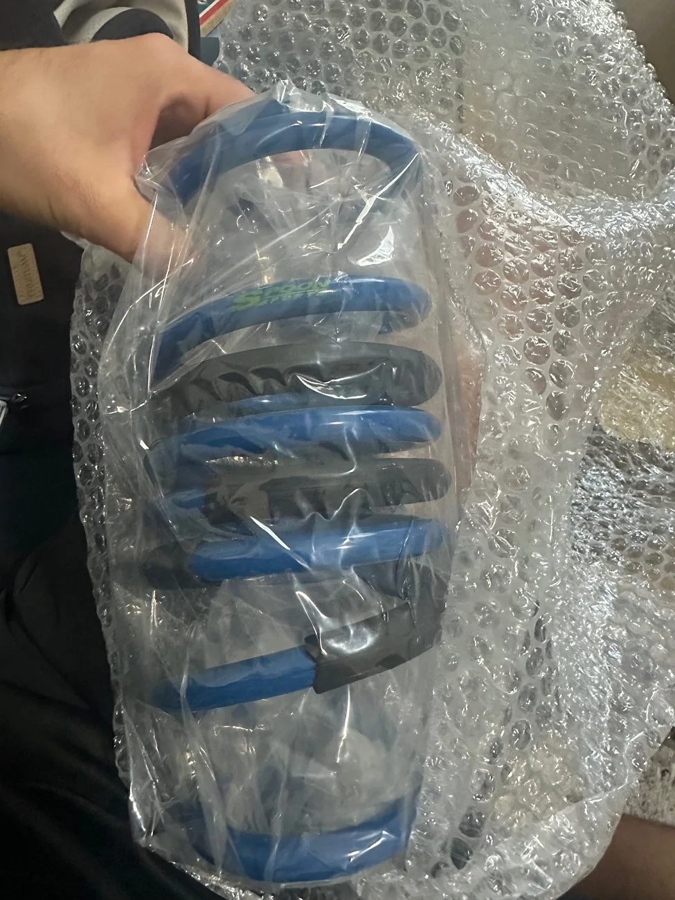

Anyone else want to chime in? Anyone track with their spoon springs yet? My set just arrived…
11th Gen Honda Civic Spoon Springs with ITS ADS Module IMG_0846
